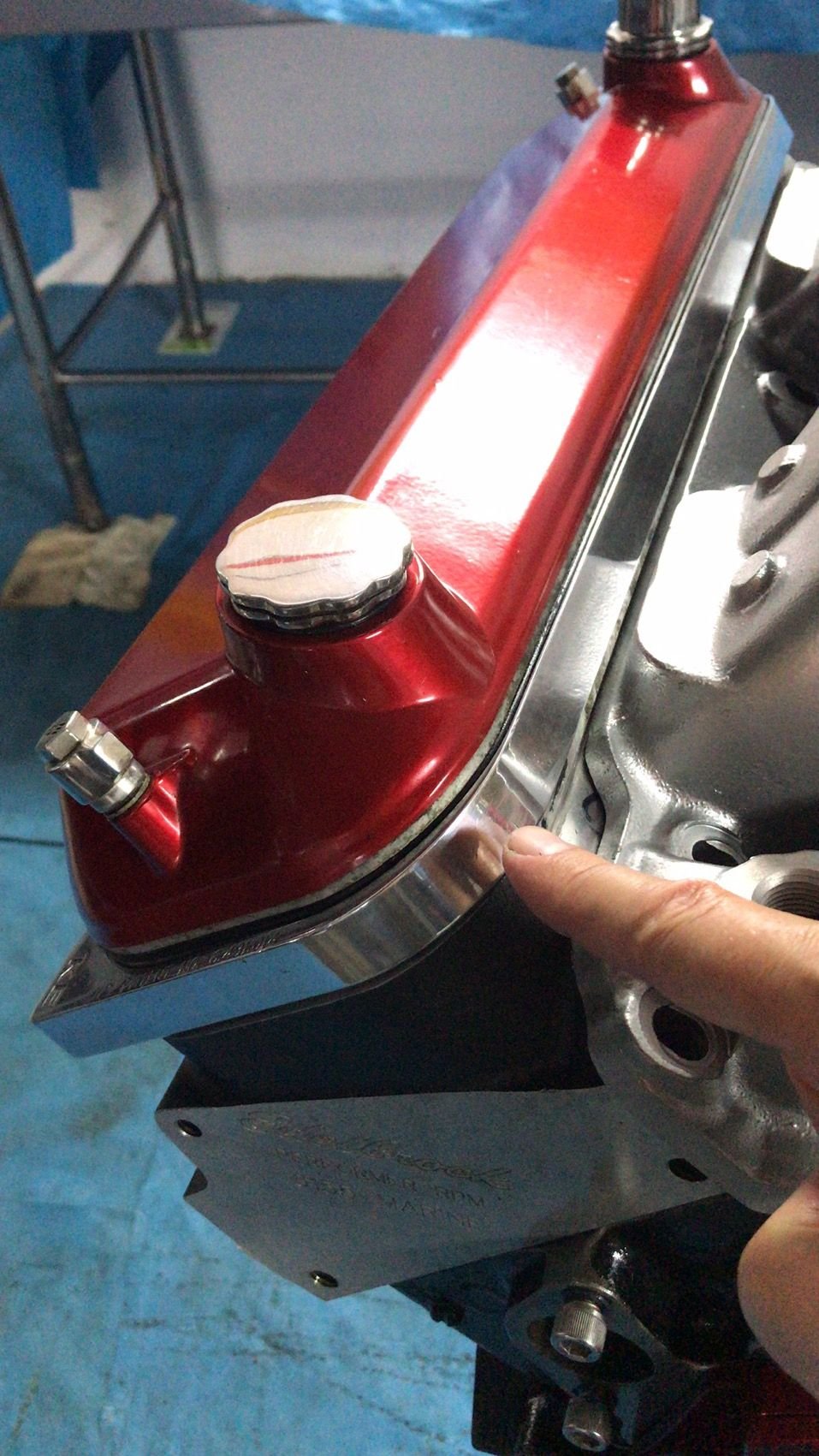

Engine assembly is almost completed, pre-oiling with a drill showed a nice oil pressure, so I tried to turn over the engine with the starter. Went all well until I discovered that cylinder #1 has zero compression, all others are fine. Well, didnīt try with a tester, just with a finger but it is obvious that one cylinder has a problem.
Valves seem to open and close the whole way, but I donīt really know how to measure it. Took off the oil pan, all nice and clean, no debris or metal flake. Couldnīt see anything wrong at the cylinder walls or the piston from below.
Any suggestions what I can do before taking the cylinder head off?
Before I noticed that I had an issue I made a short video. Itīs not really focussed on the first cylinder, but something can be seen.
https://youtu.be/eZuQHT9hiLc

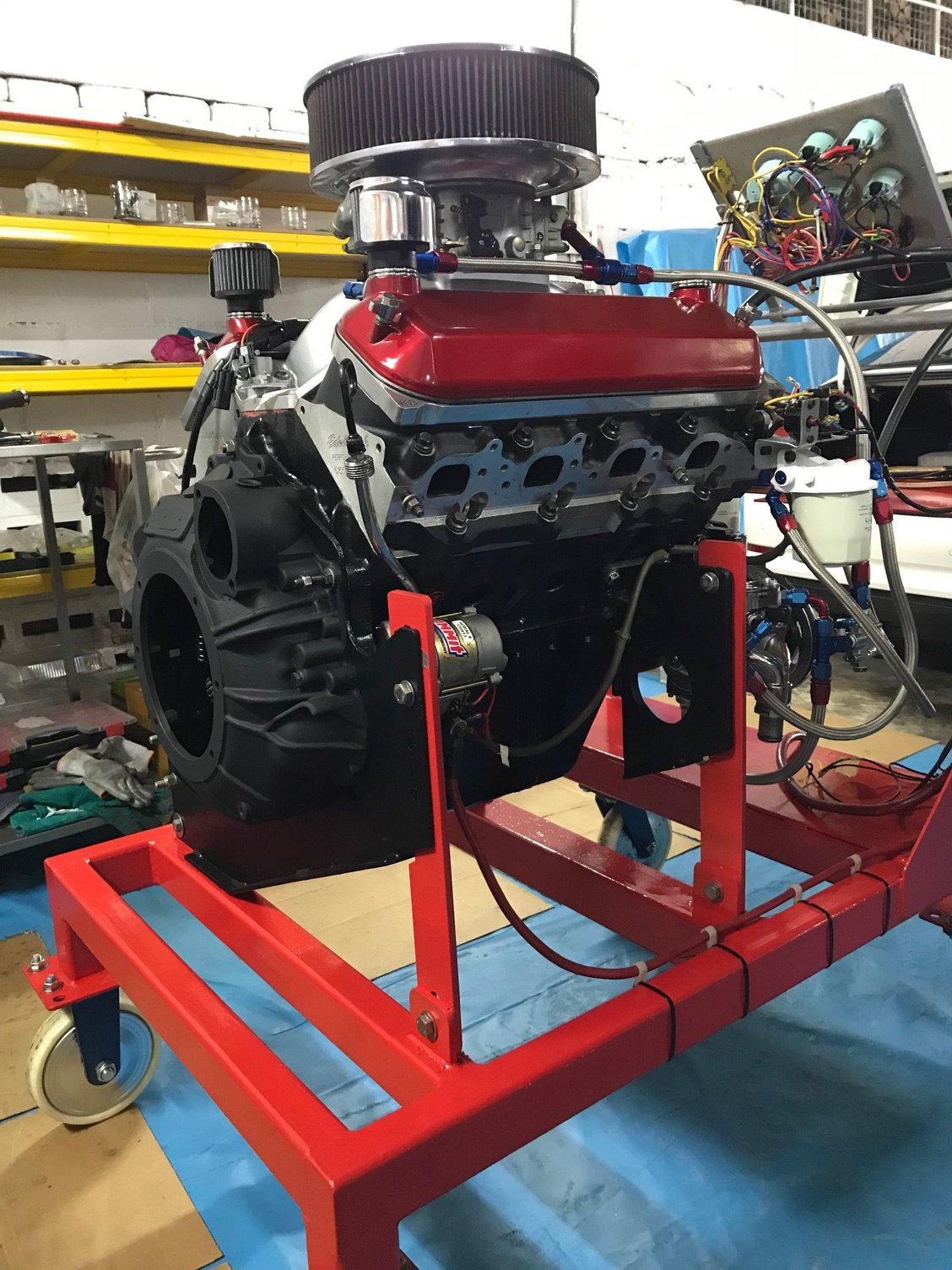

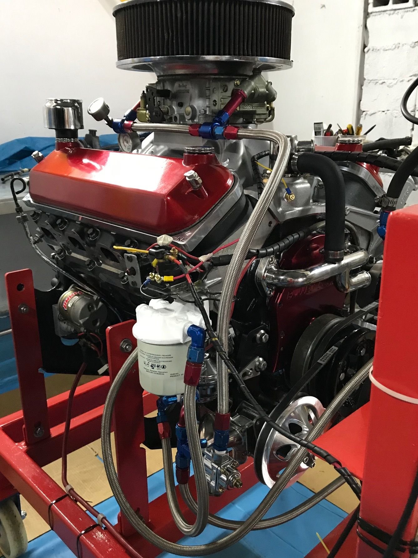

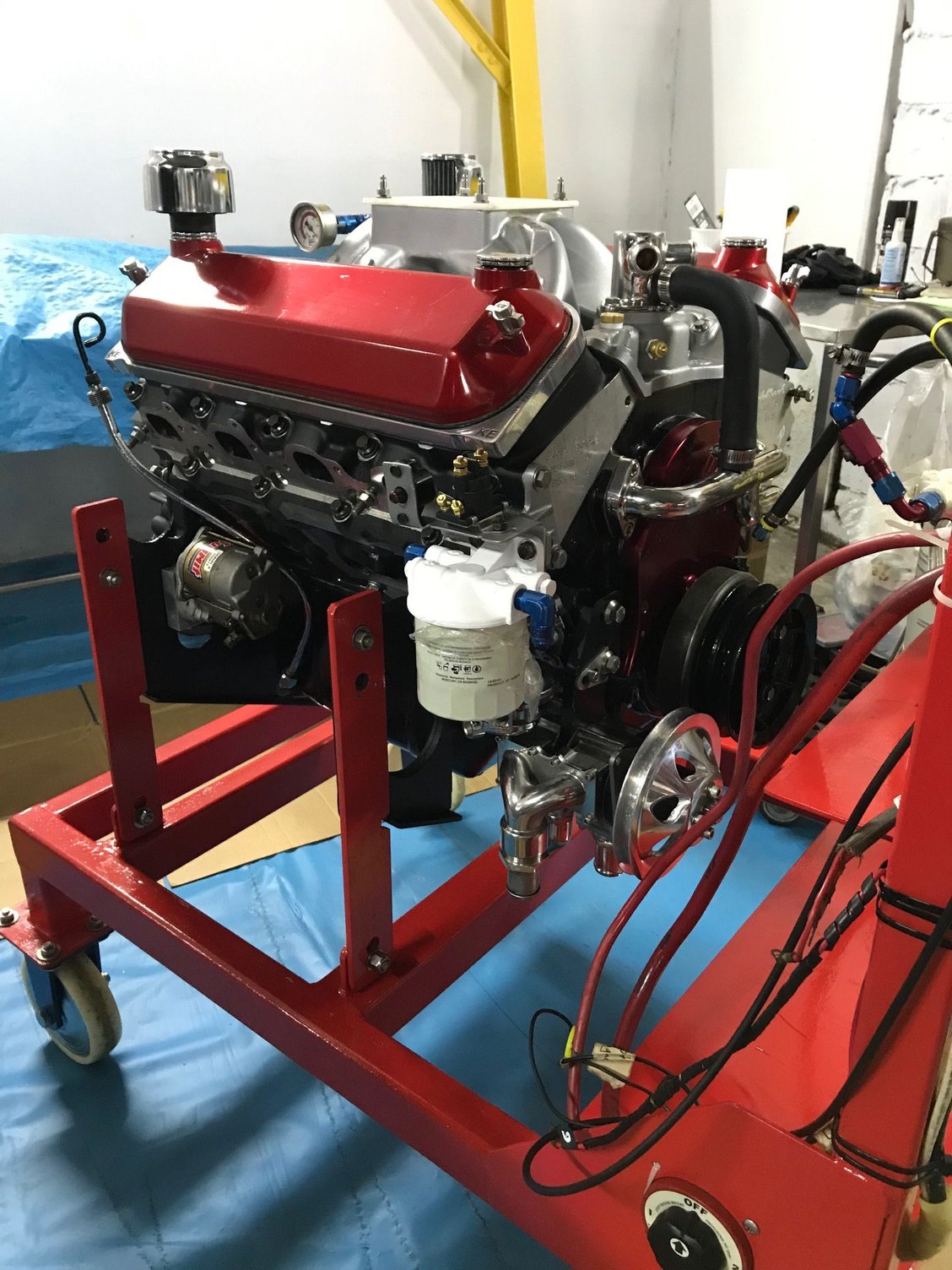

Another lockdown, another lost month, but yesterday finally I had my big day. 10 months passed since I pulled the seized engine and it was very exciting to start my first rebuilt engine.
Adjusted the valves again and got a quite high compression around 170 on all cylinders except #7 which is at 145 psi. Good enough for now. Checked all hoses, ignition and connections again, took a deep breath and hit the starter. Fired up almost immediately, idled without throttle, didnīt make any strange noises, no smoke, no vibration, no problems. That was easy. Even the timing was only slightly off so there was actually not much to do. Let it run for a while and that was it.
Now I have two running engines. Thinking about opening the other one too, take the cylinder heads off to see if everything is ok.
Or skip it and start something new? The outdrives need attention, Iīm sure they are in bad shape.
completed engine before first start
