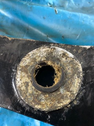

and thereīs more, found a missing bearing, no wonder the starboard drive had so much play
Gimbal roller bearing where it should be
Missing starboard gimbal bearing
Bell housing corroded beyond repair
and all the small parts like this gimbal ring bushing or anti-galling washers
Finding spare parts for TRS is still possible but I had to gather the pieces from different sources including ebay. There is a lot of NOS, but some sellers just have, letīs say a single bushing, when you need four. Took months to get everything together, consolidate it and have it shipped to Malaysia.
