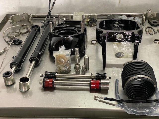

Fast forward a couple of months later, cylinders refurbished, stainless steel parts machined here, gimbal ring powder coated and new bearing installed, all small parts imported. Bought two bell housings from Tim, one was very good, the other one scrap, had to toss it. Found an aluminium repair shop which fixed one of my old housings and it´s now being powder coated.
Guess I have it all together, now I only have to assemble it.

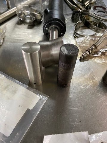

Especially in a country with cheap labor. I paid only USD90 for the SS304 swiwel shaft from the local machine shop while it´s sold in the states for USD500 (plus 30% shipping and import tax in my case).
These two are originals, looking at the corrosion damage of the used one I have my doubts if they are 304 grade stainless steel. Then again, after 34 years in saltwater everything rusts.
I posted this photo already but isn´t the shaft a piece of art? The $90 local reproduction on the right

Talking about spare parts, as mentioned before importing them is a lengthy and costly process so when I finally get them I´m excited like a little boy on christmas. I spread everything on the floor and play with it
