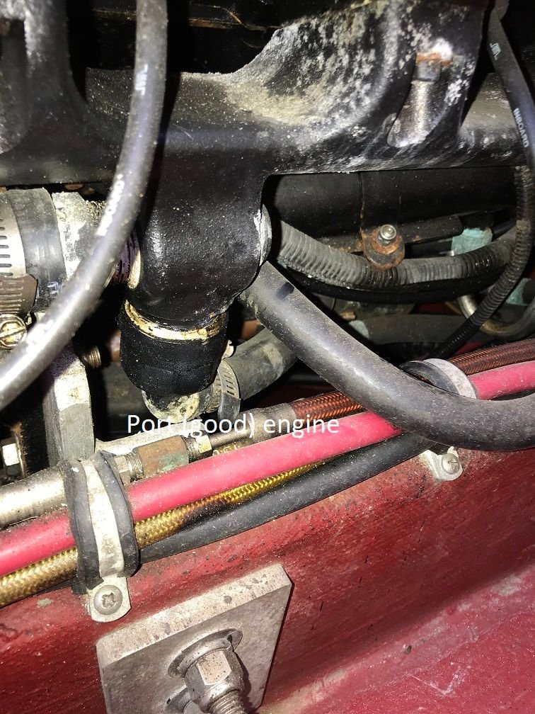

Default Exhaust manifold fitting broke off.
I removed, painted, and replaced the wheels and winch post and updated the winch. Everything was going well until I started up the starboard engine for the first time since I brought the boat back from Texas. Water spewed into the hull from a fitting hanging near the exhaust manifold. It appears that this fitting sheared off the manifold; very few threads remain on the manifold. Any advice on how to fix this is appreciated.
Port side of starboard engine exhaust manifold
Brass fitting that broke off.
View of good fitting on port side of port engine.

That's an aluminum fitting. Are there enough threads to screw on a new firing?
