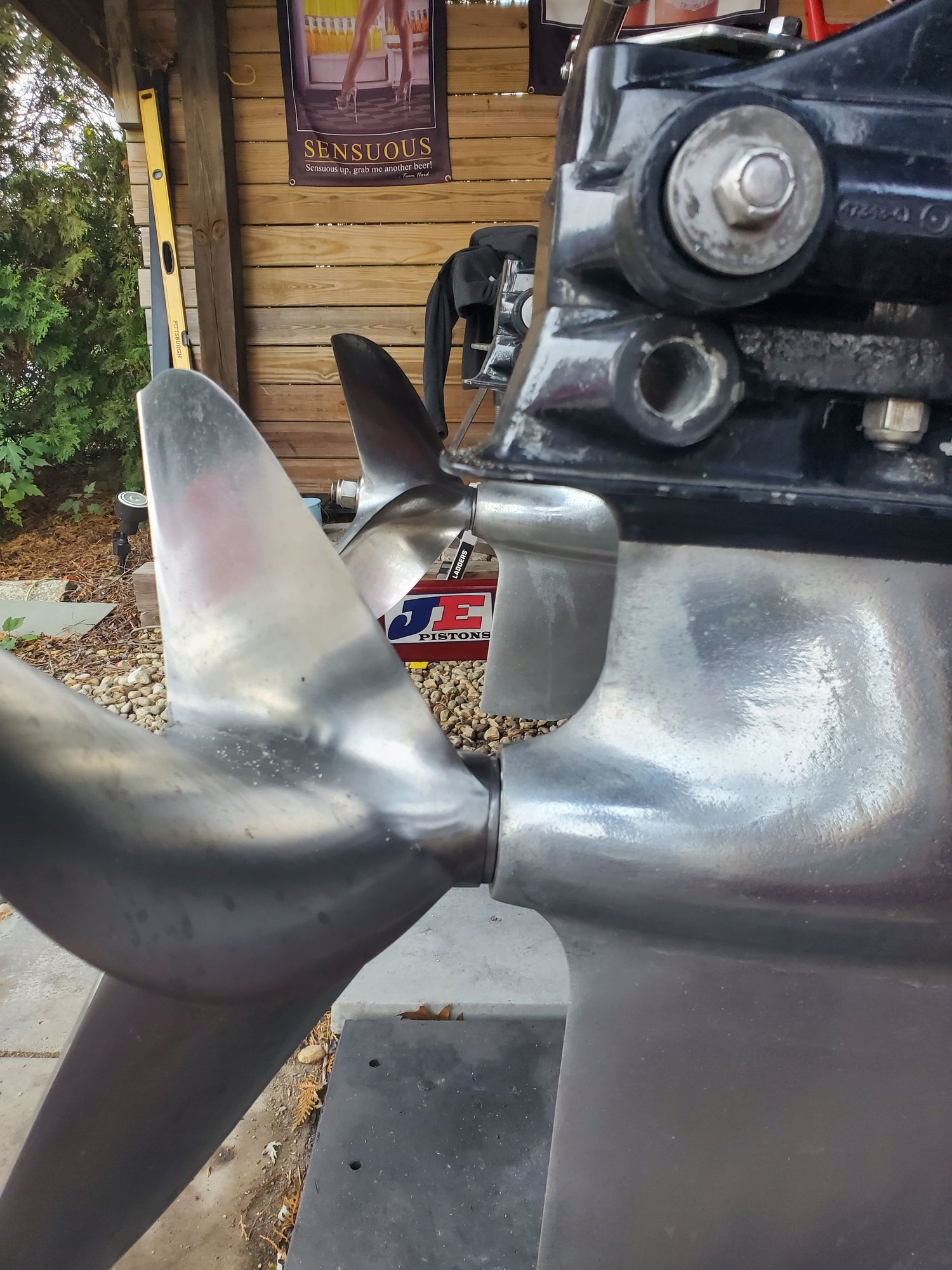

She used to run hoppy:
Now she runs happy :
2" spacer and lowered boxes an extra inch.
3" below bottom now, she seems to like it deep

Dan, my boat had aluminum Cav plates on it when I bought it. They eventually broke, was a noticeable difference getting on plane without them. Had some SS plates made up & had them made about 2 inches longer, big difference. Just a straight plate makes a nice difference. Plus it's nice covering up the top of the props, getting in & out of the boat. On your drives don't the props come up past the lower into the front of the upper?

Ya , Can`t attach to cav plate ...I would have to make a plate that fits between the lower and upper. That means machining the grooves for the o rings. Dammit
Are those 5's? I've never noticed the props com up above like that.
