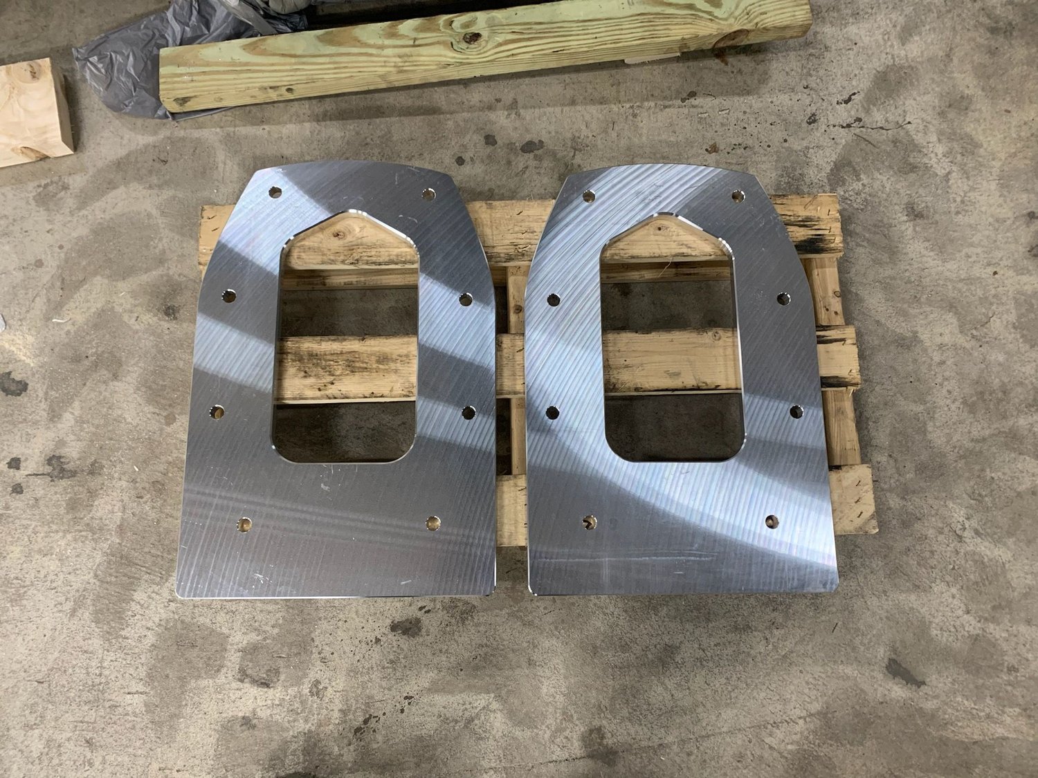

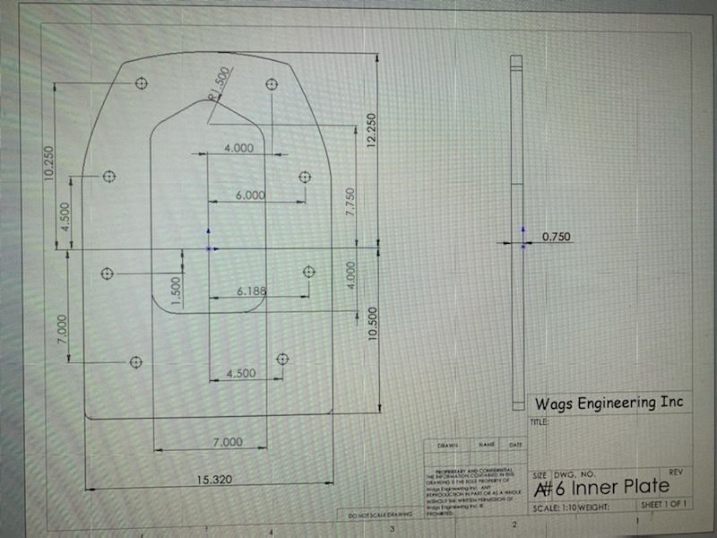

# 6 dimensions .
I`m having a larger inner transom assembly piece made out of 3/4" aluminum for more surface area
The mercury one seems inadequate .

Originally Posted by ICDEDPPL
# 6 dimensions .
interesting datum scheme on that drawing…

Nice, i think use that print to make a set of drill fixtures like Glass Dave has.

Hi Dan , the inner plate looks slick . Have you considered welding stiffening ribs on either side of the plate as over kill to carry the weight . Just a thought . Cheers RG .
I think they`ll be fine Rick.
I didn`t like the lack of clamping surface area on the stock mercury units.

Are the dowels to keep the drill at the right angle?

Agreed Dan they look really stout . Nice work my friend , you be wet sooner than you think . Cheers RG
Hardened .. yes so they go in straight
The crossbar sets center to center dimension and keeps everything right on the money. Middle bolt is centerline
