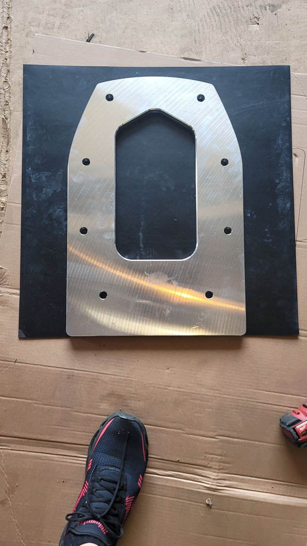

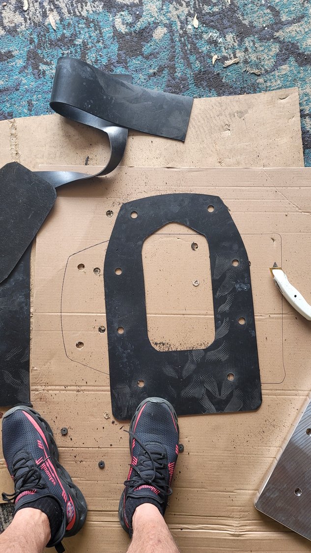

Made some gaskets, didn`t want to glue to a new transom till I know where it likes to be height wise

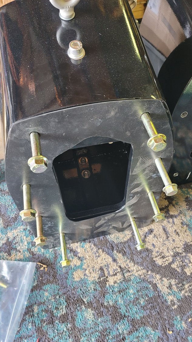

From: Chicago
Coated all the holes over and over and finished with some life caulk before fasteners went in.
The penetrating epoxy stays tacky for a day .. wonder if adding more hardener would make that faster ..
anyway some movement this weekend while I had some time.
(tape is so I don`t scratch the fresh powdercoat)
