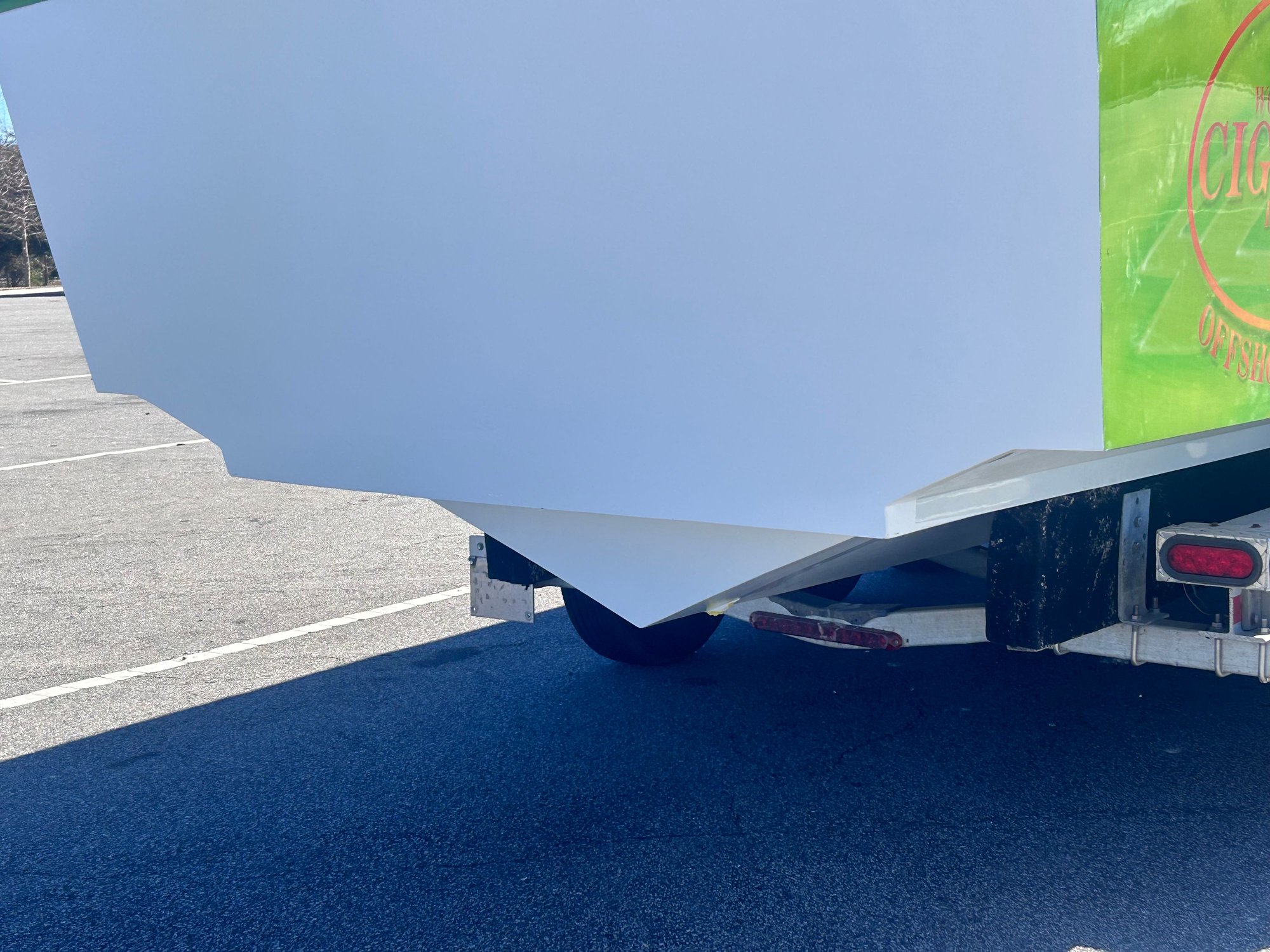

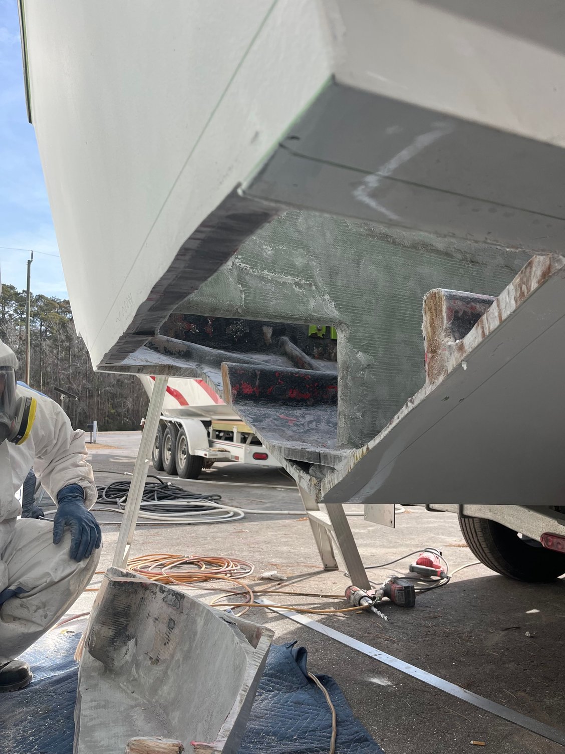

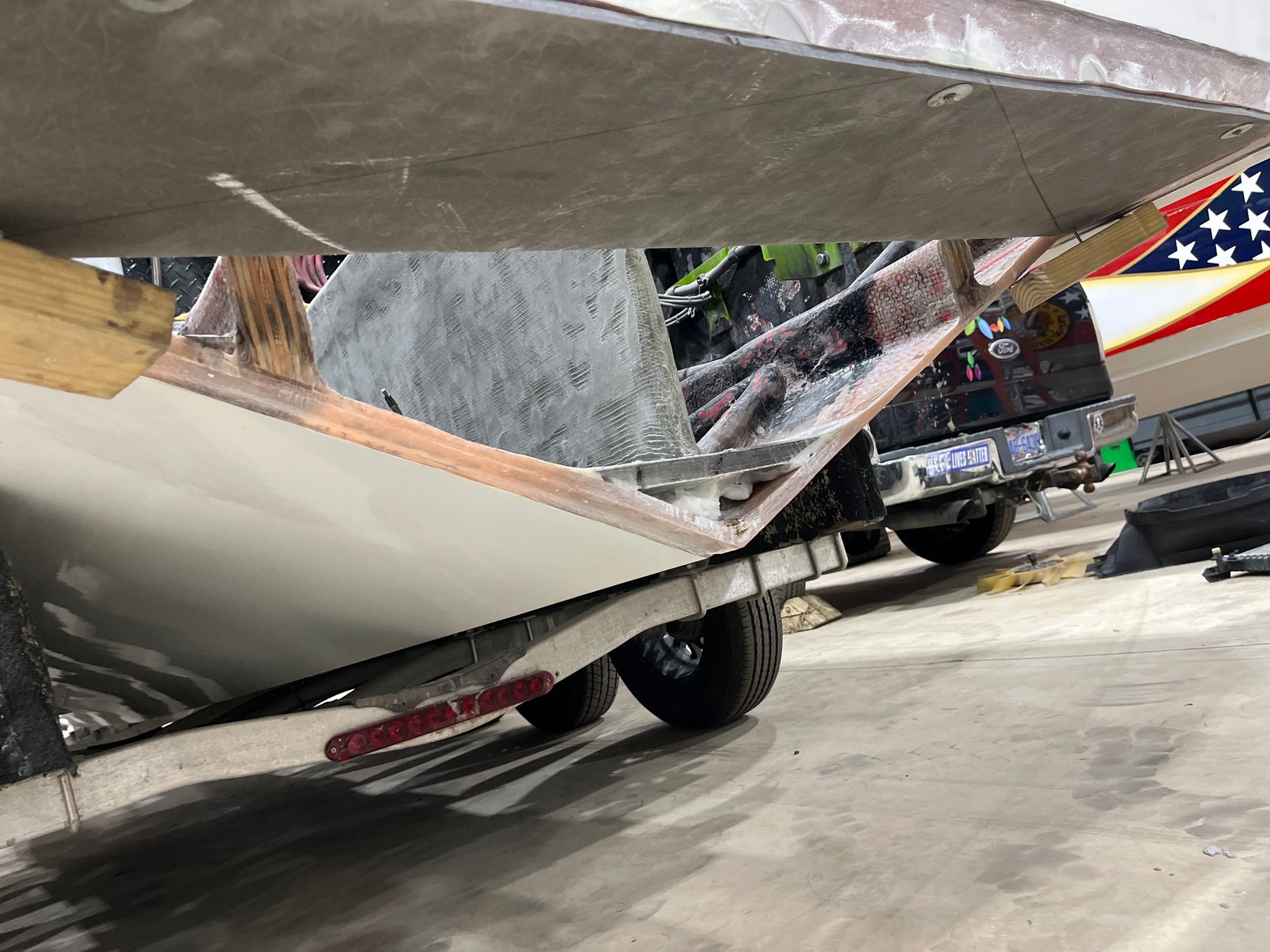

Originally Posted by Nickg3130

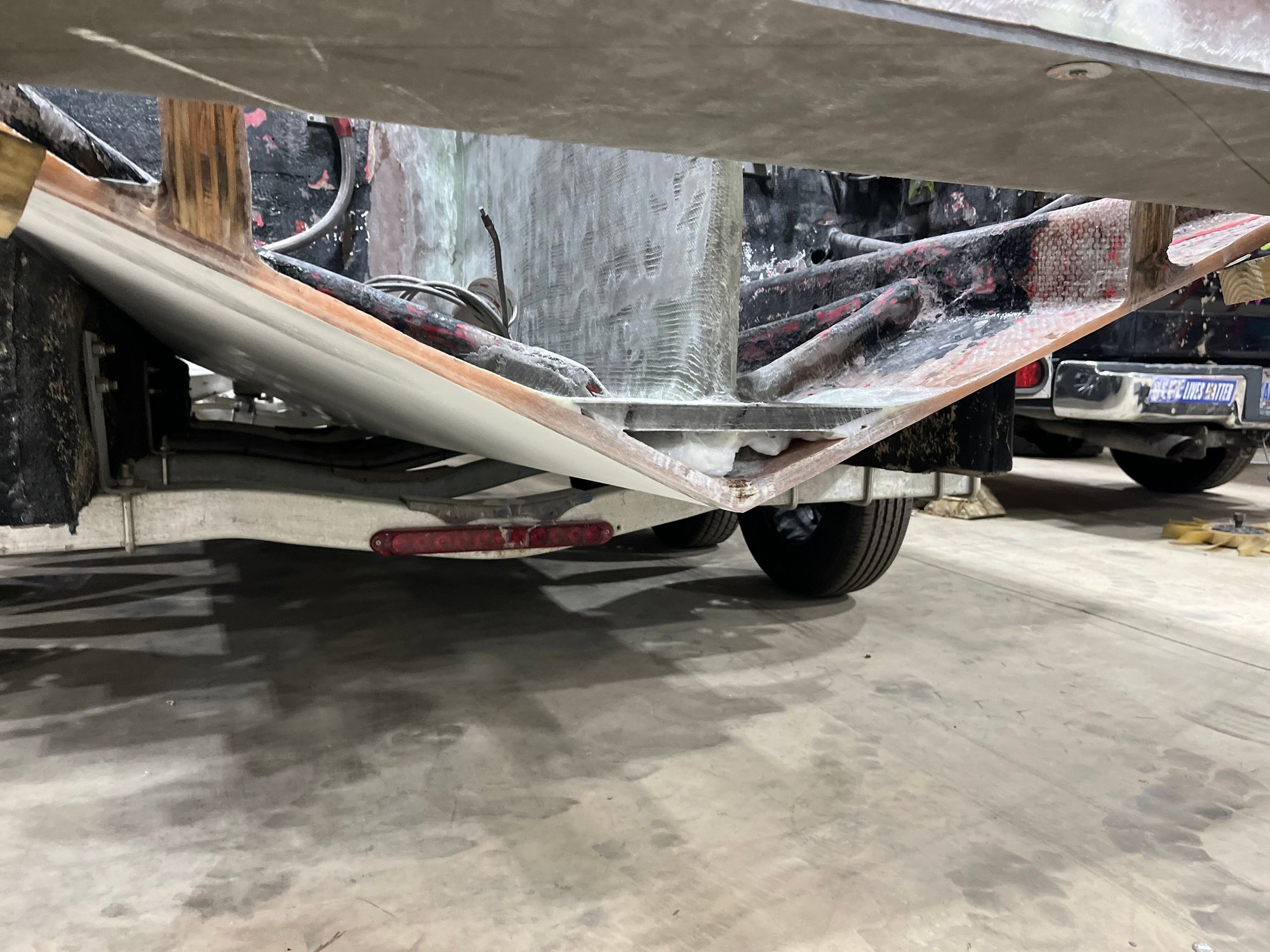

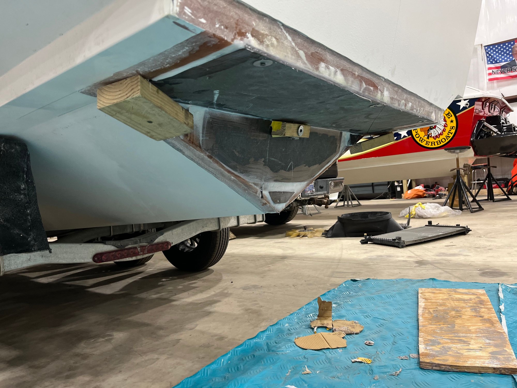

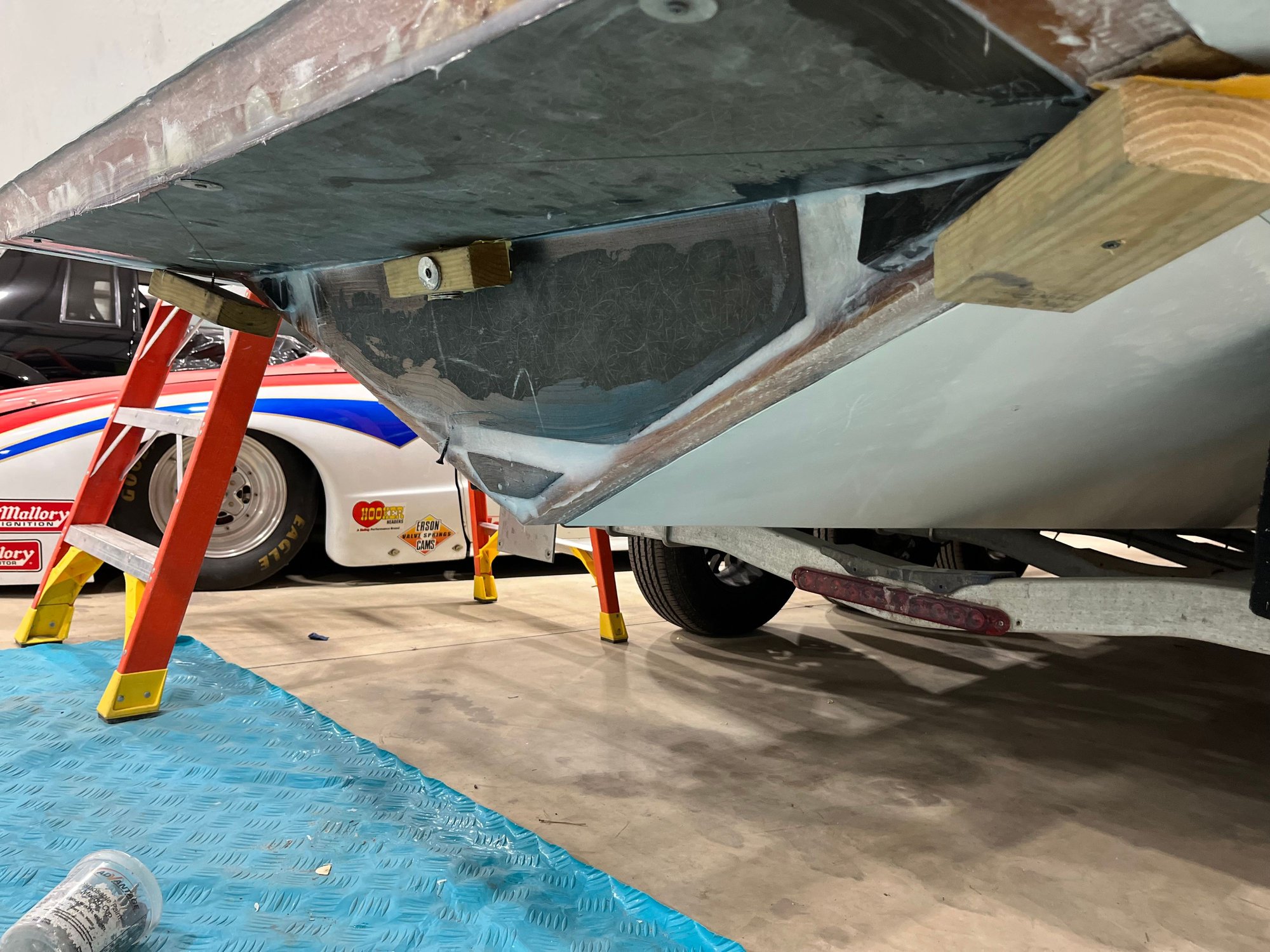

Well, I NEVER thought it would escalate to this, but we are NOTCHED!
after going and back and forth on the idea, I figured that IF there was going to be a time, this would be it. So after taking measurements from the Apache next it, we have a notched transom. The new center stringer was almost perfectly made for it.
looks awesome Nick! that apache used to be all black and called Shaka...
yessir! That was the boat that was a bow rider for a short period of time.

Hi Nick nice work . I put a notch in my 1985 Kevlar flat deck when put on the ssm no 5 drives on . How big is your notch. I reached out to Phil Lip**** and he advised me to go with a 10 inch notch as opposed to what ever the standard Cig notch was. The boat handles great and jumps up on plane with the 5 drives . If you are going with sixes I imagine the improvements will be even better. Keep up the great work. Rick G .
Thanks Rick! Your thread inspired me a lot about adding the notch. I think you and I may be the only ones who have done it. I mimicked the 41 Apache so I believe the notch was 11” give or take.

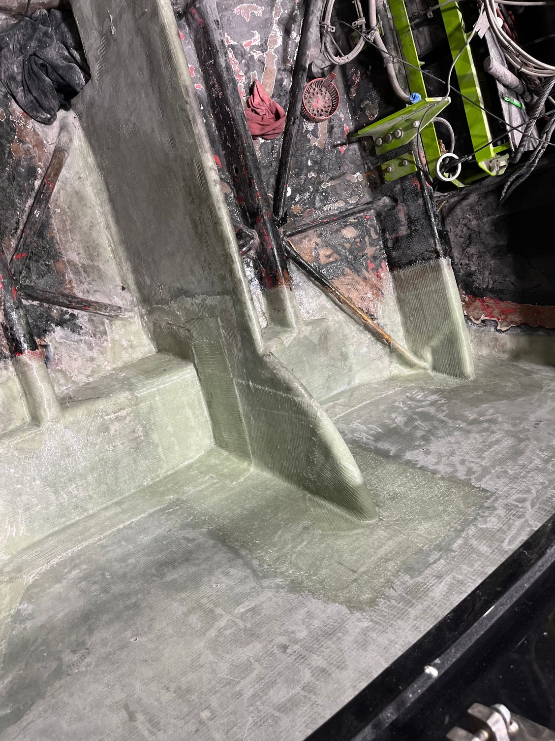

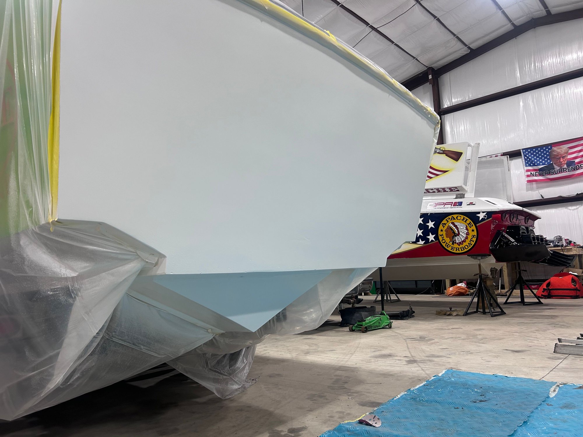

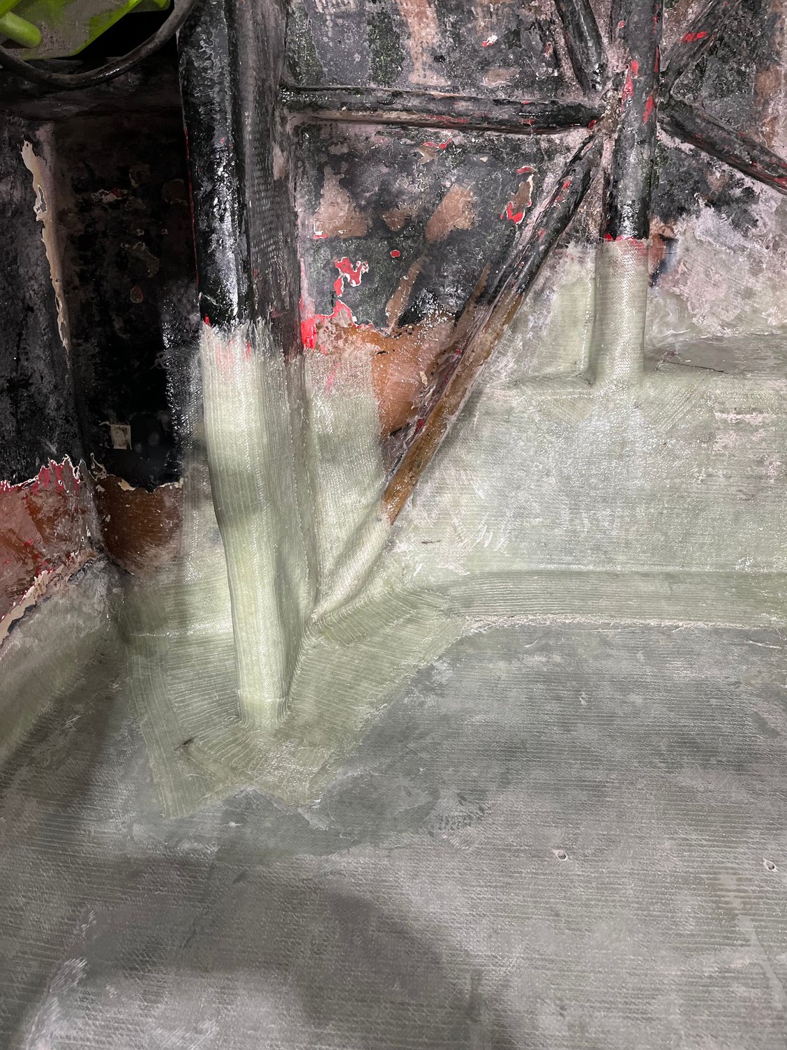

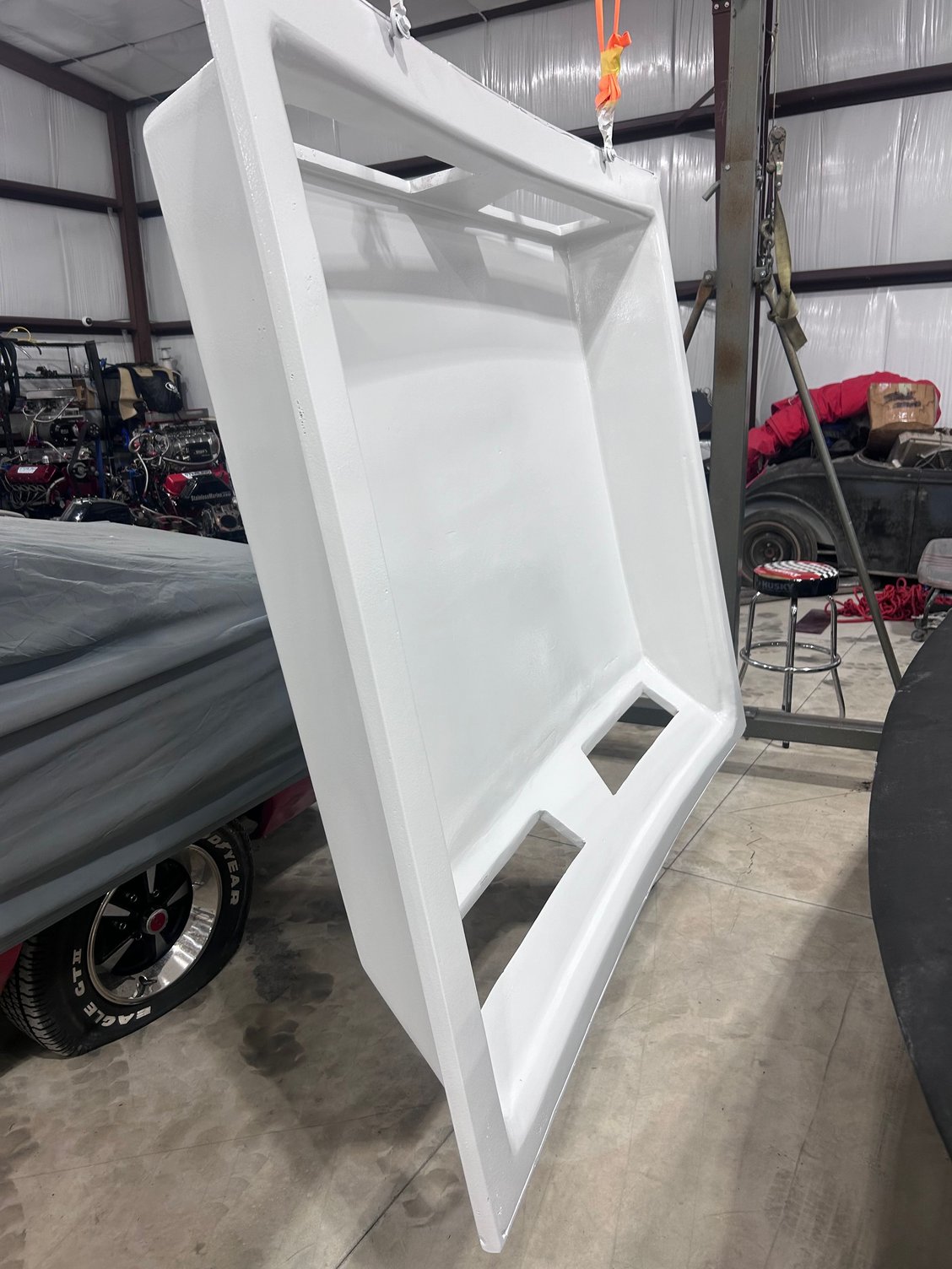

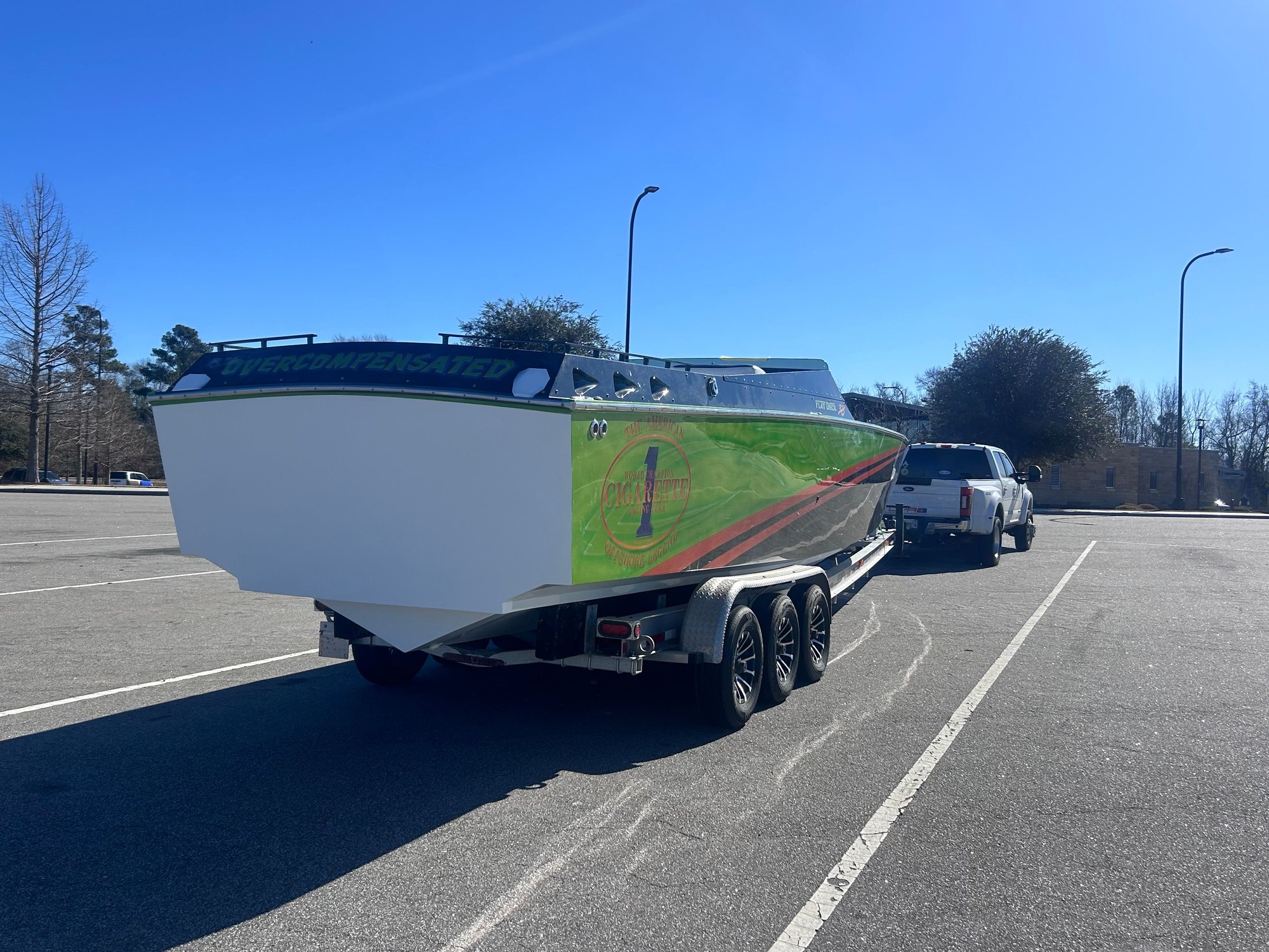

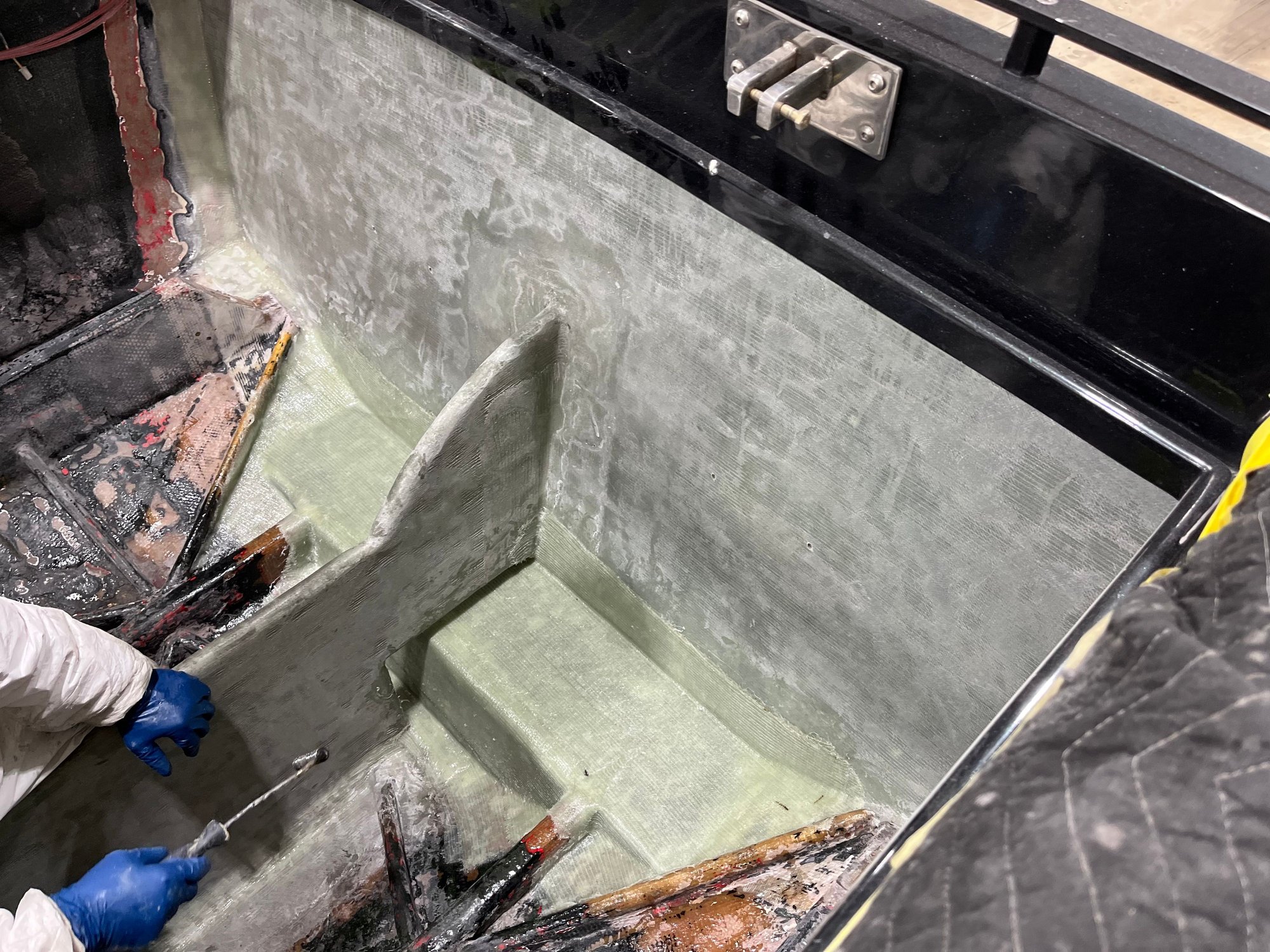

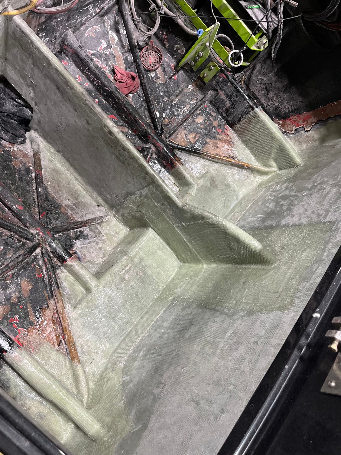

Well, can’t believe how well this crew did in about a months time. Hatch done in primer, transom with notch done in primer, bilge prepped and painted. Off to get some holes drilled for drives!
