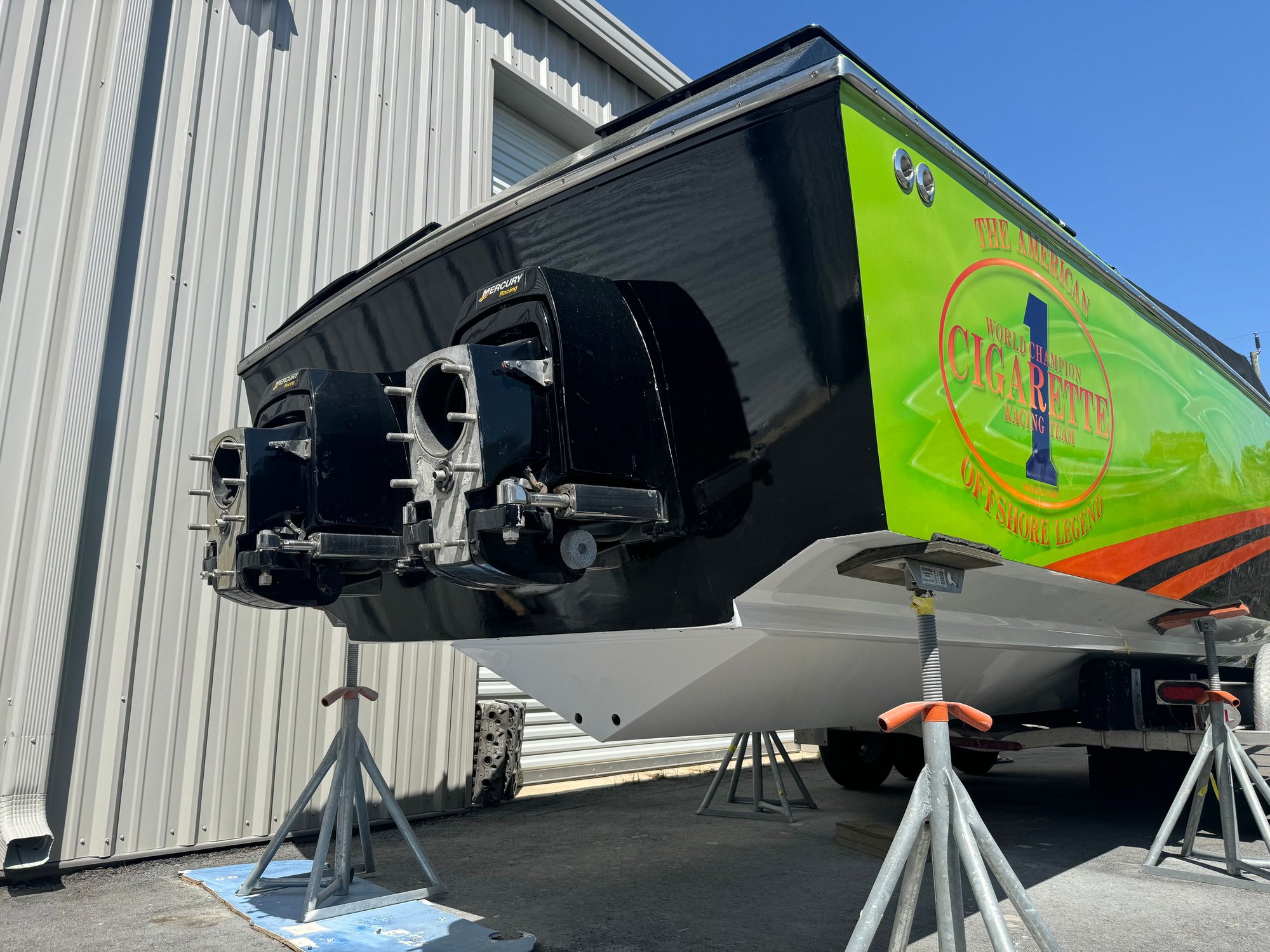

Been kind of slow progress lately bc we’re waiting on parts and time to start rigging. But here’s a pic of the transom and bottom all painted.
Nickg3130 is offline

Every time you post pics im
just amazed. Such nice work. Looks fantastic! I wish everyone worked as fast as your guys did. lol
sh*ts gonna look mean with those 6’s hanging off the back.
thisistank is offline
thanks man. I can’t believe how quick it got done and not only that but the quality as well. Beyond happy. I just wasn’t planning on behind this far ahead now I’m waiting on engine/drive parts lol. Spring is officially here tho!
