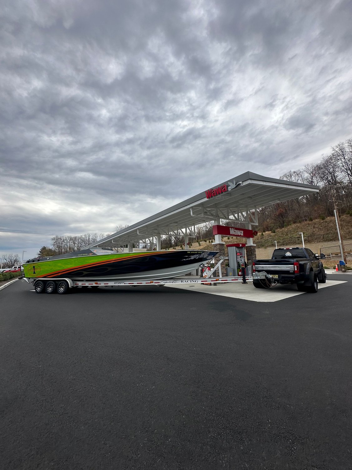

Originally Posted by Nickg3130
Well it’s official. Brought her home today from
michigan to NJ. Can’t wait to start upgrading this thing over the winter
Congrats!! great looking boat. Would that to be the Wawa in Mt Olive? Where in NJ do you boat?
that off of 206? If so then yes lol. I boat mainly up in the Navesink/raritan with my 24 Pantera. But the cig will probably be in the barnegat-raritan bay mostly. Occasional trip down to the Chesapeake.

Yea, that's it. lol Do you do any of the Spartan Powerboat Club runs in the Barnegat?
