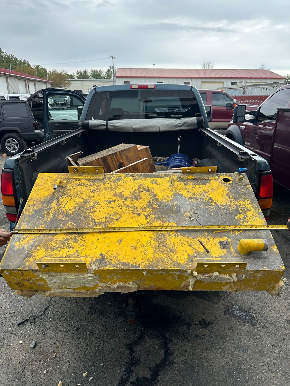

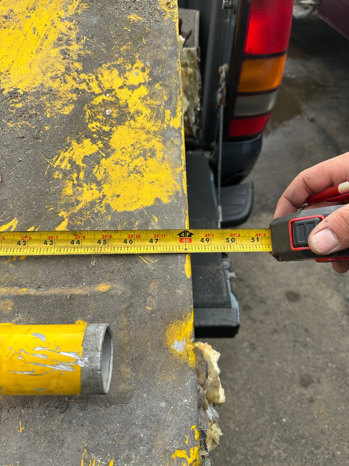

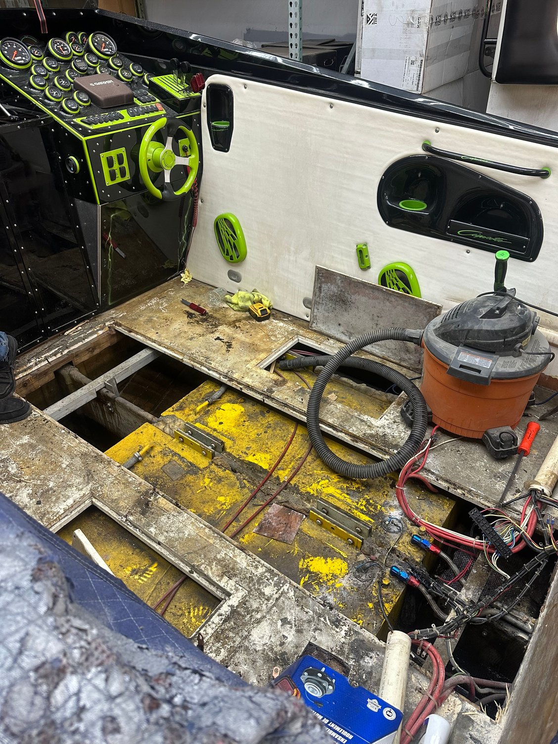

Got her back up to NJ for me to start rigging. Or atleast try for that matter. What’s the saying again? 1 step forward 3 steps back..
https://cimg8.ibsrv.net/gimg/www.off...f44e8b323.jpeg
https://cimg9.ibsrv.net/gimg/www.off...391ac9c8e.jpeg

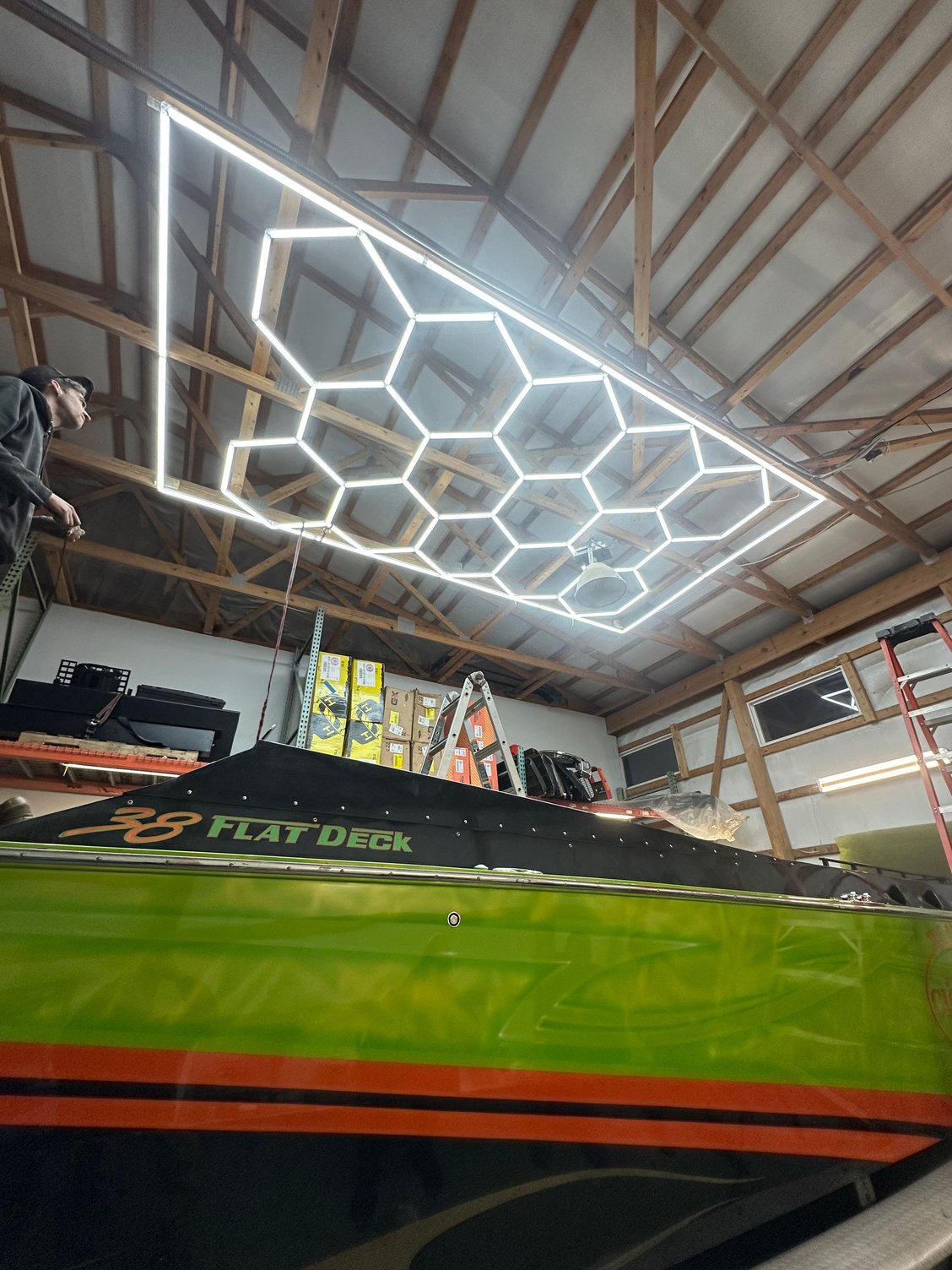

was super happy with this hexagon light tho. For $179 on amazon I highly recommend..
https://cimg0.ibsrv.net/gimg/www.off...8bca6958d.jpeghttps://cimg2.ibsrv.net/gimg/www.off...9a376e9a0.jpeg
https://cimg3.ibsrv.net/gimg/www.off...84d160c0d.jpeg
https://cimg8.ibsrv.net/gimg/www.off...2a22ade24.jpeg
https://cimg9.ibsrv.net/gimg/www.off...2074afd12.jpeg
It sucks, but man am I happy we did it. No way for the water to get out in between the 2 bulkheads where tanks sit. Pumped out over 15 gallons.
they told me the tanks have been replaced which they were. But only 45 gallons per side! Man would I have been pissed after putting some big motors in this thing.
Getting 2 125ish gallon tanks built up now. Should squeeze nicely in between both bulkheads. Then you know new floor rear seat etc. I guess it’s a good excuse to put some seadek or marine mat down now 😂

Should say: Pro Tip Hexagon Lighting.
I have a commercial building that I keep all my things in. Lighting is always an issue for me. I am going to order something to see how I like it. 18' under the joists, but from the looks of your work area, it's not exactly low ceilings either.
Thanks for mentioning this, and good luck with the project!
bigboat28 04-16-2025 08:12 AM
That light put out lots of light?
offshoredrillin 04-16-2025 10:06 AM
I think spring is here btw 🤦🏽‍♂️

Looks like you'll use every inch of the sub floor with new tanks....who's building tanks...Jersey fabricator?

Wow ! This will certainly shed some light on this project ! :)

if you saw how dark this shop was before I’d say it puts out lots of light lol.
Oh yeah it’s gonna be tight but I want all the fuel we can fit. Honestly if the holes in the transom weren’t drilled I would’ve semi staggered it, but I still have to remember this is a “pleasure” boat lol. I have Atlantic Coastal welding in NJ doing the tanks. They did my Pantera and are able to rush the job for the cig. Gonna cost some more but gotta pay to play as they say.
