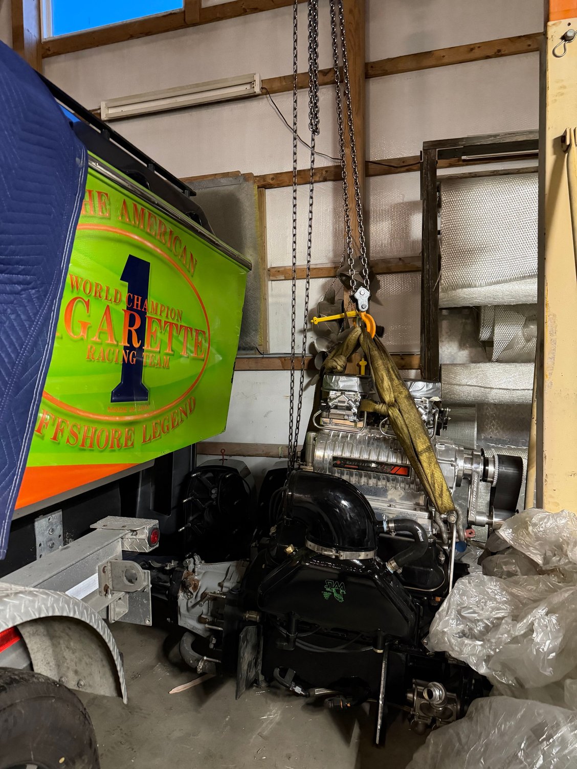

Little update…
https://cimg4.ibsrv.net/gimg/www.off...db387cfab.jpeg
These should help this big girl get going. Especially with everything from the cabin back to transom now being coosa. Got a new phone and lost a ton of photos but we’re back on track now!

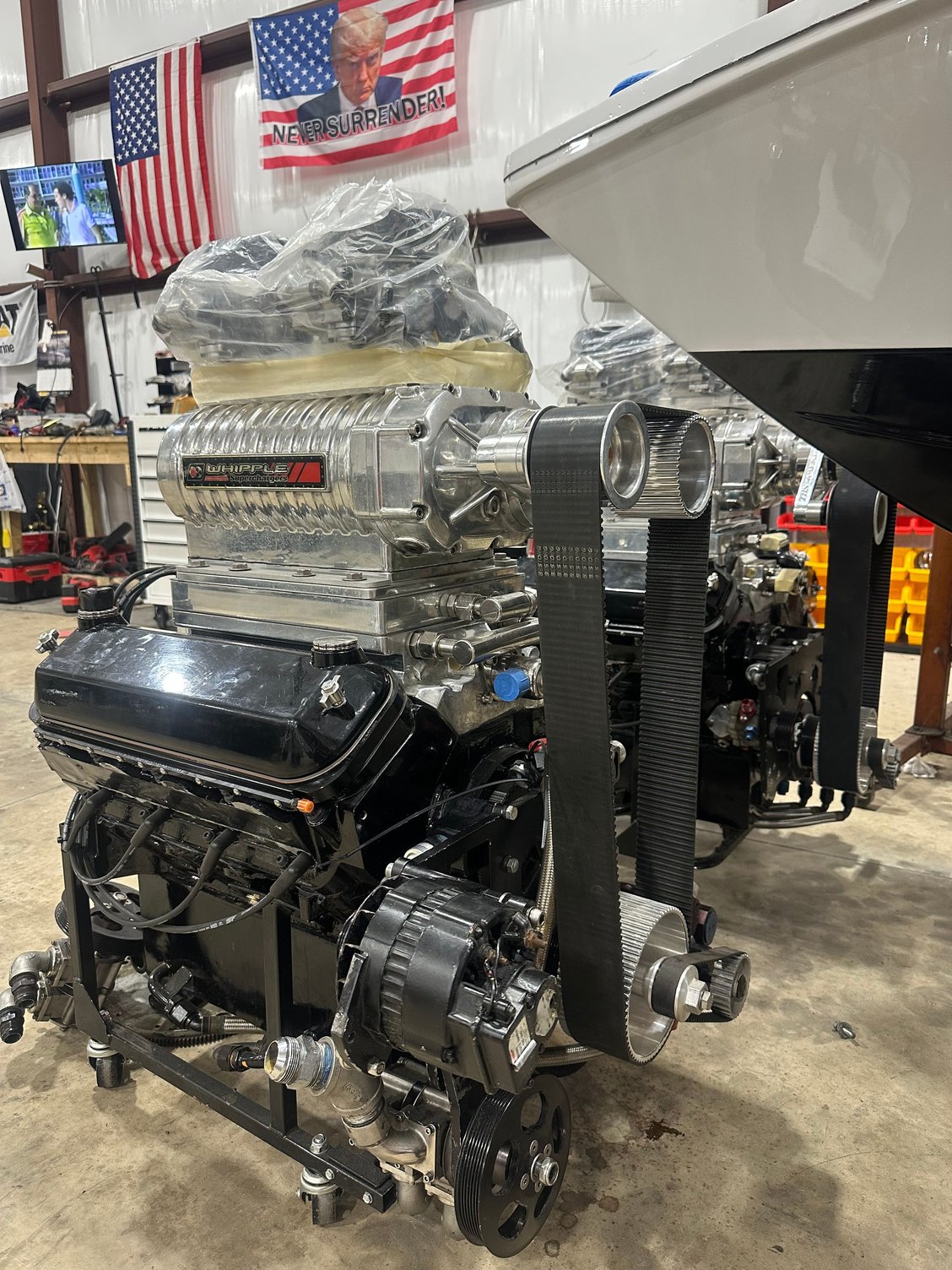

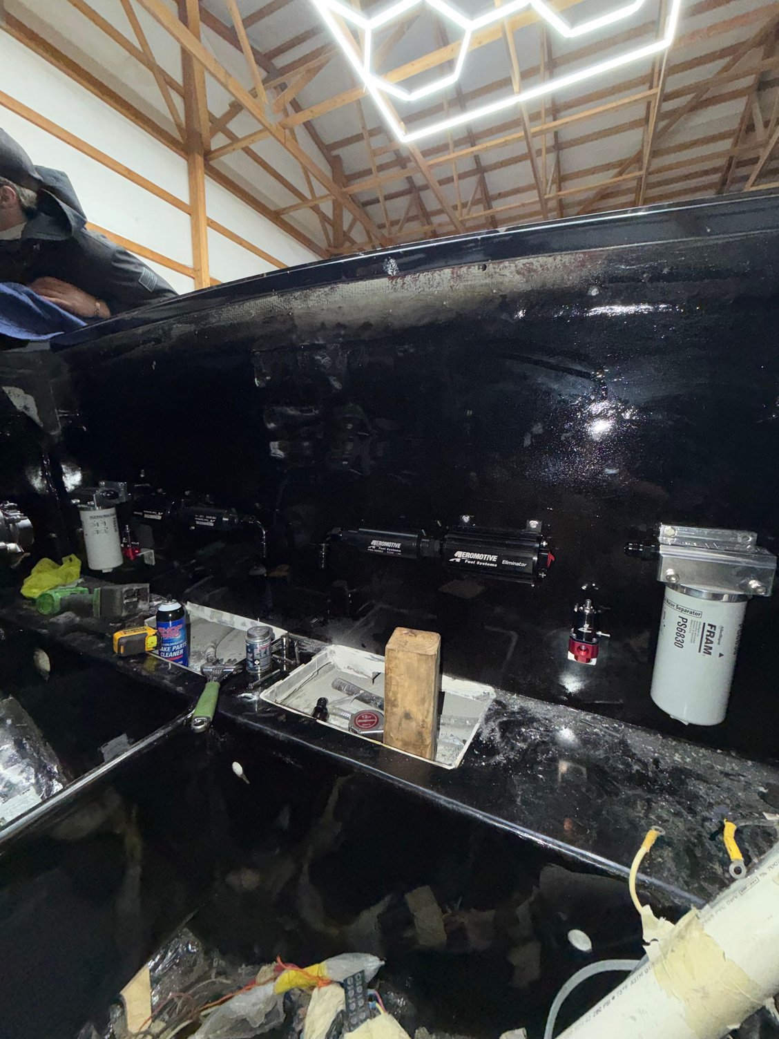

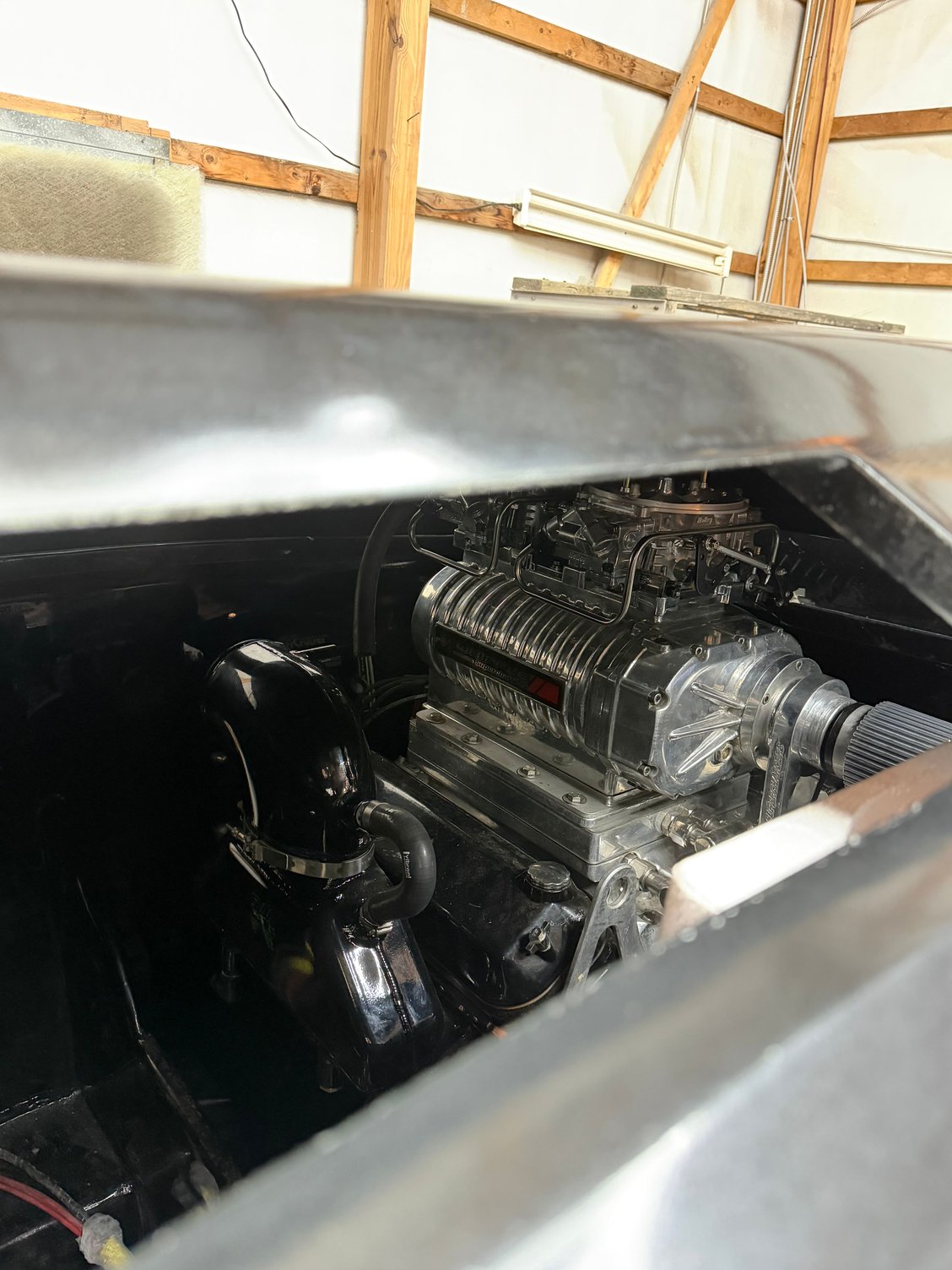

Few updates..
got a motor mocked up on port side. Nice that I can start laying put where things go in the bilge. We have to raise the drip rail that the hatch lays on now that the motors are much higher/taller. But I think it’ll look better this way anyway. What’s a little more glass work at this point lol.

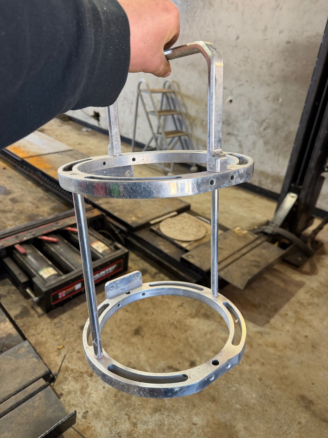

fuel system and dry sump tanks are mounted. Made brackets for the dry sump tanks out of the old bumper holders that were in the boat. Who needs bumpers when you got horsepower

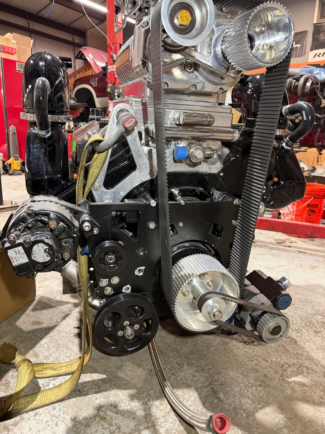

So far my only “dilemma” is figuring out the damn serpentine drive set up these motors have. I believe they're old Keith Eickerts but it’s hard to get any type of info on them. I tried calling Hardin and they say it’s different than theirs. If anyone has any info on these it would be much appreciated! Absolute worst case I’ll switch back to tradtional v belt if I have to.

kreed 03-01-2026 09:47 AM
Thanks for the update! Everything looks great! Are you going to be able to get to those dry sump tanks with both engines and exhaust installed? looks tight.... I guess thats what the whole "mock up" is for! Nice work!
Nickg3130 03-01-2026 10:00 AM
it’s definitely tight but I want to keep the “clutter” out of the front of the engine room if possible so i have some room to work in there. I can get to the oil tank fills no issue. But things will get changed I’m sure.
