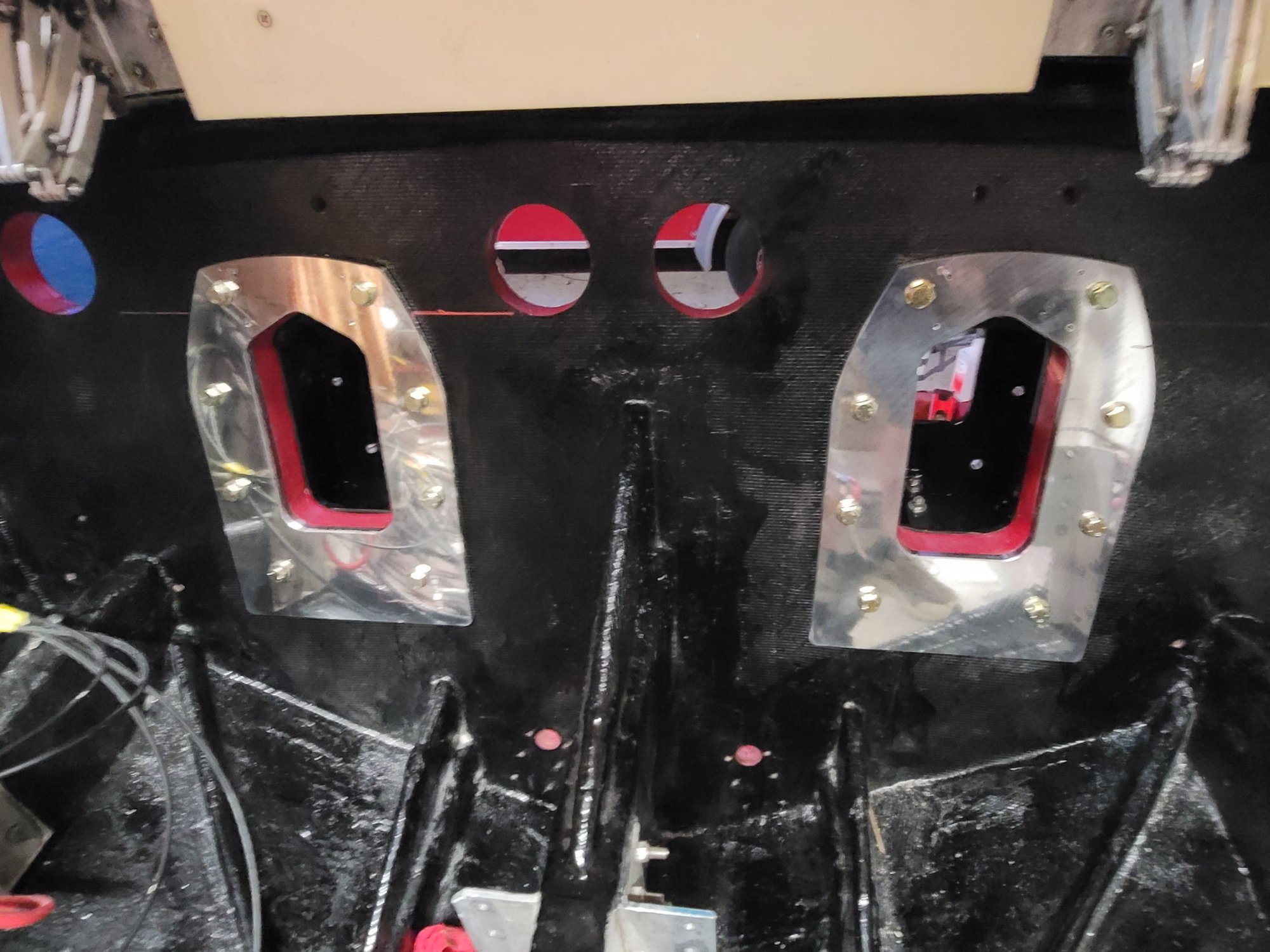

ICDEDPPL 01-06-2025 11:15 AM
Now is the time to make the center stringer beefy/taller to reinforce the transom
before :
https://cimg5.ibsrv.net/gimg/www.off...c89eb81c22.jpg
After:
https://cimg3.ibsrv.net/gimg/www.off...5a4694202c.jpg
https://cimg4.ibsrv.net/gimg/www.off...2bbc3095b8.jpg

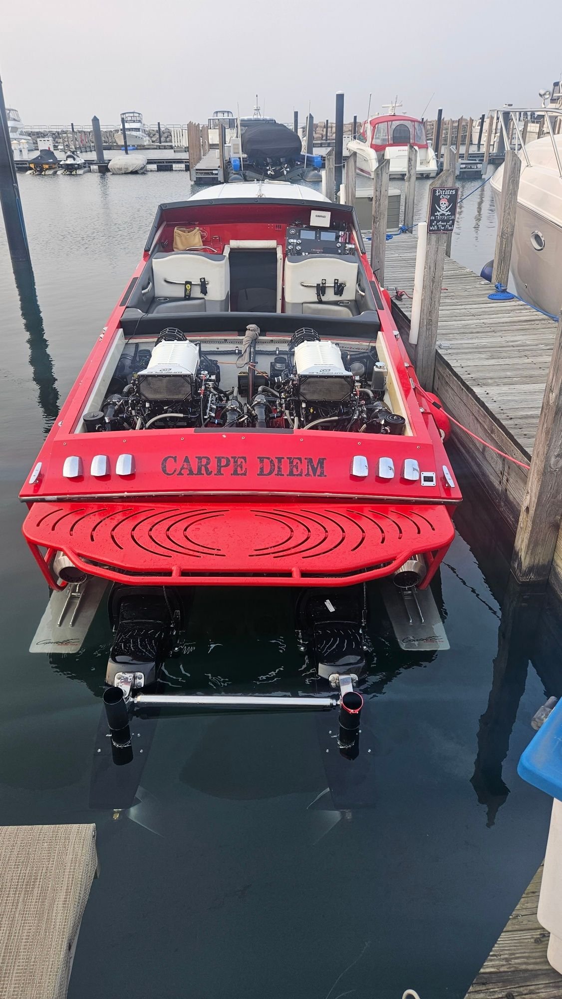

ICDEDPPL 01-06-2025 12:06 PM
I`d also recommend placing the tabs horizontal.
https://cimg7.ibsrv.net/gimg/www.off...f21e9b5a89.jpg

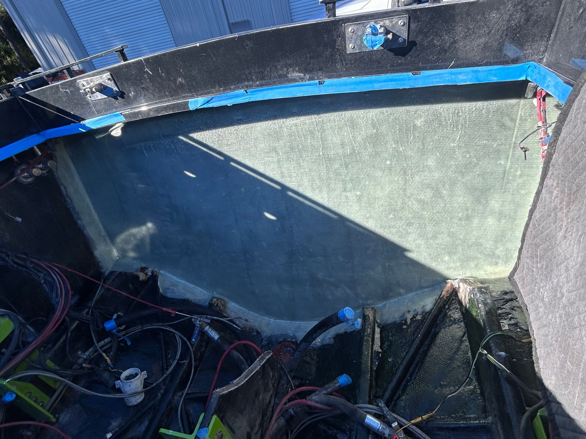

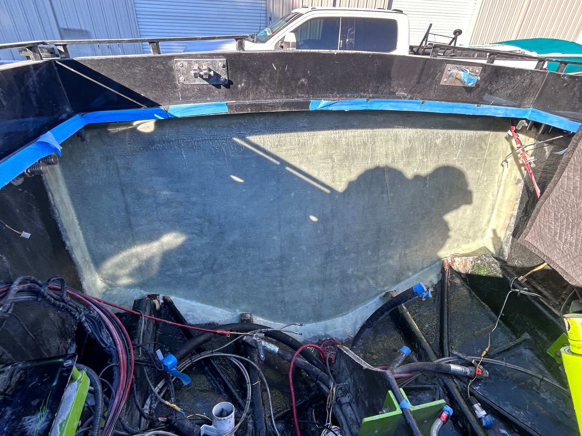

Nickg3130 01-07-2025 08:46 PM
Oh boy… ima stay out of this one..
although I will say I do have 380 tabs.. im not sure how much that changes it but mounting them flat may almost look awkward.. not sure about how it will perform though.
in other news, glassed in!
https://cimg2.ibsrv.net/gimg/www.off...c319923e4.jpeg
https://cimg3.ibsrv.net/gimg/www.off...00ef675d6.jpeg
https://cimg4.ibsrv.net/gimg/www.off...1b65ca29c.jpeg
Pnb 01-07-2025 11:17 PM
I know nothing about fiberglass work but that transom job looks badass!!
ICDEDPPL 01-07-2025 11:18 PM
Mine were custom and pretty big (thans again Mike I zoom!!)
They actually did something when they were level besides put a hole in the water . 6`s and 1000# blower motors and the weight of a flat deck, they needed to be level to work.

cheech 01-08-2025 10:26 PM
Are those all screws and washers to "clamp" the new transom while it cures?
Nickg3130 01-09-2025 07:06 AM
yes it’s to clamp and get all of the air out from in between the transom
