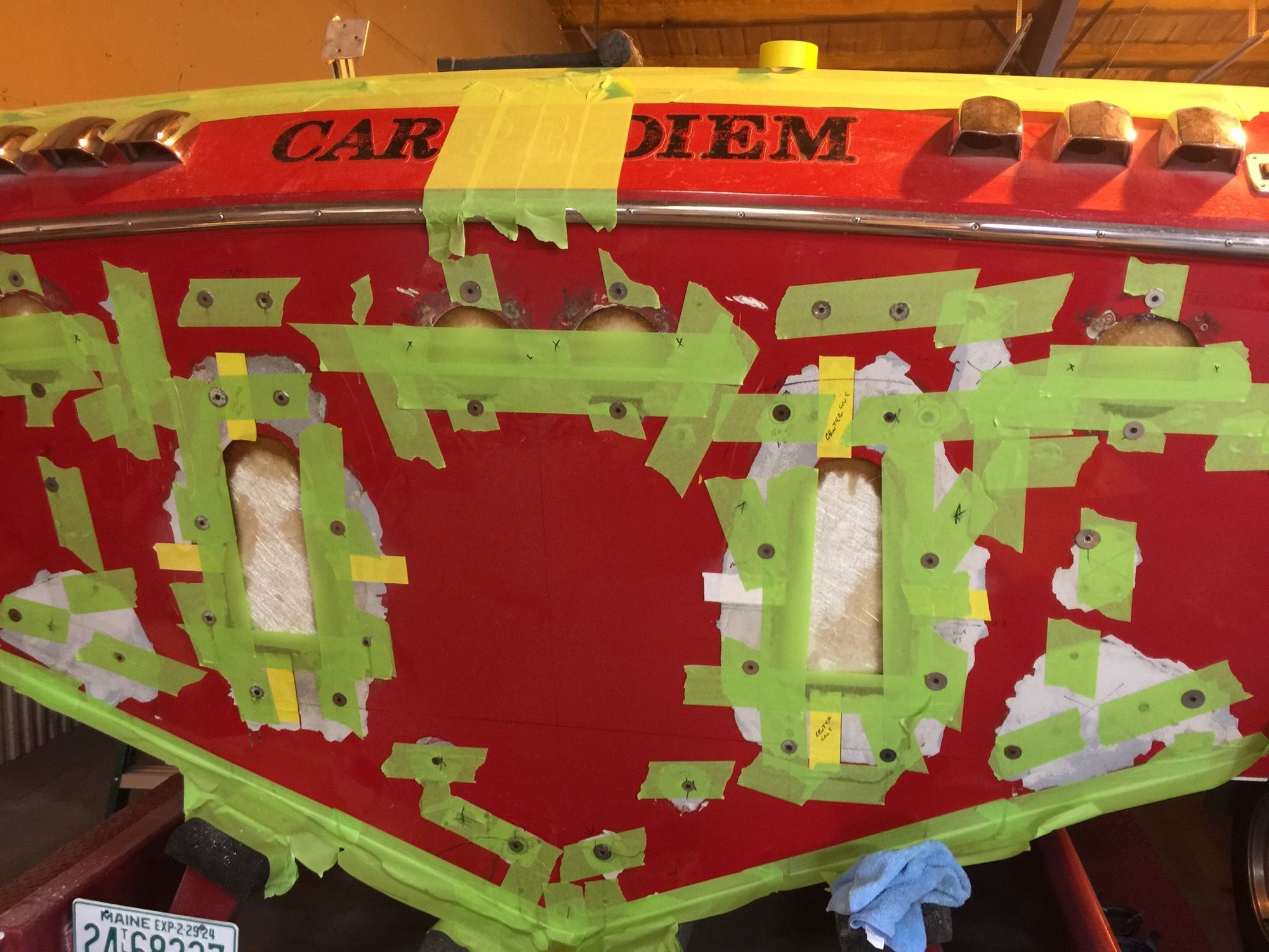

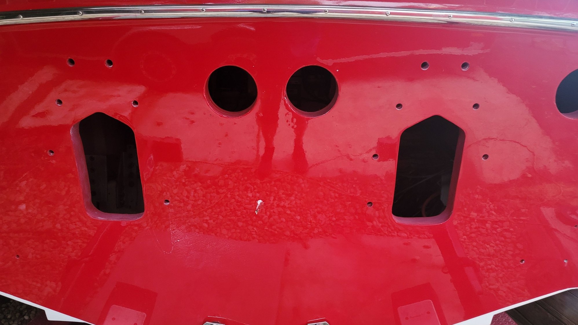

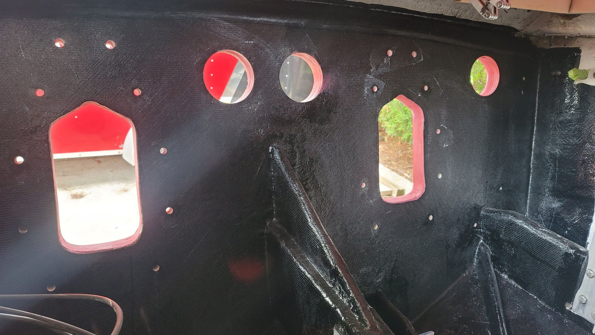

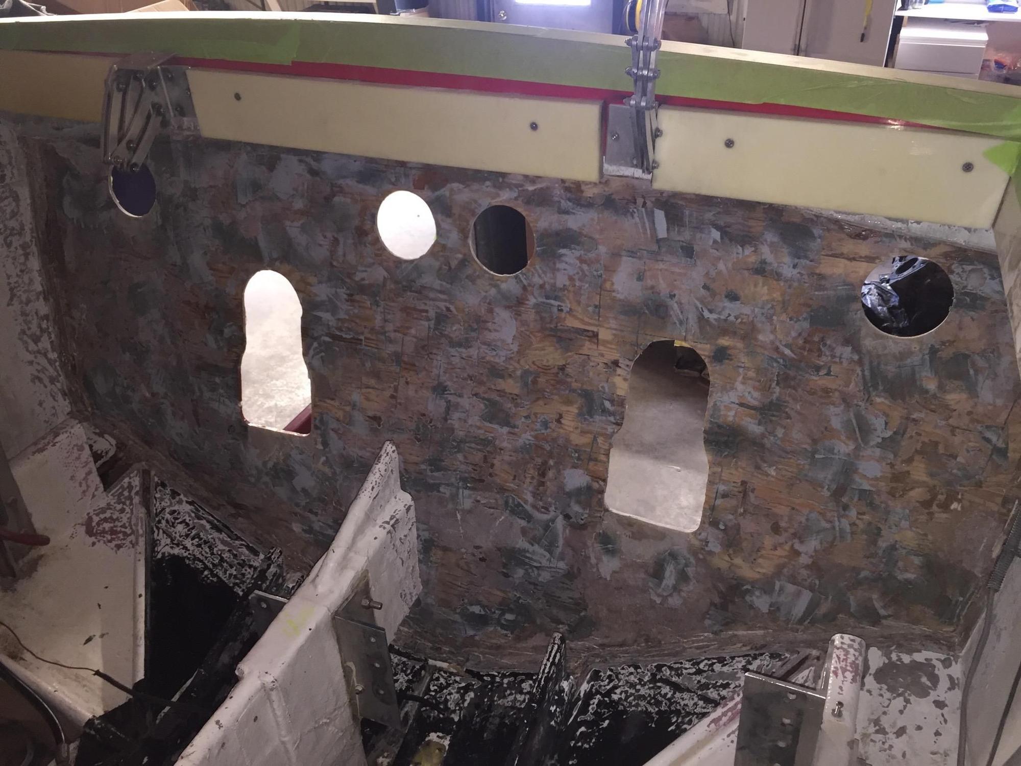

I did wood, my fiberglass guy said don`t do Boosa. He does 10 transoms a year so I took his advice.

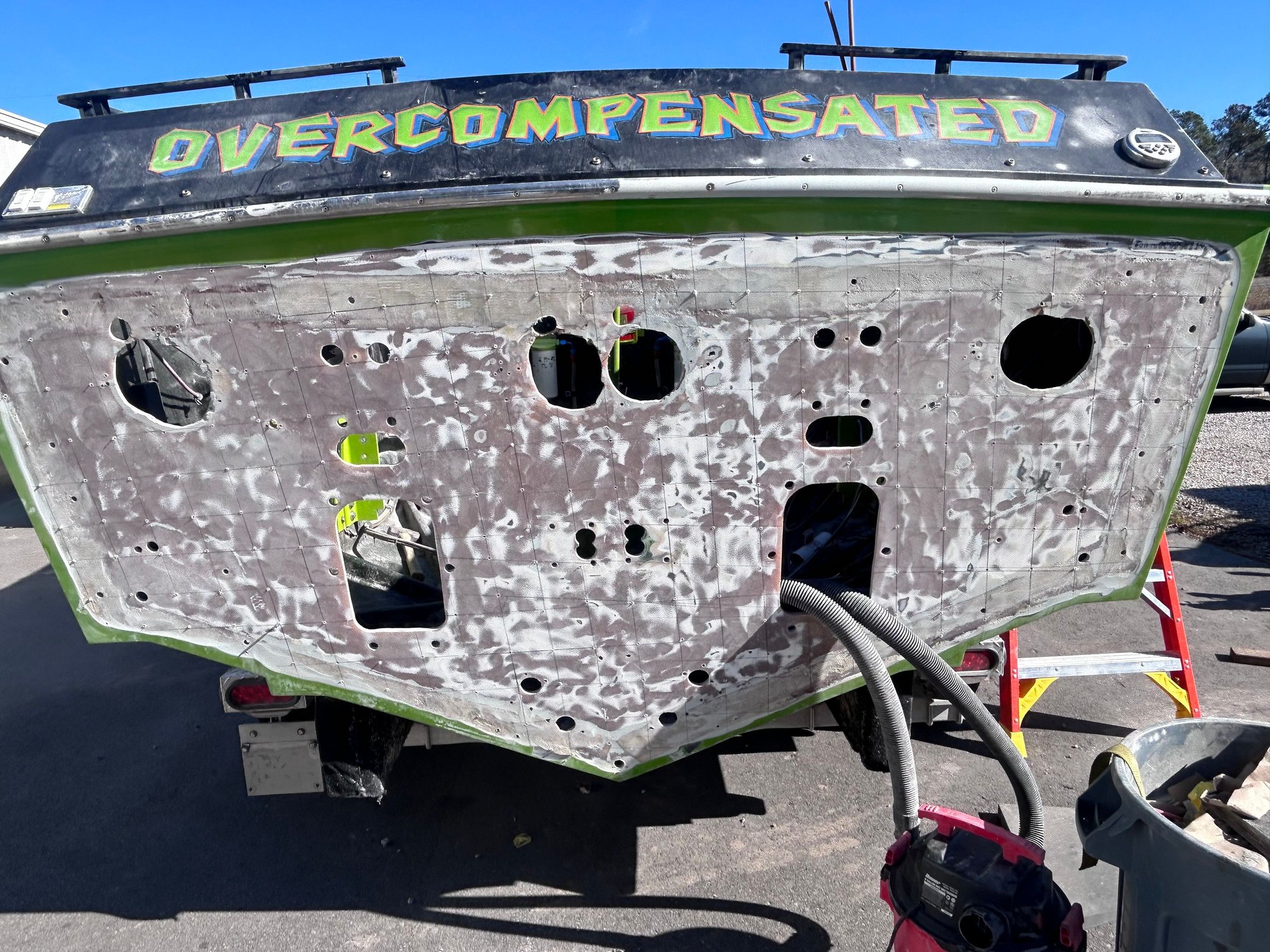

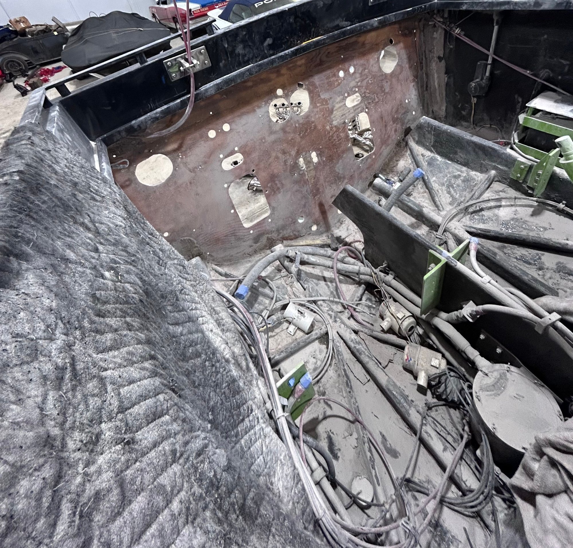

Nickg3130 01-04-2025 07:53 PM
Few updates..

old transom core cut out, glass grinded and ready for new core! My buddy and his guys are kicking a$$. Going to end up doing coosa. Should have a new transom ready for paint this week!
jeff32 01-04-2025 08:19 PM
The more rot!
the easier it is !!

why are you sanding down that much the outside transom?

he’s getting all the highs/lows out of it. It’s going to get painted regardless and honestly the way these guys are working im not asking any questions.. they had the transom cut fit and glued in a day and a half..

Looks like we’re gonna replace the center stringer as well it was questionable and at this point why take any short cuts.
