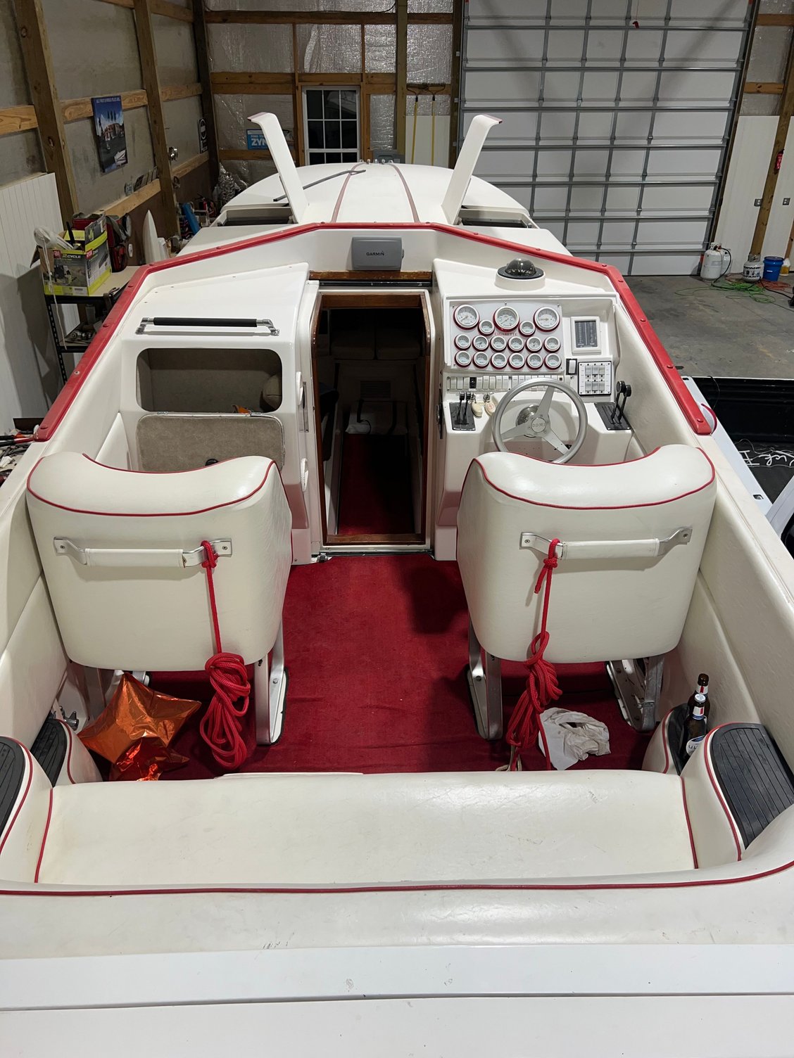

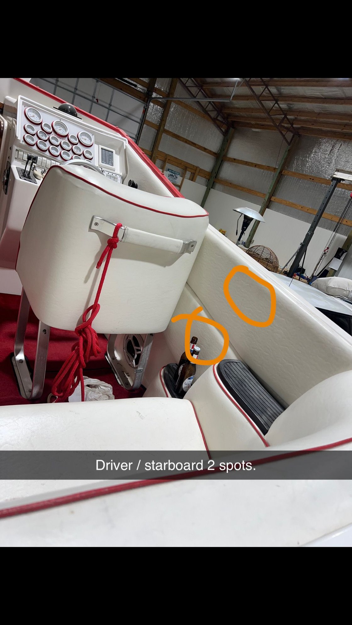

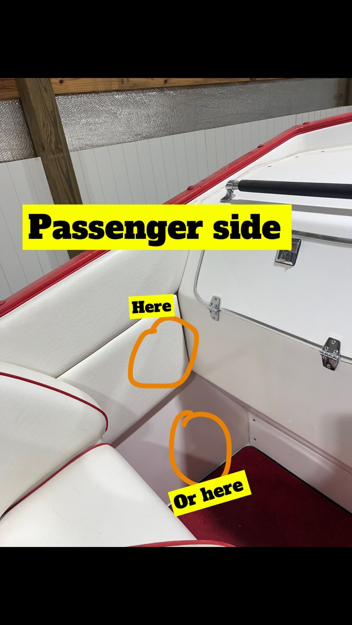

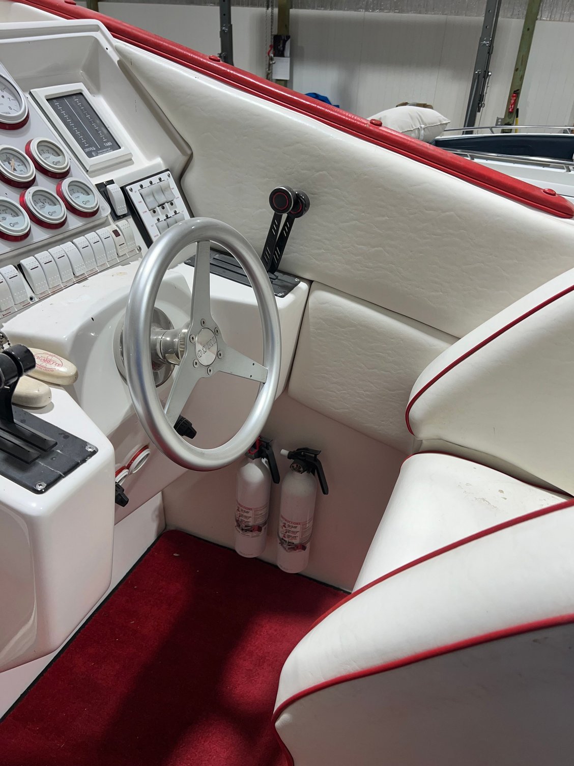

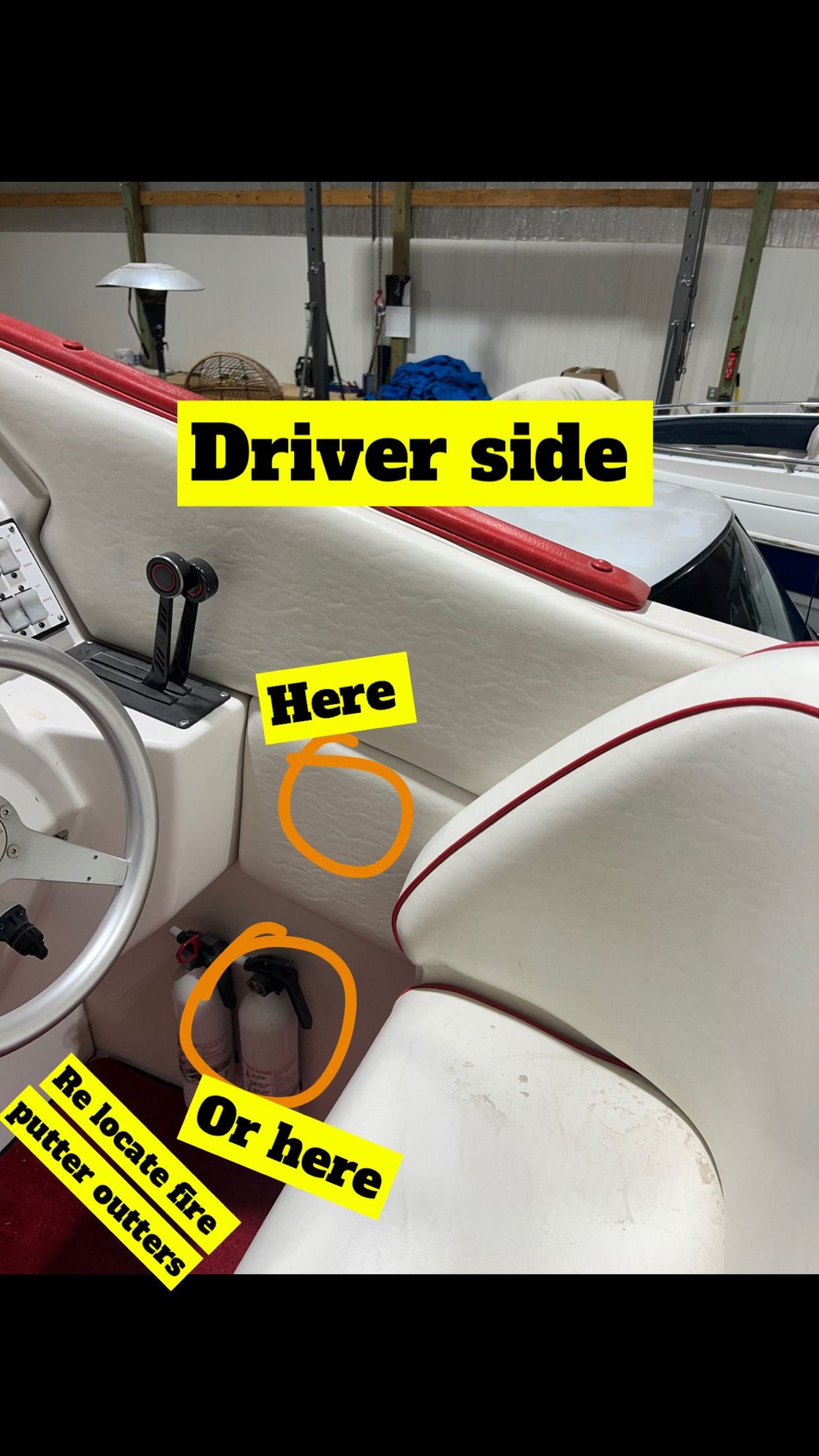

Hard to tell but your throttles may limit you with any size to putting the fronts down low where there is plenty of room. May interfere with throttling. On my last boat they were down low. Pro's of this location is it is easy to upgrade to larger sizes if you did not initially do so. Con would be the lower they are the harder they to hear from outside the boat. That's another reason I ended up with 8.8's powered to the moon lol. My old boat had great imaging from the fronts set up this way but it was not a Cig which may be different.
The rears you may need to check the depth the upper mounting location may be too shallow?

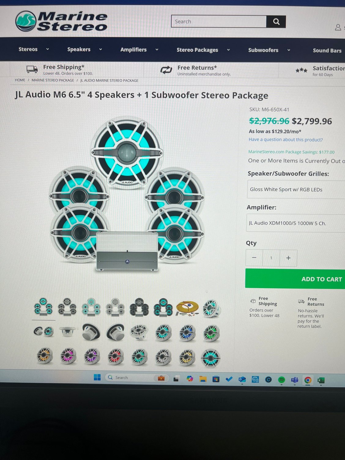

what’s your thoughts on this package with the 1,000 watt 5 channel?
I’m fine with one sub under the back seat instead of two. The one in this package is called a JL M6 10” for “ infinite baffle “
talk to me goose lol
Will it work and sound good inside the cockpit of a Cafe at rest? Yes
Will it sound good while running? Maybe
Will it make any sound outside of your cockpit? No
Is it the most money you could possibly spend for the least performance? Yes
That speaker setup on your $1000! amplifier would only be making 600 watts rms at 12.5 volts, and 700 watts rms at 14.4 volts. Ironically the subwoofer would be quite a bit over its rated power at up to 400 watts. But I think JL tends to be very conservative with ratings.

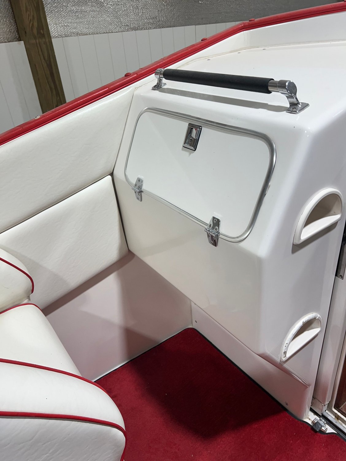

Old 02-16-2025 | 08:37 AM
  #67
Posts: 3,871
Likes: 799
From: St. Pete Beach, FL
Originally Posted by 87CigCafe

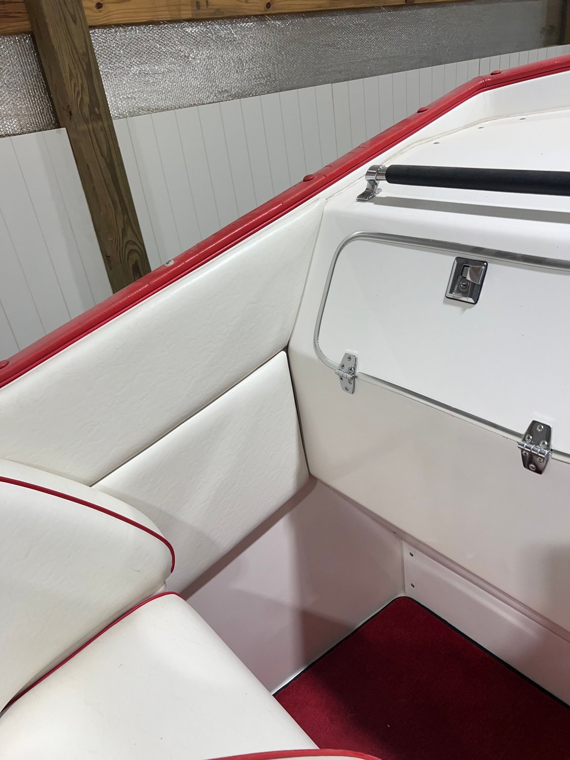

Ok so here’s what I’m thinking or working with on the interior of my Cafe.
tell me your thoughts and creative negativities.
please don’t mind how nasty she is right now. Been having to do some gel coat re finishing etc in my shop on another boat im redoing for my wife so it is embarrassingly dirty. Sorry!
Put a ruler in those pics for us.
hogie roll is offline

mine are here if it helps, also the 2 round black speakers are in the helms. I was also told the higher up would give a cleaner crisper sound and help carry it from the boat when your not in it...

Higher up would be better if you can make it work.

Subs will work better lower and aimed at some nearby walls. Highs are almost opposite. Mounted higher with no obstructions.
