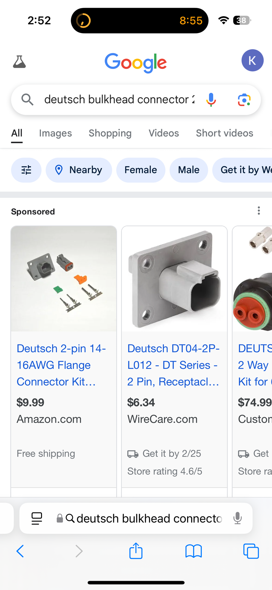

I see a lot of speakers have a deutsch connector now, which is super cool. I haven’t done a stereo with them yet, but I used to use them at work all of the time. I feel like you could come up with a duetsch bulkhead to use like this. 2 pin or 4 pin for 2 speakers.

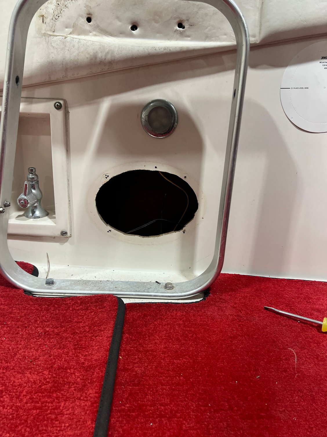

Default Alright.

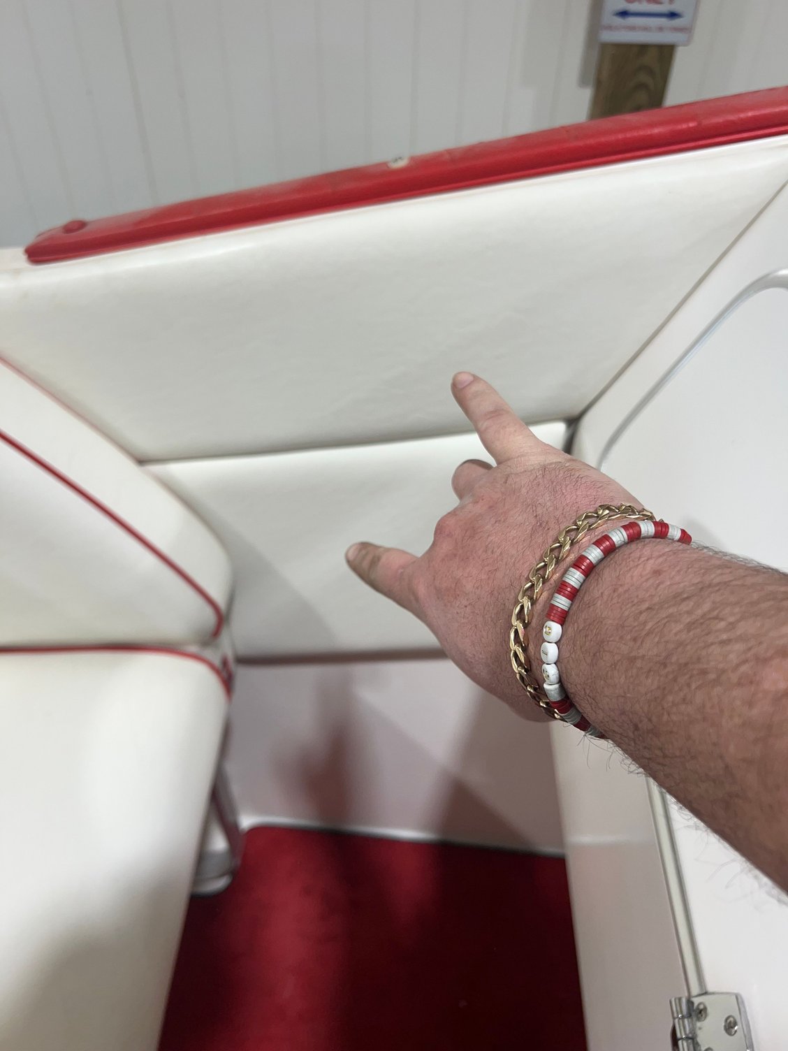

Alright…. How in the hell do these come off lol
87CigCafe is offline
Old 02-18-2025 | 11:15 AM
  #84
Posts: 2,095
Likes: 167
From: King george, Virginia/Potomac River
I think they are held on with little plastic "trees", at least that's how they are on my Bullet. Use a non-marring prybar used to remove a car's door panel.

Default Well…
Well here we are. Still waiting on subwoofers.

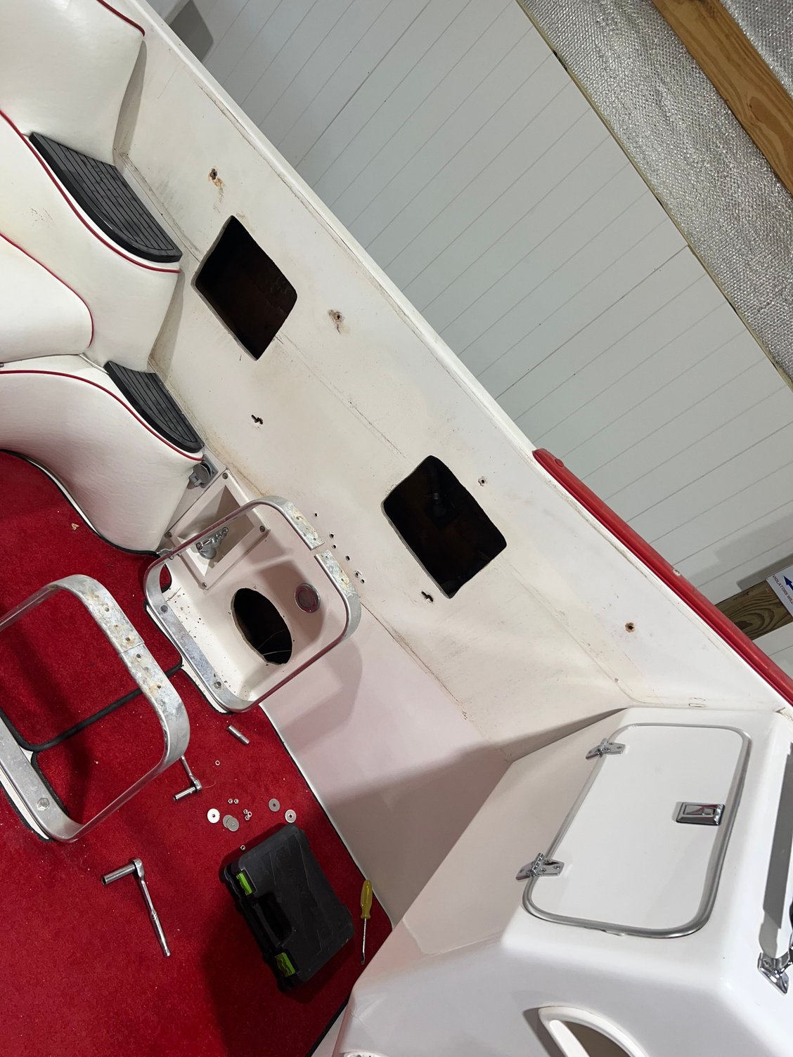

Default Maybe I’m crazy?
Maybe I’m crazy or stupid of thinking of this?
what if I modify the existing 6x9 hole to fit a 10 inch sub? I think it’s doable or am I wrong? It’ll sorta be under the seat.
then for the 6.5’s I could put them both forward of the sub about where your knees would be if riding in the boat?
I REALLY don’t want to cut up my vinyl. Will it sound like chit? I’m not worried about anybody outside of me hearing what I’m jamming to. We don’t have sandbars and stuff either so not looking to be the life of the party. Thoughts?
6.5 placement guesses?
Existing 6x9 hole im thinking I can modify to fit 10” sub?

Annnndddd now we are here. This escalated quickly. Gonna do it right the first time and be happy.
Side panels and seat out
87CigCafe,
You don't want the 6.5s are sharing a sealed space with your subs. They will trash your 6.5s and sound like sh!t while they're doing it.
Personally, I'd try to isolate the sub enclosure volume from the rest. I'd suggest something like THIS.
Thanks. Brad.
Brad Christy is offline

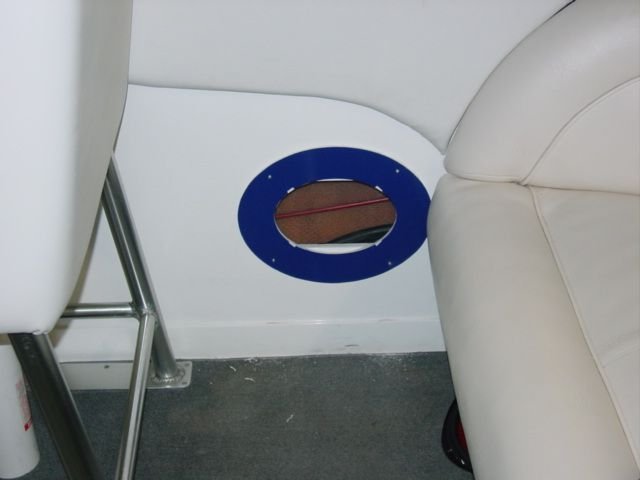

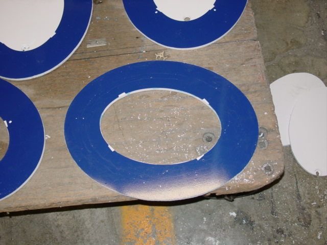

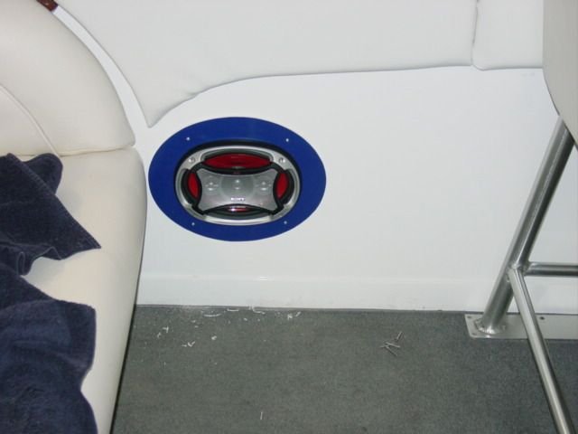

On my buddy's 28 Cig he had some crazy 6x10 square holes in the sides that he wanted covered up. Not sure what was there but no speaker or adapter we could find would cover it up. So we had some white plexy laying around...he had it covered in blue vinyl that matched the boat and i made some adapters for some new 6x9's Just get creative
-Wally
