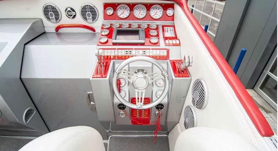

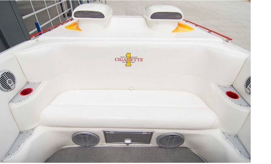

Set up in our old cafe 4 Fosgate 8” Coaxle and two 12” Fosgate subs under bolsters.
New gun has all German Maestro 10 6.5 coaxles and 2 10” subs in enclosures under the rear seat. Like I said earlier I wasn’t familiar with GM until we bought this boat. Did some research and was surprised by the pricing. $600 a pair for the 6.5’s and 1200 for the 10’s! 😳 they sound good though!

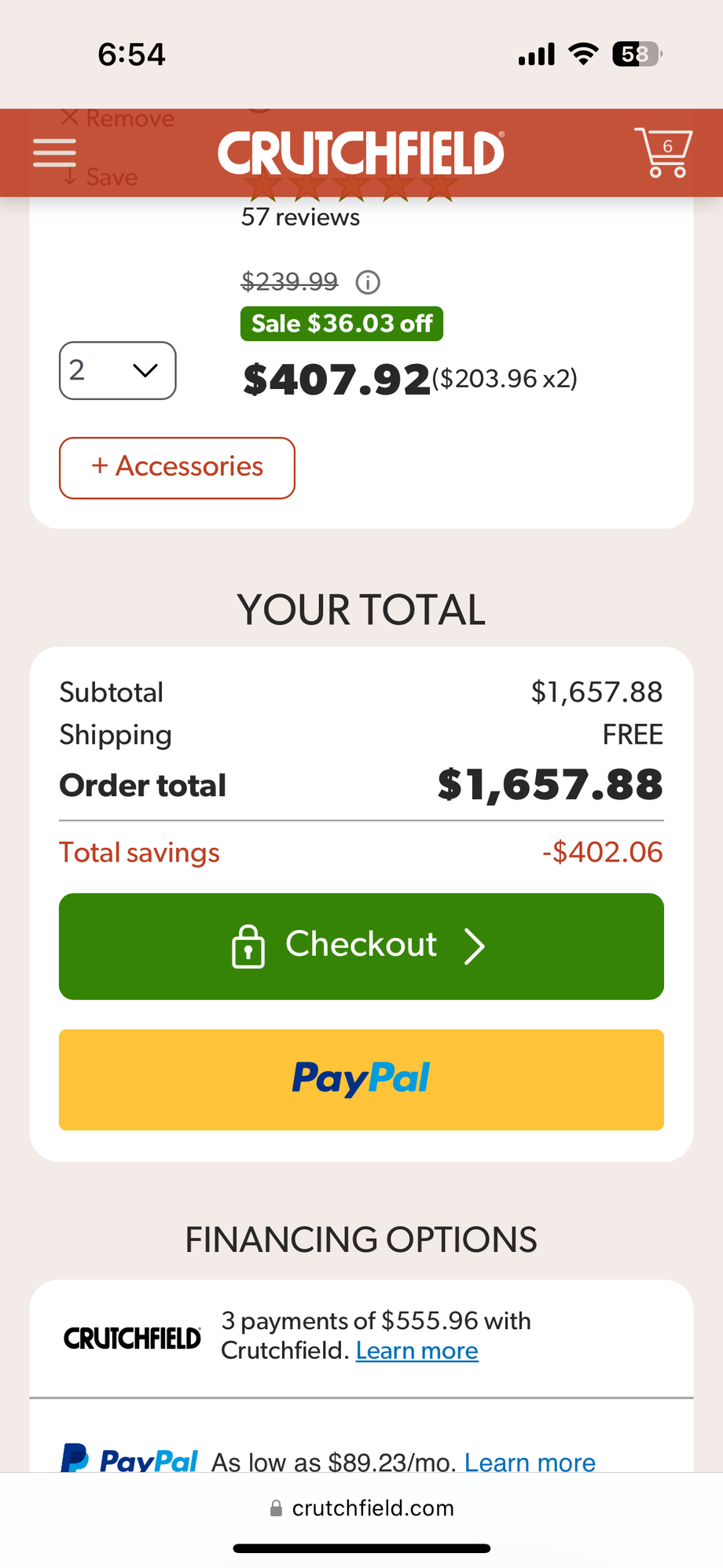

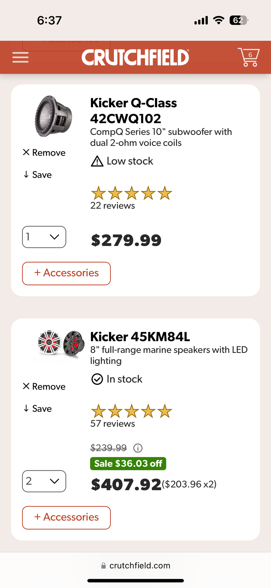

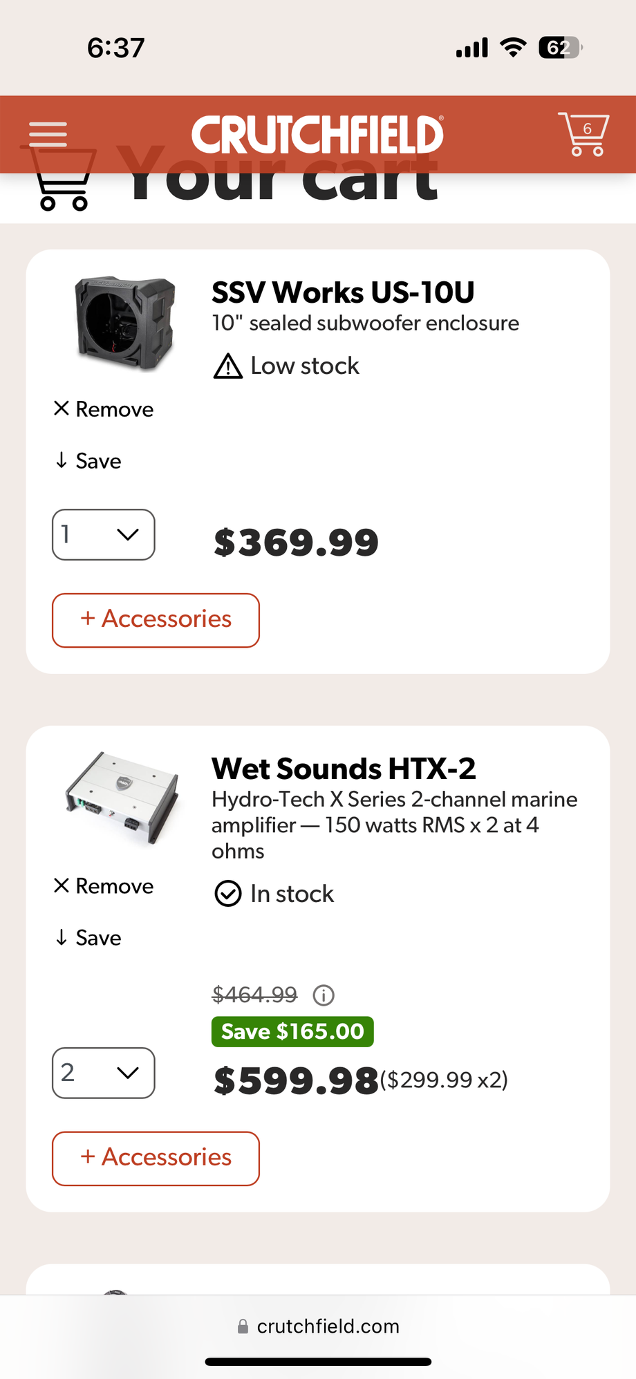

OP, here’s a cart I built for you that saves you $1000 and doubles your power. 1200watts rms on 2 amps.
4 8” kicker speakers
1 10” kicker sub in a sealed enclosure
2 wet sounds marine amps
You will want to dial the gain down on the 8” speakers as that amp may be able to blow them at 14.4 volts.
If you wanted to step it up some, and spend more, you could break the bank and run 4 JL 8.8s instead.
With a dual 2 ohm voice coil subwoofer you will wire the coils in series to make it one 4 ohm load. I can walk you through this or give you a diagram. You will connect one red terminal to one black terminal on opposite coils. Then you power the open terminals from the amp.
The 2 channel amp for the sub will be running with 2 channels bridged. This means you flip the switch on the amp that says bridge, and you run on red from one channel and one black from the other channel to the speaker.

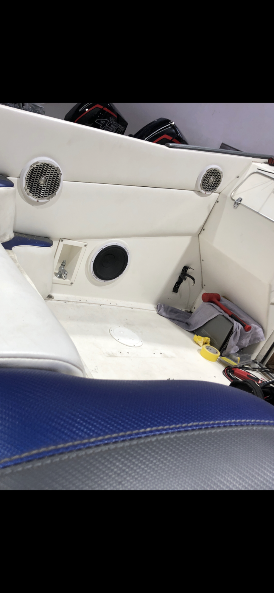

wow! That looks like a great set up as well. Where would I put the sub enclosure? We think it’ll fit under the back seat?
Bro I have no idea. I own a center console version of a cigarette 36’ wide body. You’ll need to break out your tape measure. Completely enclosing it under a seat with no venting will hurt you a bit.

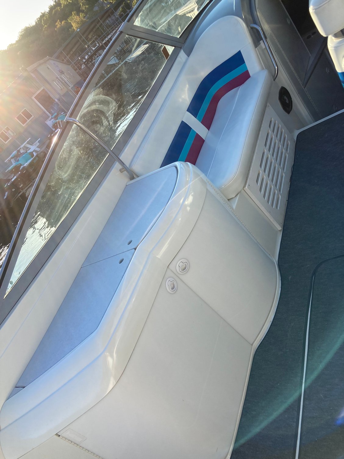

I guess that’s more of the lines of what I meant to ask is putting the sub in that enclosed box under the seat gonna be a bad recipe ? Sorry lol
87CigCafe is offline
Old 02-16-2025 | 09:05 PM
  #79
Posts: 3,871
Likes: 798
From: St. Pete Beach, FL

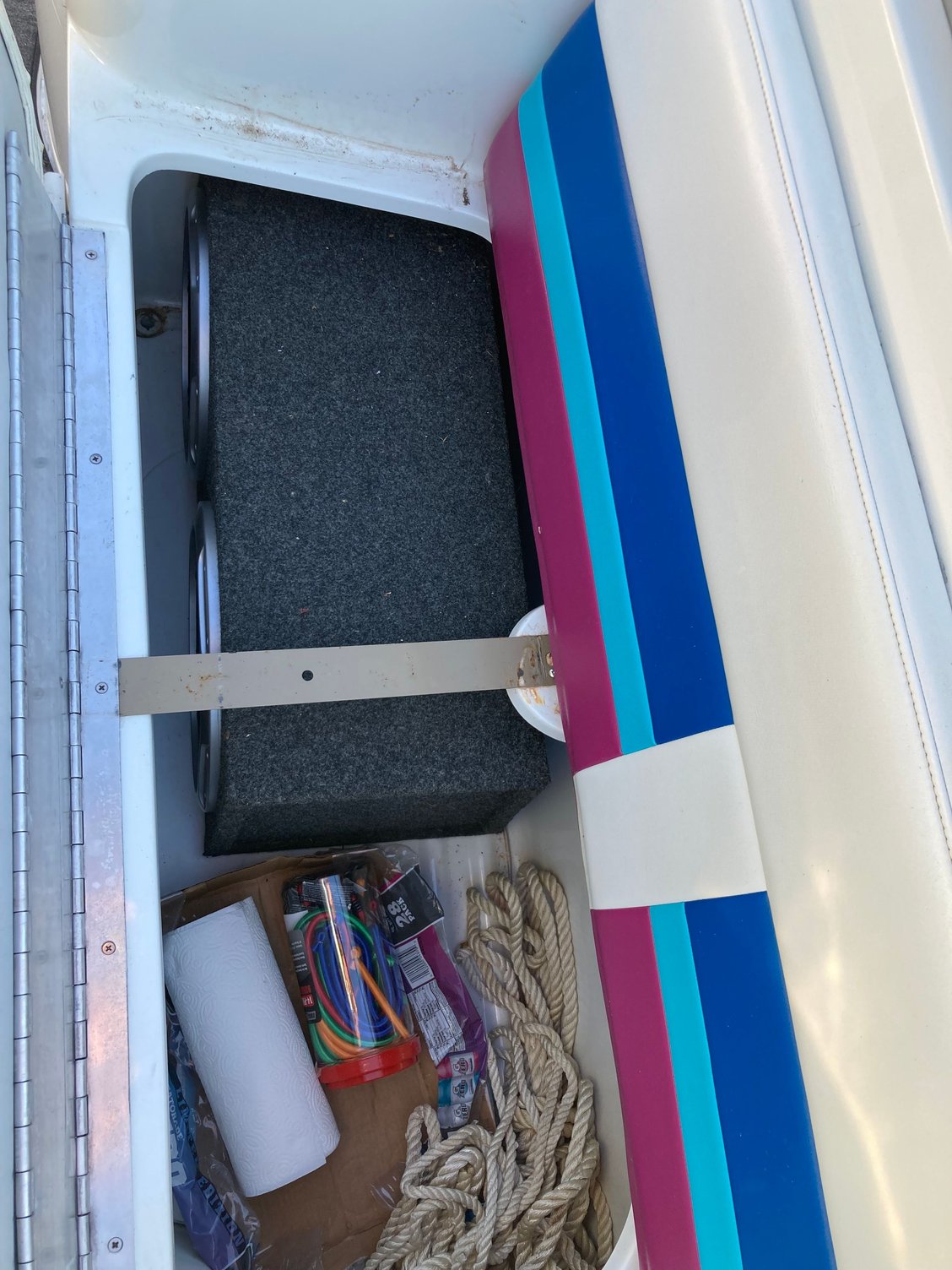

If you could space the seat up a little bit so there is a gap it would help a lot. You could play with it.
My formula had this grill built out of marine lumber by the previous owner probably professionally, it was nice.
I was able to squeeze a prefabbed box with 2 12s. This was a budget setup, lots of stuff pirated from my friends basement. Sounded awesome with 600 watts in a bigger cockpit than you’re working with.
I didn’t buy any marine amps either, just cheap kicker car stuff. Wasn’t ever a problem fresh water boating at lake of the ozarks.
