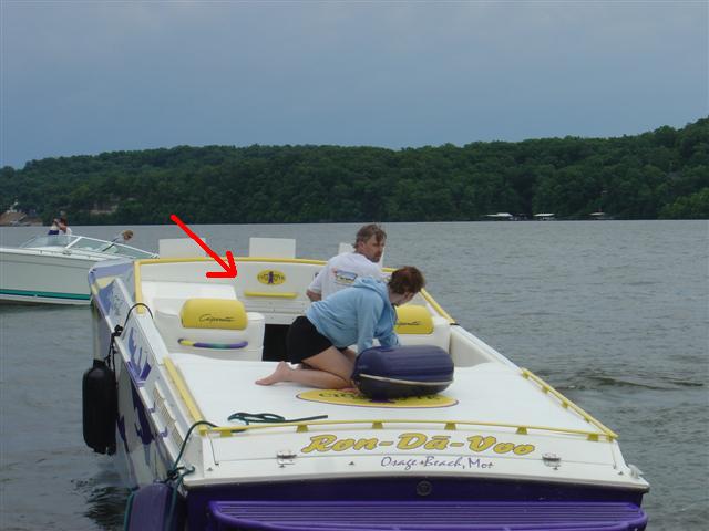

This Panel?

Just did it this winter. It is attached with door panel retainers also known as "christmas trees". You have to carefully pry off with a wide screw driver or door panel tool.

There are also two nuts that hold the grab handle studs. You get to them from inside the cabin.
Thanks, Barry
