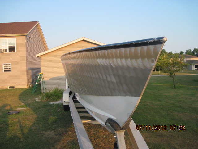

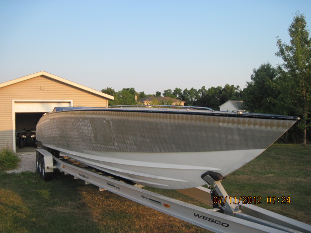

Started refinishing the sides. Slowwwwwwwwwwww Process!

Gives new meaning to "that'll buff right out" ! Wow ! Looking good !

Few ripples and war wounds but that keeps it true to it's days.
