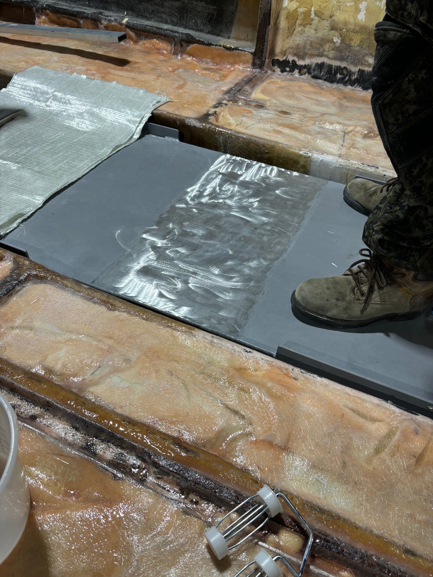

We added two 3 inch rig tubes and used 2lb pour foam then a layer of thin chop mat to seal off these unused compartments.

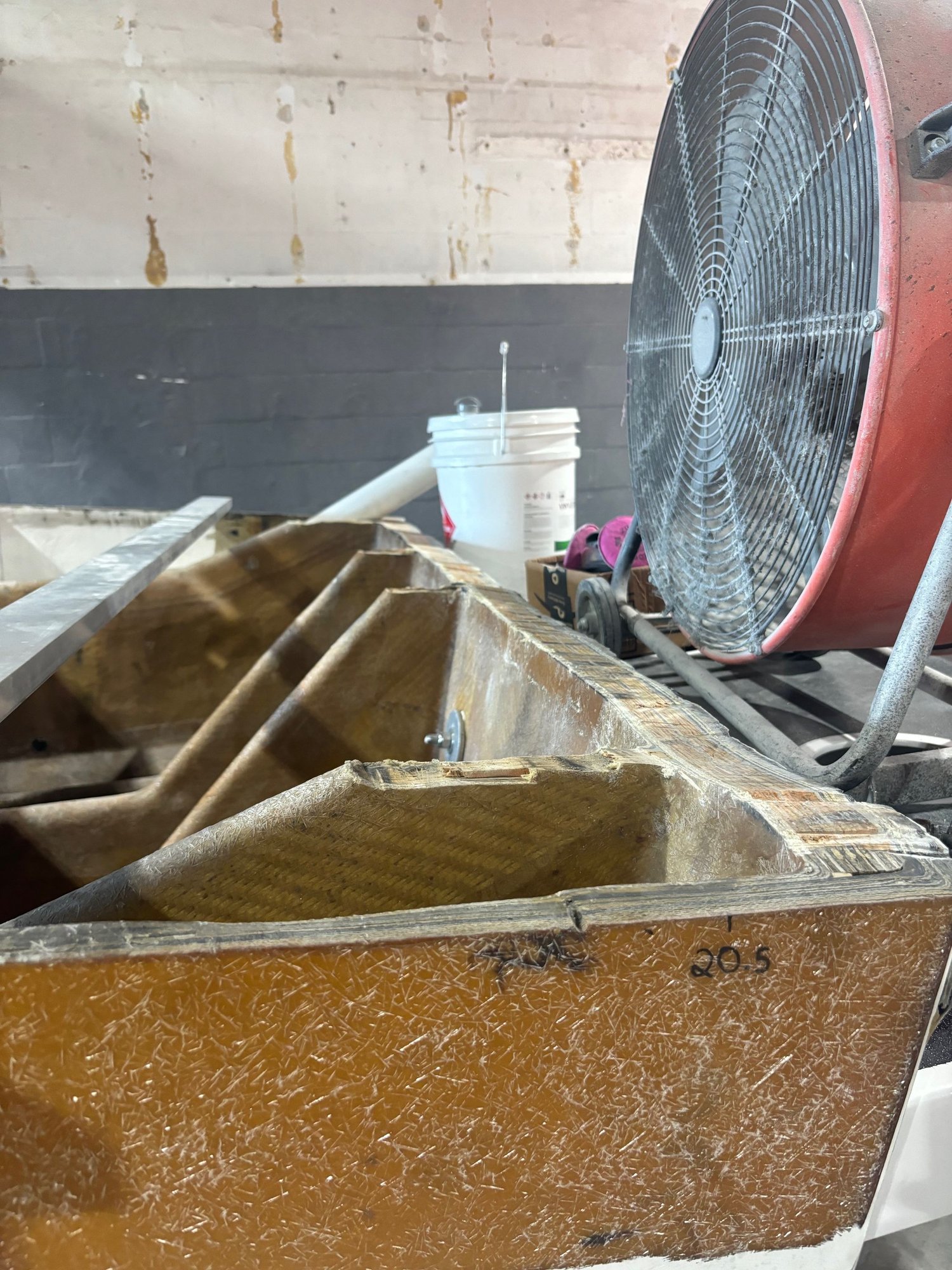

From the mid point of the hull forward there is no core in the hull sides and it is solid kevlar and carbon.

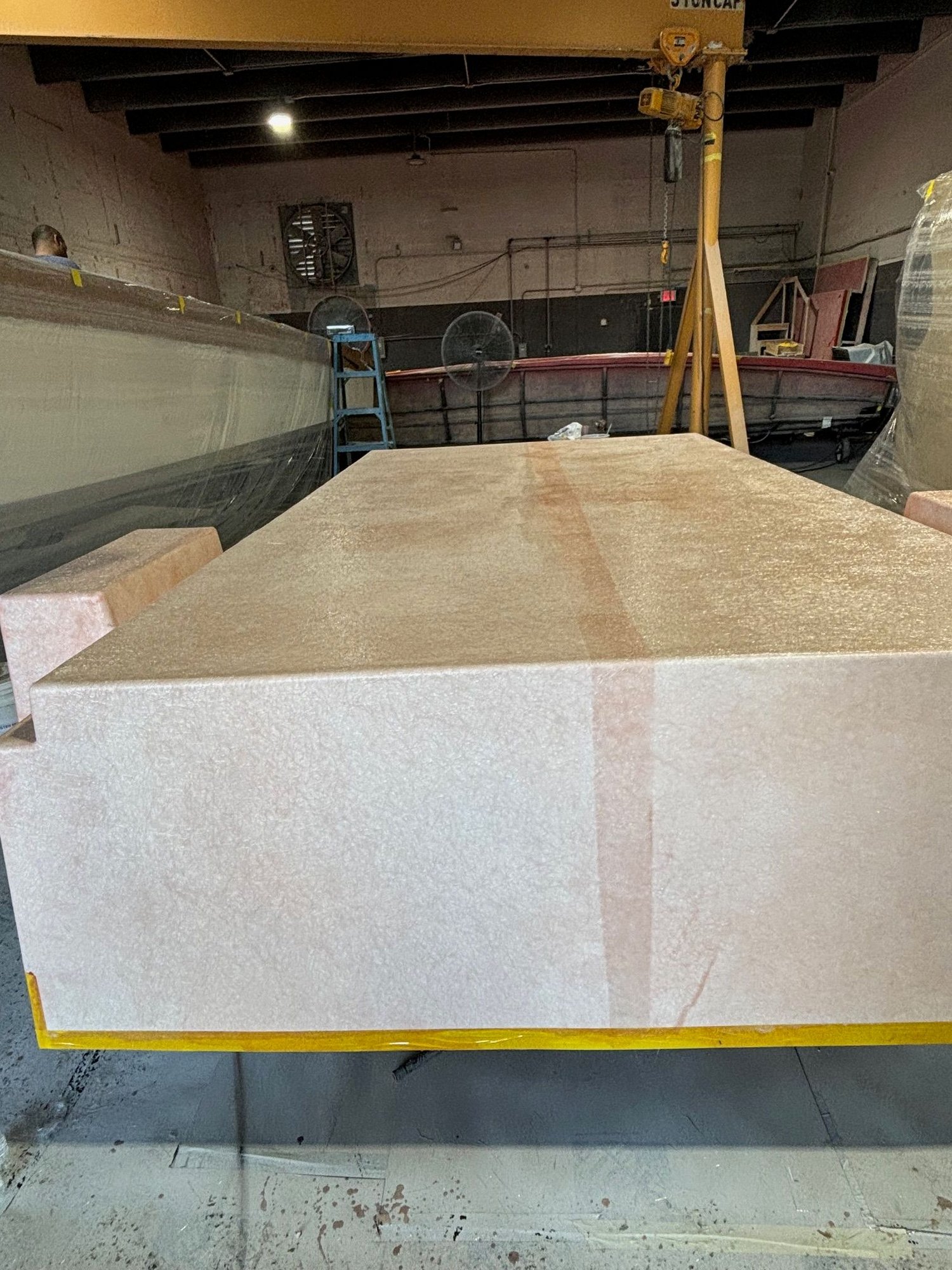

The epoxy/e-glass cockpit part, extremely lightweight.

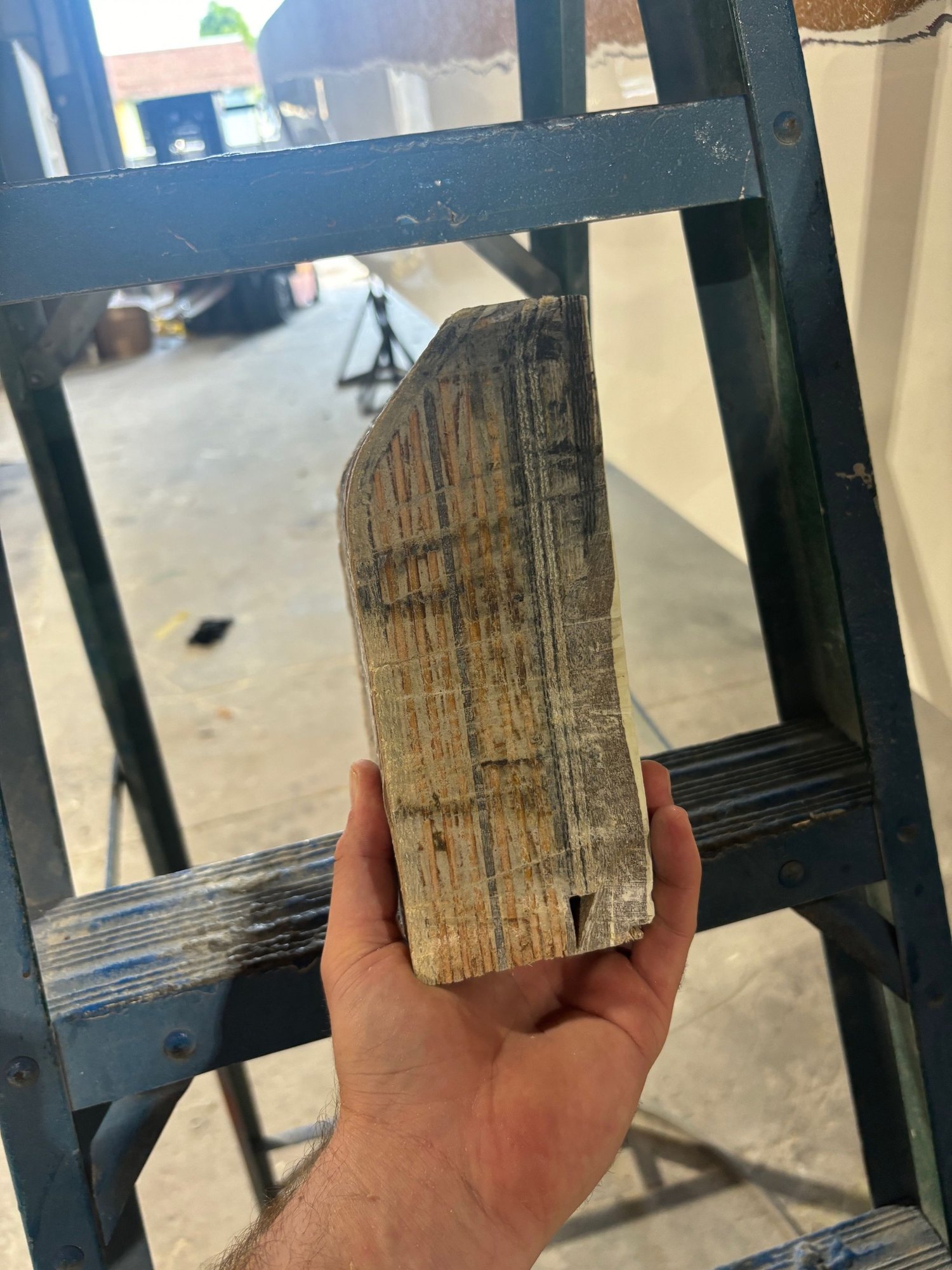

Chunk of transom.
Chunk of transom.
