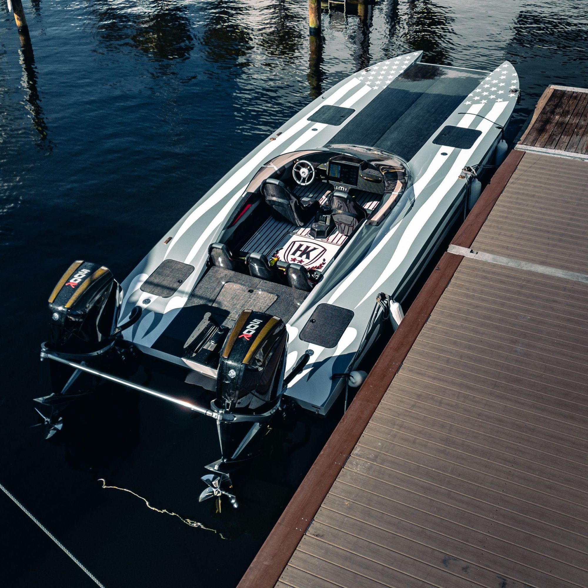

It was a choice to switch to outboard so the boat is much more usable. Simplicity of service on the outboards and the cockpit is much bigger now for comfort as well as fitting six people in seats rather than standing. The owner lives in Naples and will use the boat to go from there to Key West with friends on weekends.

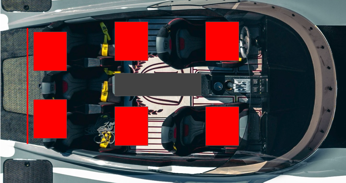

I don't but here is something to give you an idea, I am taking the windshield receiver, dash, console, and seats we use on our 32 widebody model and adapting it to work on the Apache with the rest of the deck being a flat deck. I will extend the cockpit slightly to make room for a 2+2+2 seating layout. I also plan on extending the center console to reach back through the second row of seats for mounting speakers, cup holders, and grab handles.

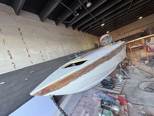

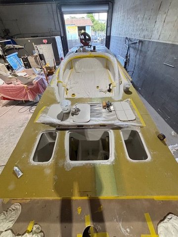

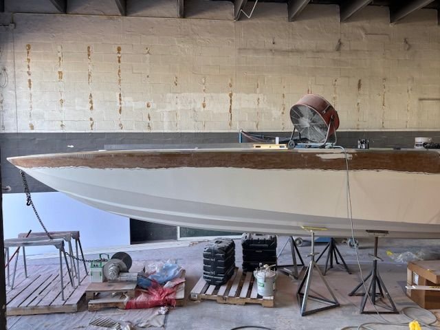

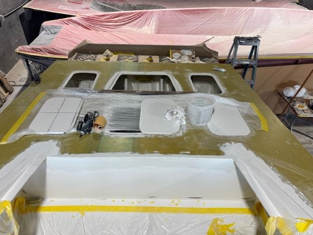

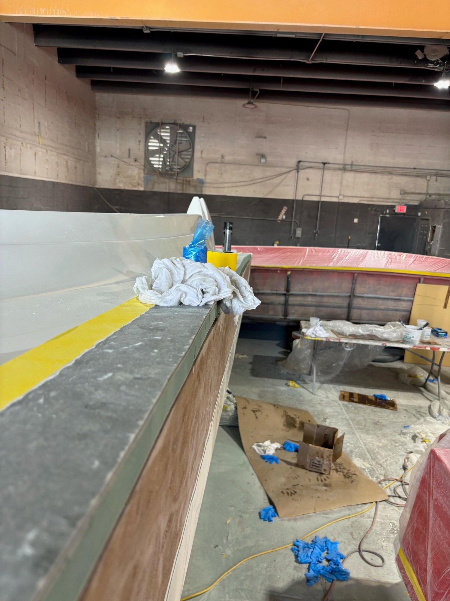

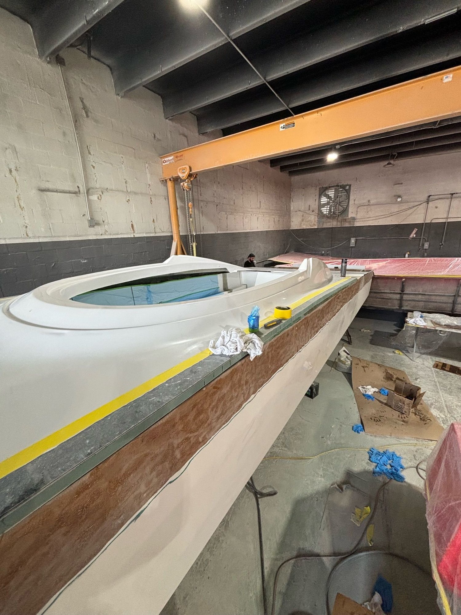

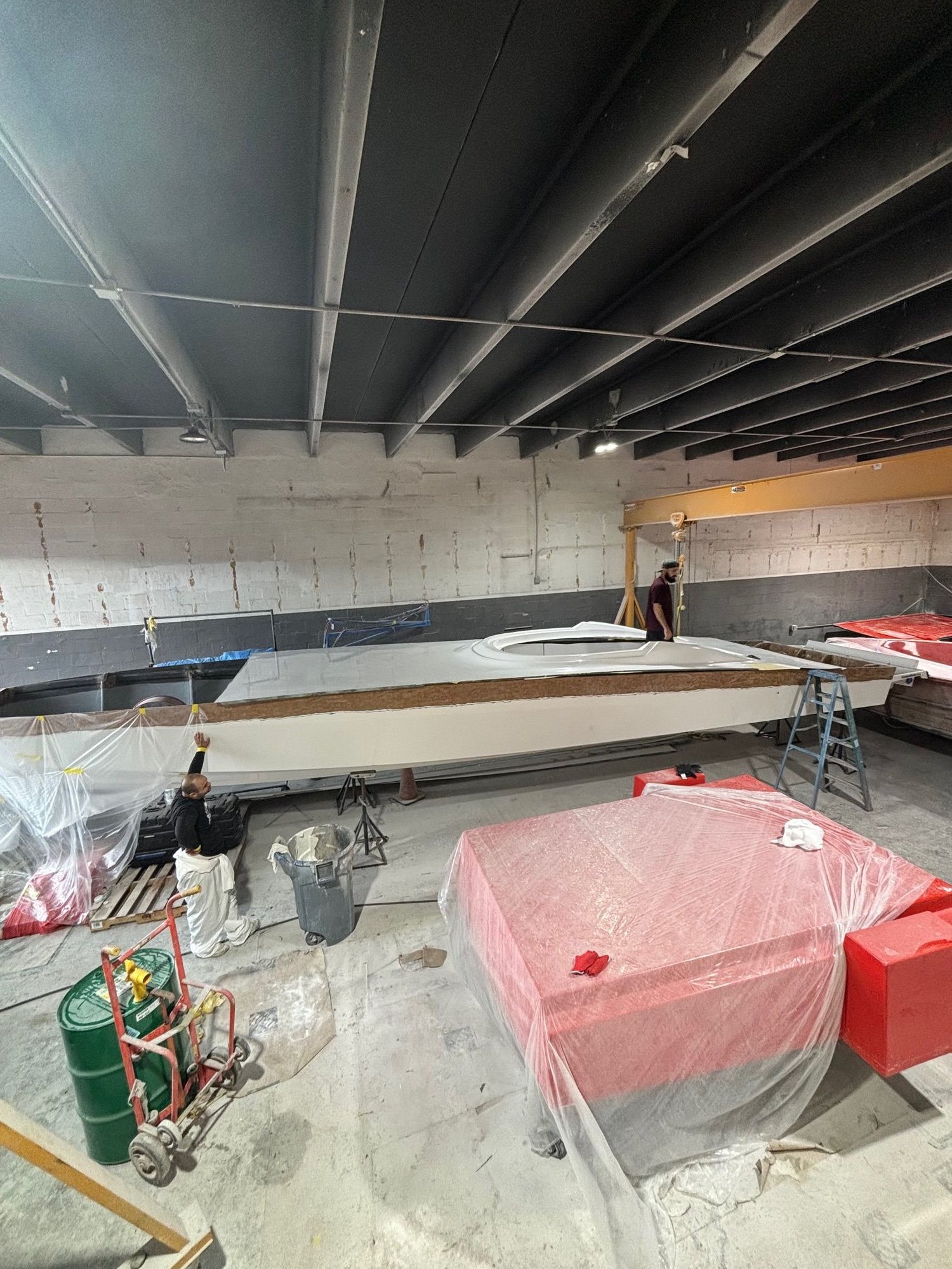

We recently got the main portion of the deck put in place on the Comanche. The windshield receiver looks great on the hull and the proportions front to rear as well as the spacing on either side is spot on. There is just enough room to walk past the receiver and to the front deck. We also placed six seats in the cockpit to confirm that the legroom is there and it is comfortably spaced for the 2+2+2 seating arrangement. We laminated the inside of the hull to the deck with proset epoxy and a quad stitch fiberglass and will do the same to the outside once the front piece and rear piece are added and a radius is routered. Before putting the rear deck portion in, the hatch openings are being cut and the boxes attached. We also are putting the cockpit drains in before the rear deck and have that draining into the bilge.
The extended cockpit ready for 6 bucket seats.
The finish work for the cockpit is starting to fix the seam and fix the flat panels we added to the sides from removing the storage boxes.
You can see the proportions of the boat. I really like the long flat bow.
Laminating the hull to the deck with epoxy.
The outside edge of the hull will be routered to have a radius and glass lamination added before final finish work.
There is just enough space for walking up to the bow.
