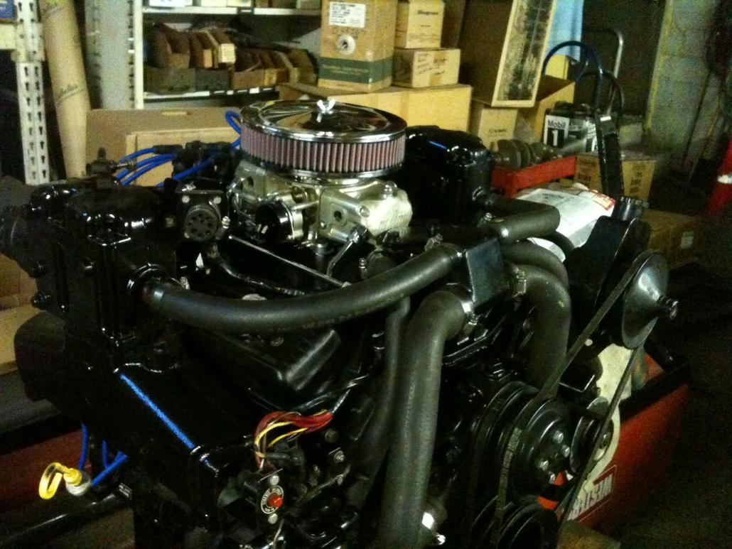

Default final assembly
here it is pretty much complete. only thing left is fuel lines and wire the choke but that will be done once its in the boat

Putting this thing in on Sunday. Got my fingers crossed! Hope it runs like a raped ape

It took a little longer to get it running than I planned but it finally is in and running!!!! Gotta run it a little and dial it in but for the most part sounds really good. Had a bell housing and coupler clearance issue and sprung a fuel leak on the cheap chitty dual feed fuel line I bought but other than I can't complain. Stay tuned for a YouTube video of the first start up.

I hope for your sake, that is a roller cam in that motor. Non roller cam needs 1500 rpm break in for about 20 min. with a break in oil...... sounds good.
