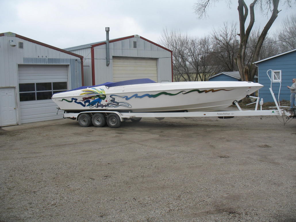

Just got the boat back from getting some paint work fixed, Looks good now if spring will grace us with it's presence.....
Attached Thumbnails Finally pulling the trigger-001.jpg   Finally pulling the trigger-002.jpg
