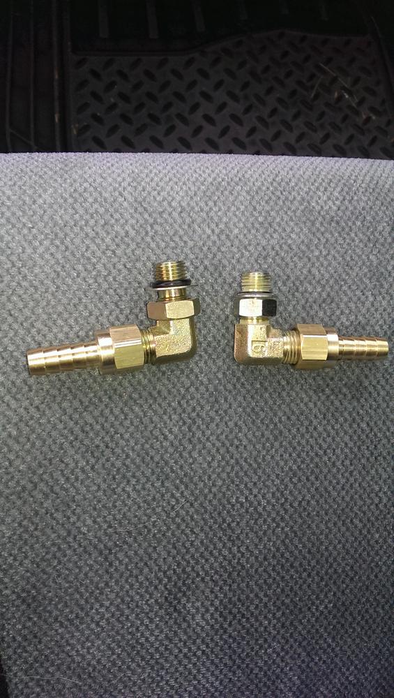

One more option to add: i have used this once so far while the engines were on stands in my garage, see pic. there's no tube going down into the pan, the hose is attached directly to the tube. When installing the engines I used the fittings in the second pic and ran each hose to separate ball valves mounted on my center stringer. The port hose, after the ball valve, then runs and joins the stb hose with a brass barbed T fitting so all i have to do to drain is hook up pump to one hose and just flip the ball valves one at a time to drain both motors. Only at around 10 hours so far so haven't tested it yest but so far no leaks. Here is the pump i used, http://www.harborfreight.com/12-volt...pump-9576.html I know it sayd not for oil but when looking at the schematic of the pump it looks pretty easy to rebuild.
[ATTACH=CONFIG]526219[/ATTACH] [ATTACH=CONFIG]526220[/ATTACH]
Attached Thumbnails Oil Extraction System-oil-pump.jpg   Oil Extraction System-fitting.jpg
