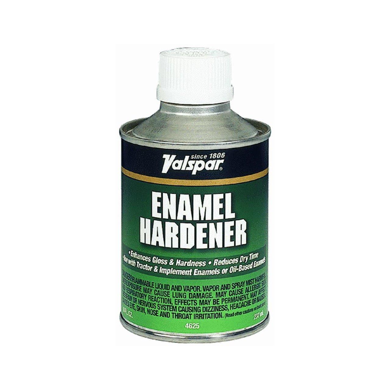

Originally Posted by f_inscreenname
Rustoleum but you must use the enamel hardener or it will stay tacky forever.
http://www.amazon.com/Valspar-4625-E.../dp/B000LNY1MY
If anybody needs the valspar enamel hardener I have 5 extra................$18 per shppy included !! [email protected]

+1 on the Rustoleum/Valspar. Looks great and very shiny...slipped and fell a few times while re-rigging the bilge, lol. My experience was slightly concerning with how thin the paint/hardner mixture was. I was covering bare glass and old gray gel (all sanded thoroughly) and at four coats I called it quits but I probably could've done six for better coverage. I did mine in an off-white color and it does show everything! If I were to do it again I would consider a dark color under the motors and white everywhere else to keep things bright (my wife says I need help 'cause I vacuum the bilge regularly). Again, still looks great and cleans very easy. Good luck.
