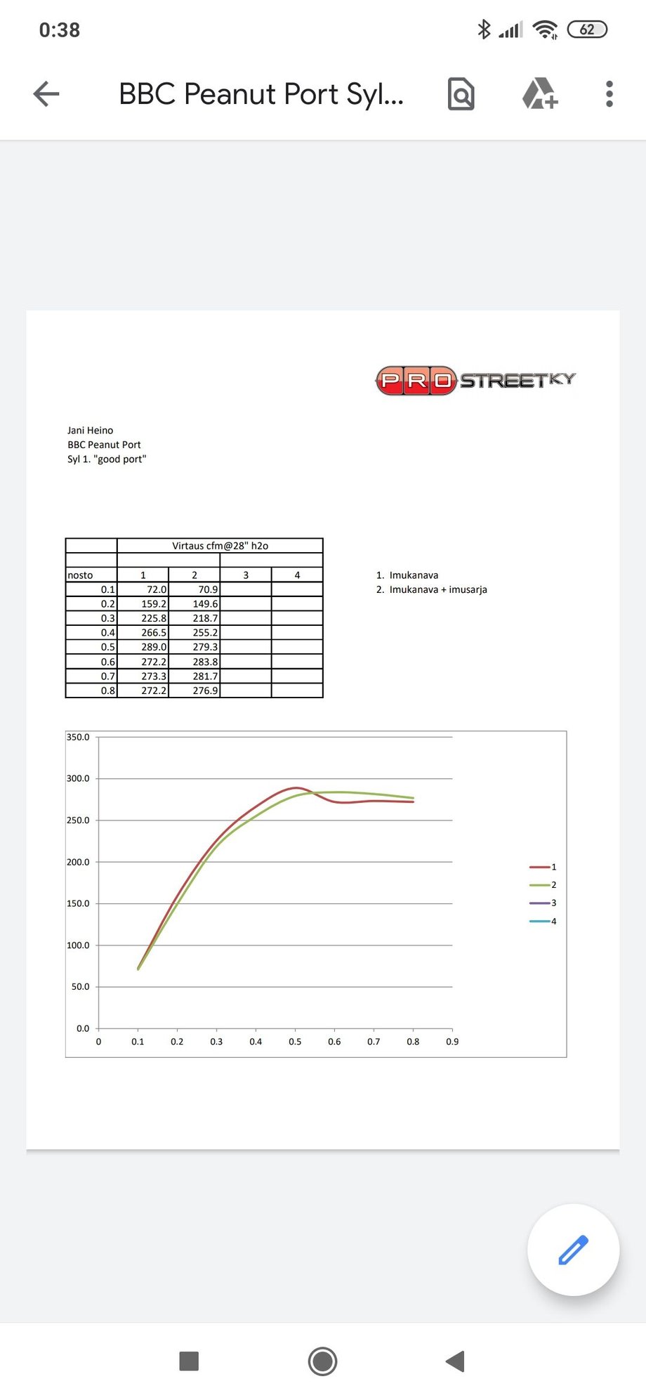

Heads are ready and the final flow tests are done, with and without intake manifold. Intake is weiand 2123 street warrior. Number 1=head flow, 2=head with intake flow, 3=exhaust without pipe.

Flow Numbers and engine specs are sent to Chris Straub, and hi will grind hyd roller cam. Cant wait to get the cam specs.
