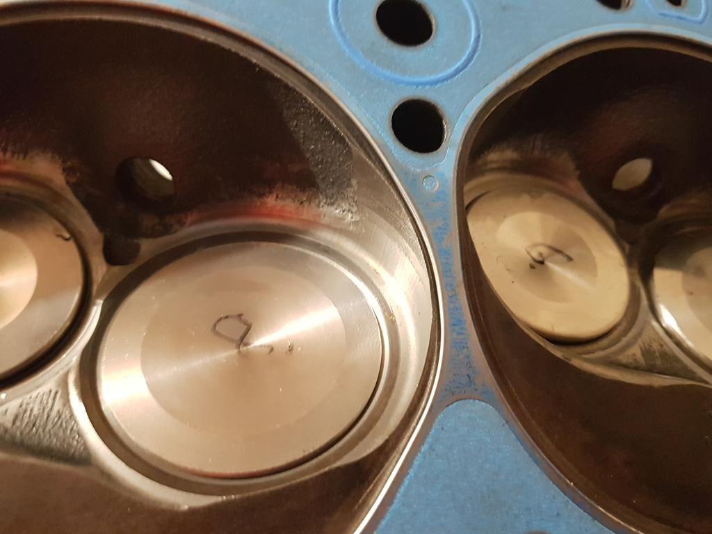

youd be better off selling the short block and buying a clean 330. And bore notching a 509 with those heads is a waste of time. This combo won’t make power past 4200 rpm
first plan was to instal 2.19" intake valves, so we did radical valve unshrounding to the chambers. because the flow was enough to reach my goals even with stock valve size, we did not go with 2.19".
before notching the block
felpro 4.66" bore gasket on the head
same gasket on the block
