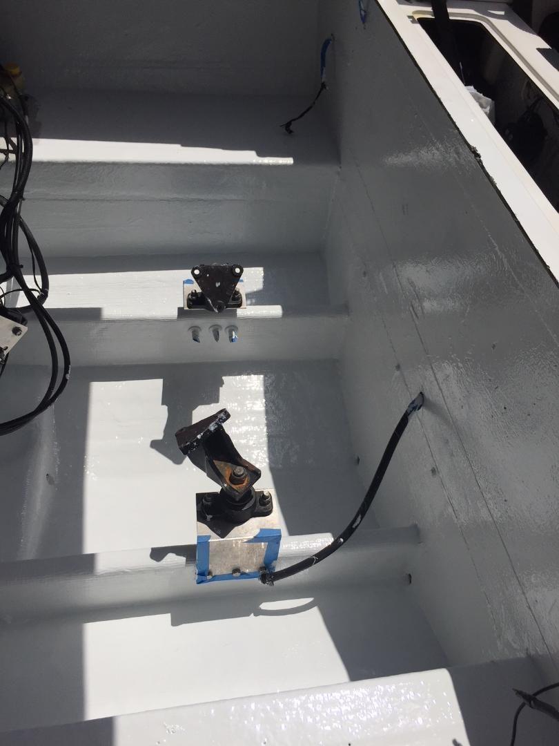

i used total boat bilge paint turned out great have two years on it looks like new
