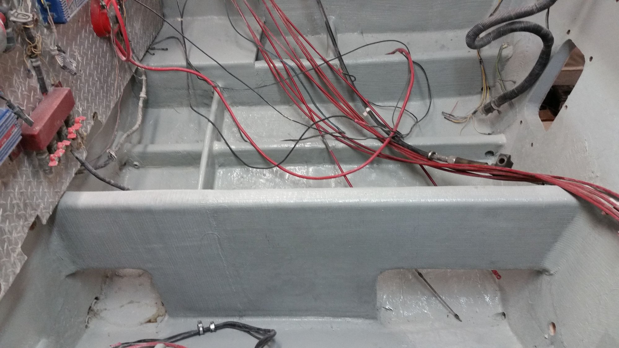

I used the sherwin williams macropoxy and am very happy brush or roll on goes on great flattens out no brush marks 1 coat. Gal of epoxy and gal hardener about $200. Enough to do 2-3 bilges
