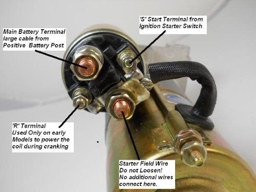

typically the starter solenoid is mounted on a bracket at the rear of the head

depending on engine it can be mounted in frt, over fuel seperator, or in the rear to the sideof distributor area.
You can also follow the yellow/red from Starter terminal 'S' (smaller terminal just to the right(block side) of the big + terminal.

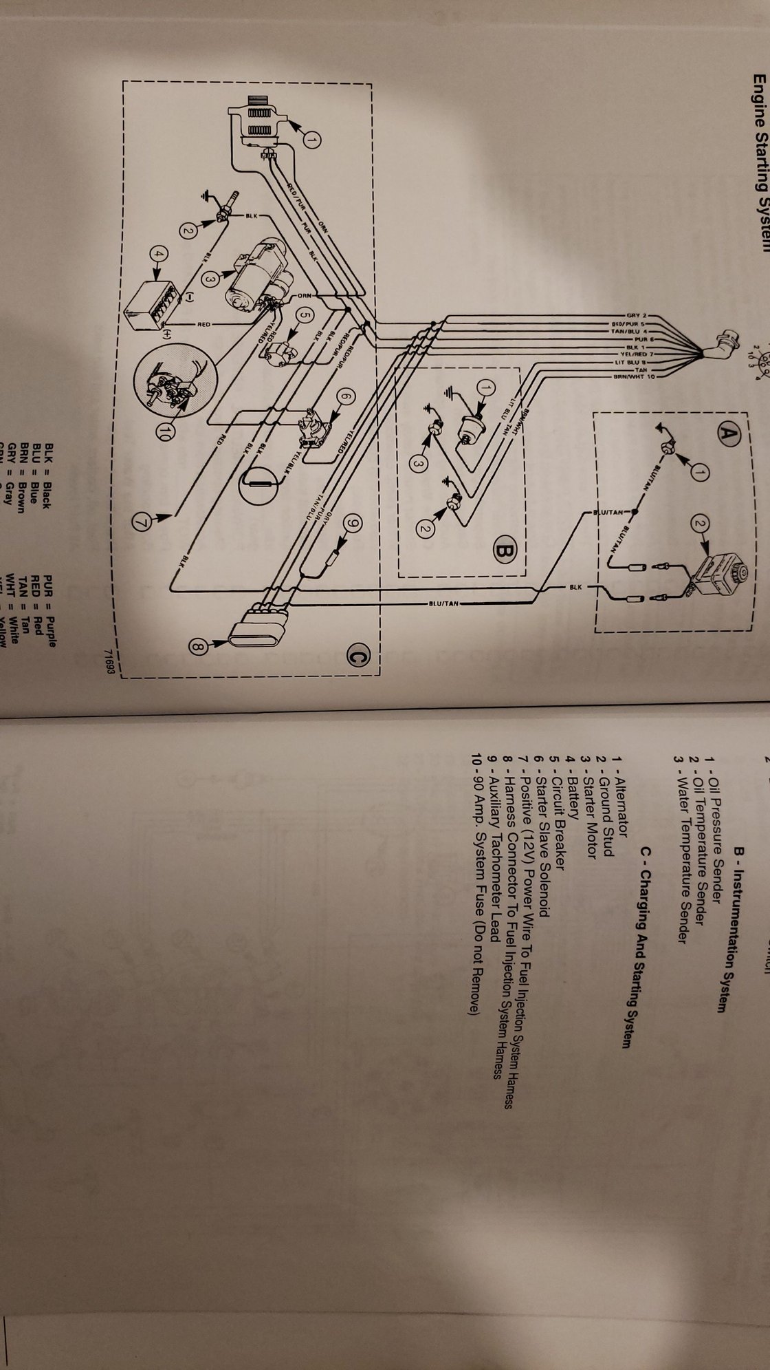

Wiring is good Key to signal power out of solinoid

it cranks and wont fire. When you let go of the key -returns to the on/run position. It will stumble a few times as if it where running
Have fuel have spark have air. Was running on dyno not long ago. Nothing on the motor it self has changed. Only new things are fuel system. Cannon plugged into the rest of the boat Ecu is mounted to the boat. And running off boat batteries Confirmed charge is good and had a booster on it well cranking

where do I test to see this. ? This would be the yellow/red wire I'm guessing?
I have a starter solinoid relay on order just to be sure. It's a P IA to get at so I think I should replace it to be 100%

If the motor cranks over the yellow/red wire is fine.
