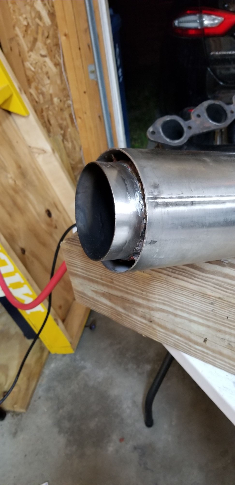

My headers are supposed to he silent choice, they just dont have the diverter attached anymore. So my water dumps into the tails through 12-15 small holes right at the collector. The tailpipe inside tube slides inside of the header exhaust tube and the water jackets are connected/sealed via a 5" rubber hose that slides overtop both header and tailpipe outer jacket. Without water entering the exhaust right where it does, I fear I would burn up that rubber connection hose. The fitment between header and tail exhaust pipes is my issue, it's very loose and leaves a gap that high temp silicone cannot fill alone and that's where my reversion is getting the water from.

Head with water jacket outlet holes immediately after the collector

Jacketed tail
