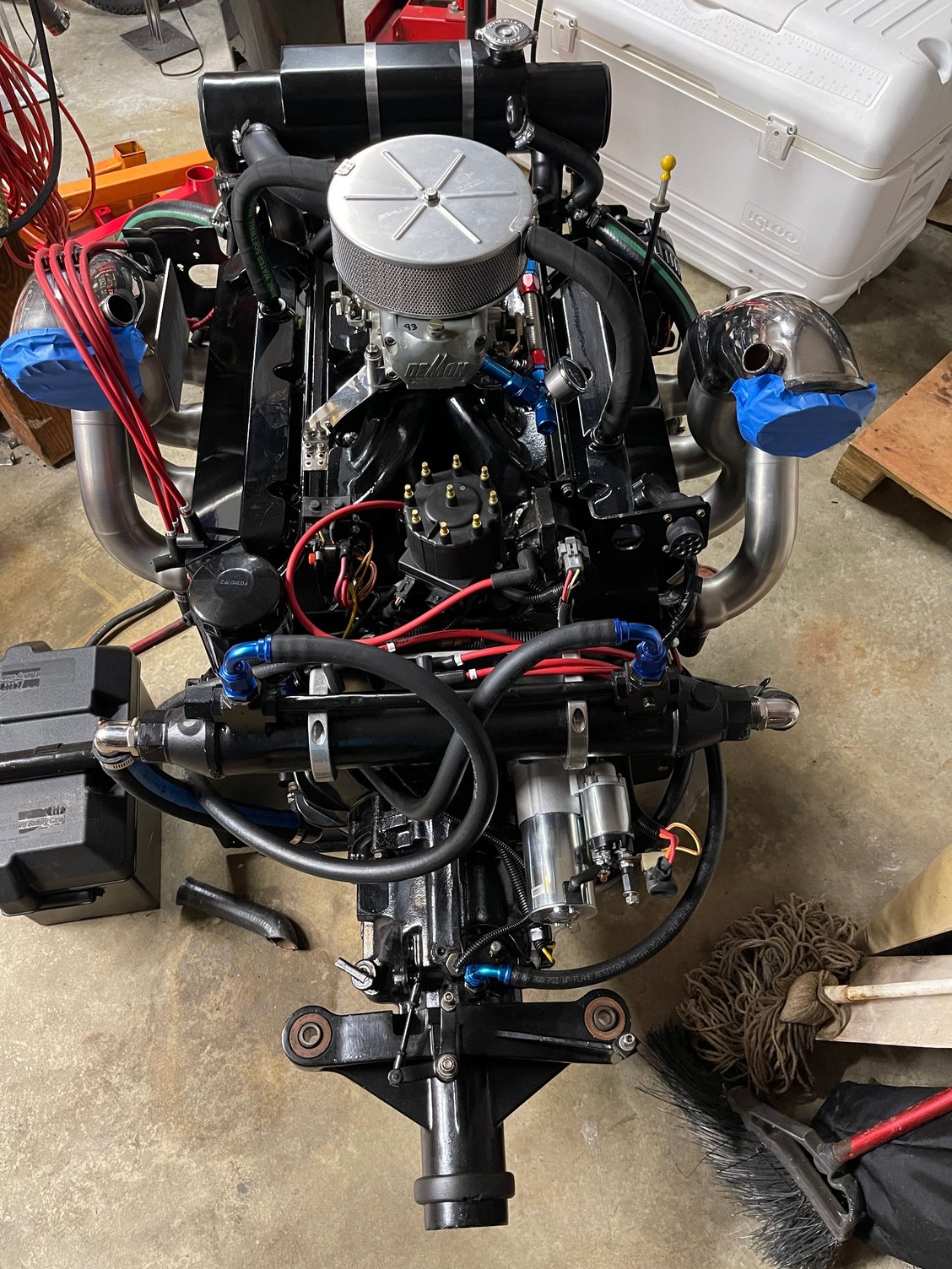

This is how I set mine up. Similar to Rookie’s.

Filter heads on yours will be an issue to deal with.

I made the bracket out of 1/4-inch plate. The cooler is an older CP Performance piece with a built-in thermostat. It’s soec’d to handle 700 hp. The tube brackets are also from CP Performance.
Regarding your filter heads, I guess you could OffshoreOnly the cooler a good amount to keep the end of the cooler away from the filter. I wanted it centered on mine. As seen in the pic, I used an HP4 filter head that sets the filter up vertical. It all fits together really well. But I’ve seen others where the cooler is greatly offset. I didn’t have the room to do that with my boat.

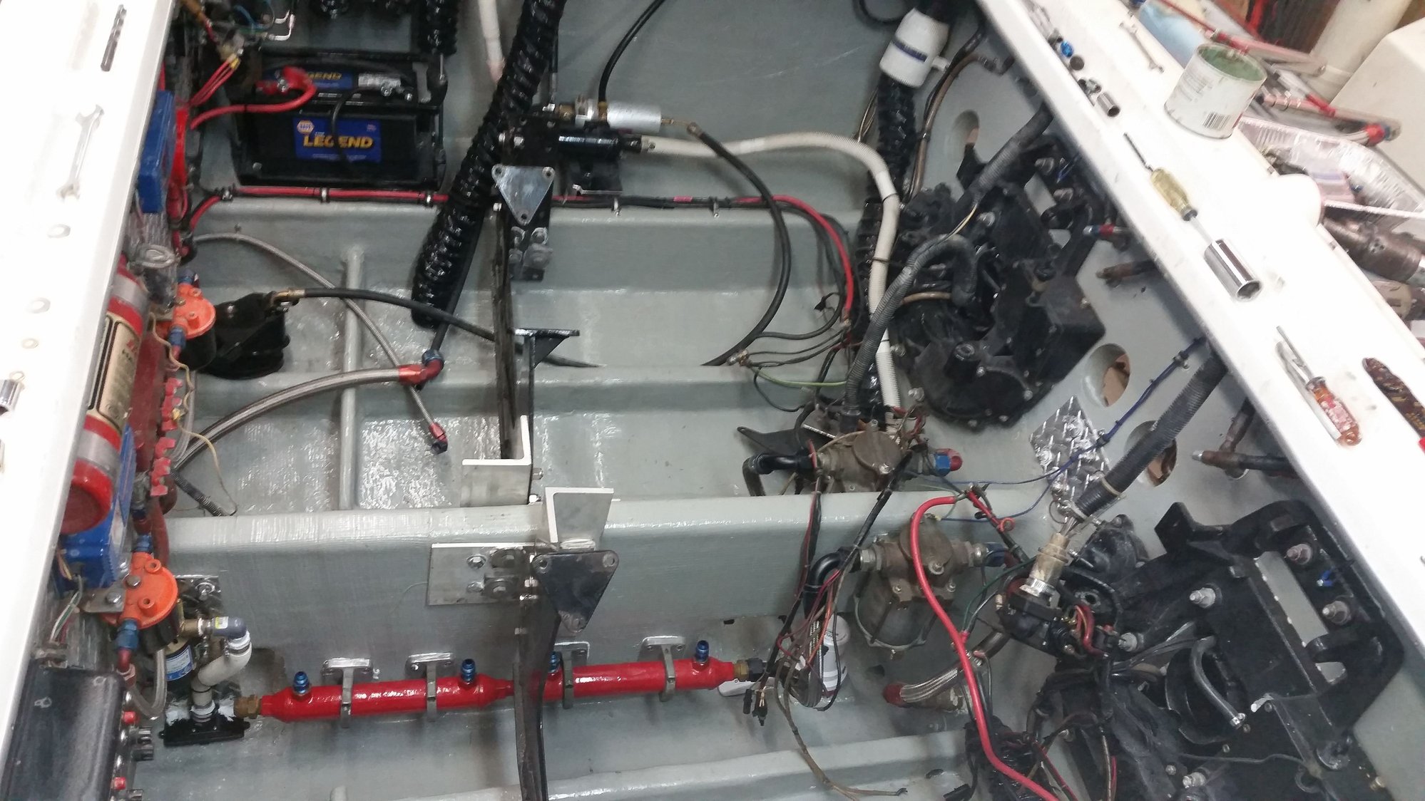

mine was all plumbed together in straight line mounted to stringer,,,worked great till now,,and i honestly dont think i can get coolers out,,without pulling motor.
have to look at it more.....old photo old cooler,,but same location..
