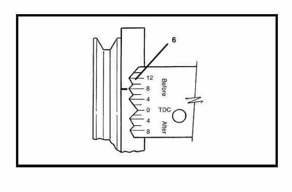

Old 05-23-2022 | 09:27 AM
  #33
SB
Joined: Nov 2004
Posts: 14,154
Likes: 3,714
From: On A Dirt Floor
If your timing tab looks exactly like this, thrse are the btdc #’s vs indentions
Don’t pay attention to that 6 poiting at timing tab. That’s a reference to just the timing tab itself for that page in the manual.
SB is offline
Old 05-23-2022 | 10:00 AM
  #34
Joined: May 2022
Posts: 258
Likes: 90
From: Croatia
Yes that is it...the big gap is 0 so i put mine betwene 8-12...but i felt it when rpm started to raise...the other engine does not have that but it von't response when i turn the distributer...no rpm raise
