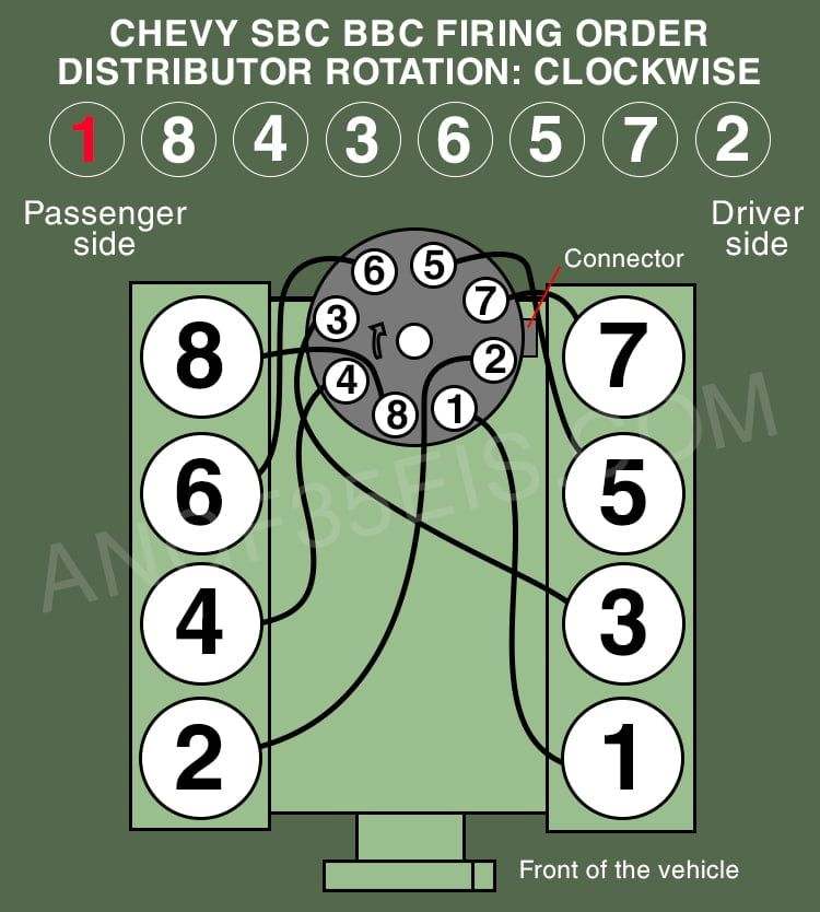

can i ask you for advice..it is regarding the mercruzer 7.4 i can't get it to work...i have a new simptom..every other cilindar is respondind on a drop cilindar test...so the 1 is responding the 2 is not the 3 is the 4 is not and so on...is that a simptom for somthing...tnx

what do you mean drop cylinder test, how is this being performed
i turn on the engine and then start tu pull off cables from spark plugs and listen to the engine change rpm...on 4 cilinders he does not change rpm..

do you have it wired like this
jes i have the firing order on the manifold....and it is a mercruzer
problem solved...it was the carb
