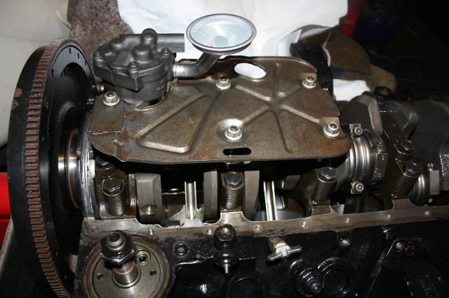

Hi
To install a Melling 10778 pump
however, the Mercruiser gasket OEM FI5000254 is no longer available !!
Do you have any interchangeable solutions ?
Thanks

Originally Posted by bajalux
Hi
Thanks
You should not need that gasket with the Melling pump.

Originally Posted by Tartilla
If the pump and main cap surfaces are good, there is no real benefit to a gasket...but you can source them...not that expensive. Just search for BBC oil pump gasket.
The gasket he is talking about is on the pump itself. Between the pump body and the 5 bolt bottom plate. Mercruiser used a gasket there. It is the same as the Melling M77G pump. I think the pump with the gasket was originally specified by GM for truck and industrial engines. You can get them from Melling directly if you really need one.

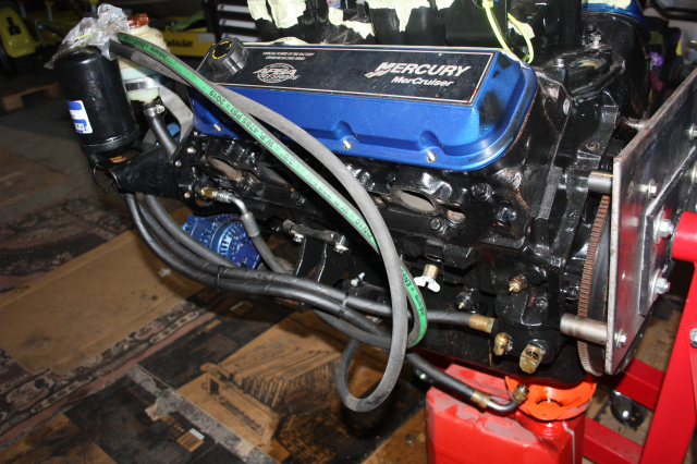

Hello
The engine has been removed for repairs
The pushrods and camshaft habe been disassembled...
But the damper pulley was difficult to remove !!
bajalux is offline

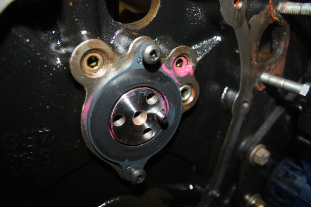

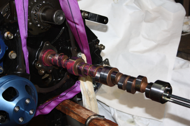

Hello
After the cold periods, I work again on my engine
I installed a Melling 10778 pump with the standard spring.
Question : Should I install a larger capacity oil pan ??
I also installed the new camshaft ( Teague )
Question : To what torque (N.m) should I tighten the 2 camshaft locking bolts ??
No information in the Mercury manual # 6
Thanks in advance

Hello
With the Melling 10778 oil pump which has 25 % more volume,
should I install a marge oil pan like Canton, Milodon ??
Thanks in advance
