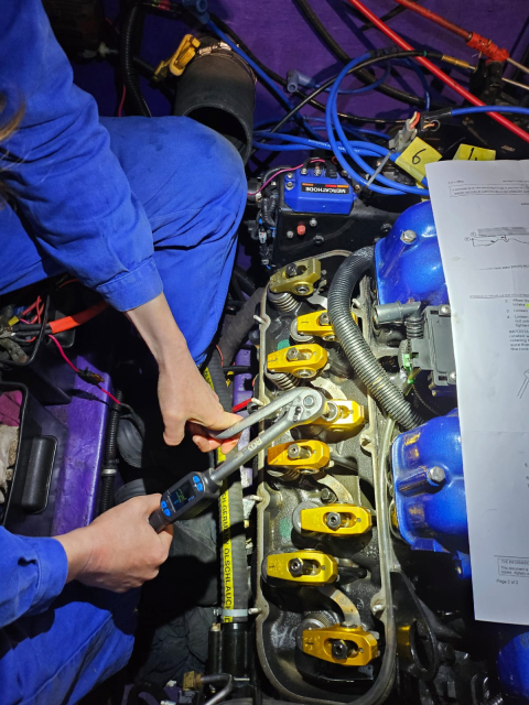

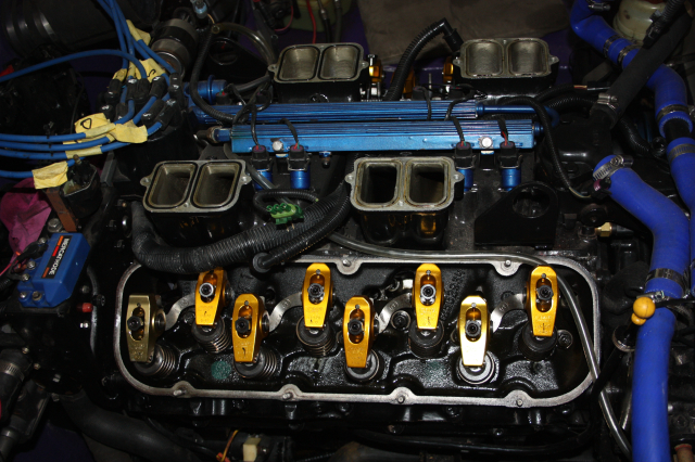

The valve adjustement was done according to the manual n° 6
It remains to reassemble to start with the water pipe ...
I hope that will be sufficient

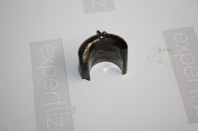

Hello
Bad news
I found this little piece with a magnet !!
I'm afraid to discover the rest when I dissamble the intake manifold !!

Is that half of a valve stem keeper ?

Thats really tough to figure out. It really does not look like a valve lock. How big is that piece ? Take a better picture with a ruler next to it. See if you can get the focus better. And maybe a picture from a different angle.

At first glance, that looks like a valve keeper..

What ever it is it looks like its been broken, maybe lifter parts ?

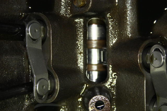

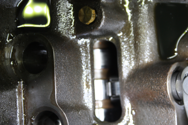

Hello
I took this piece out through the head window at the level of number 4
More to come

Old 06-04-2025 | 12:10 PM
Joined: Dec 2006
Posts: 61
From: Luxembourg Europe
Hello

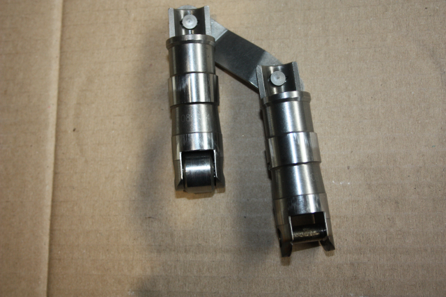

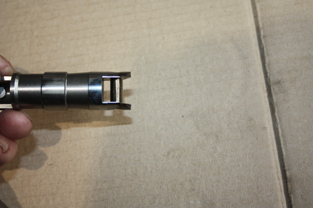

Today, I removed the intake manifold
The tappet roller from n° 2 is brocken in two !!!
Photos tomorrow
Best Regards
bajalux is offline

Hello
Number on the lift : 081714 ???
best regards
bajalux is offline
