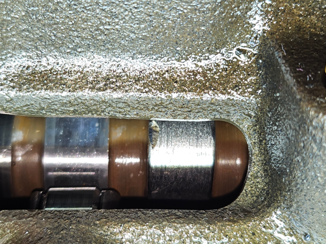

Hello
My camshaft is out !!
Bad news
bajalux is offline

Originally Posted by Tartilla
The lobe was chewed up?
The lifter was missing it’s wheel
not good when your wheel falls TFO.......Ron White............Id rebuild the engine not just replace the cam and lifters

you have metal thru out the whole motor.its a total tear down and clean.hope you didn't hurt the crank.

Didn't OP mention he had an oil analysis done with no issues reported??
That open heopenner rocker cover really did not have a lot of oil on it anywhere.
Are these stock Merc lifters? Or Johnson's?

Hello
The oil analys showed nothing alarming.
Regarding the oil on the rocker arms, it was a prolonged shutdown of several months,
and only the starter motor had been running for a few turns.
I'm thinking of installing a new Melling 10778 oil pump.
The lifters must have been cheap, with the part number engraved on them,
I couldn't identify anything !!
The news ones will be Johnson with the tie bar.
Thanks
