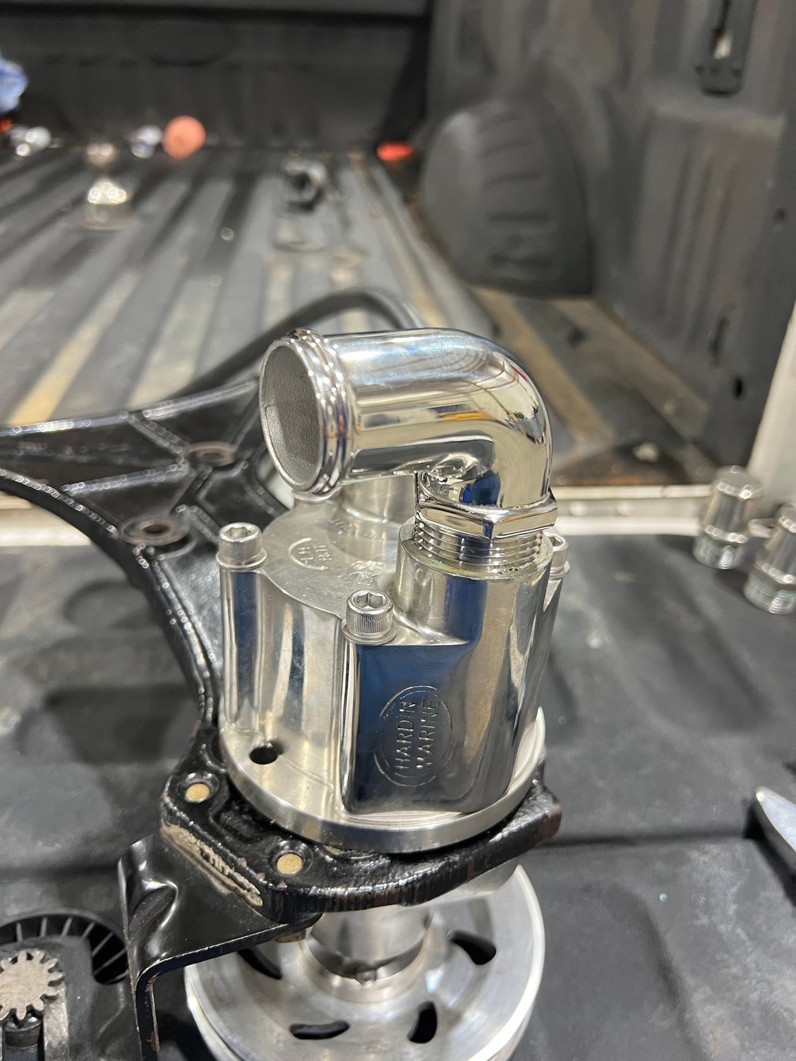

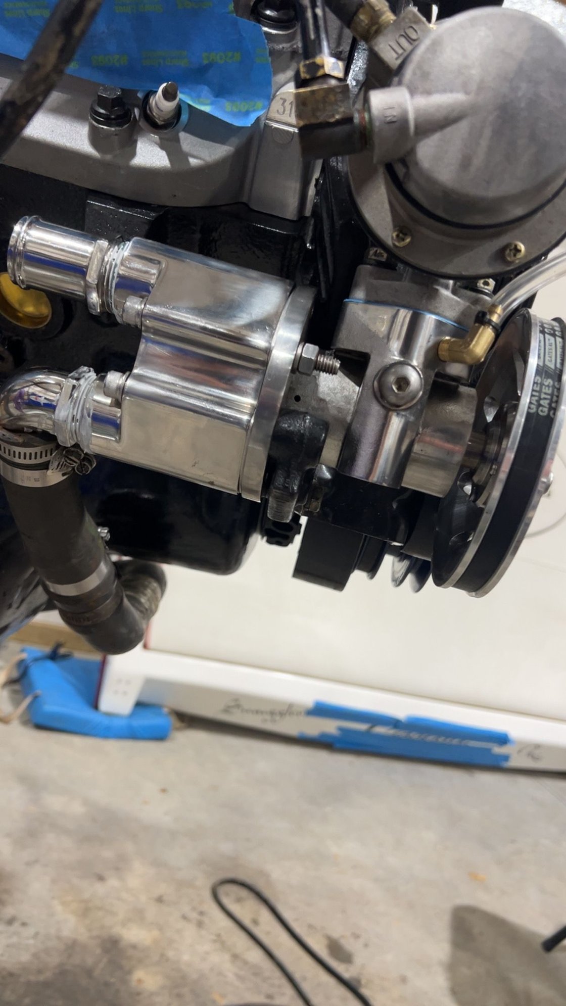

Found a 90° fitting from Hardin I believe will work fine for my application right now

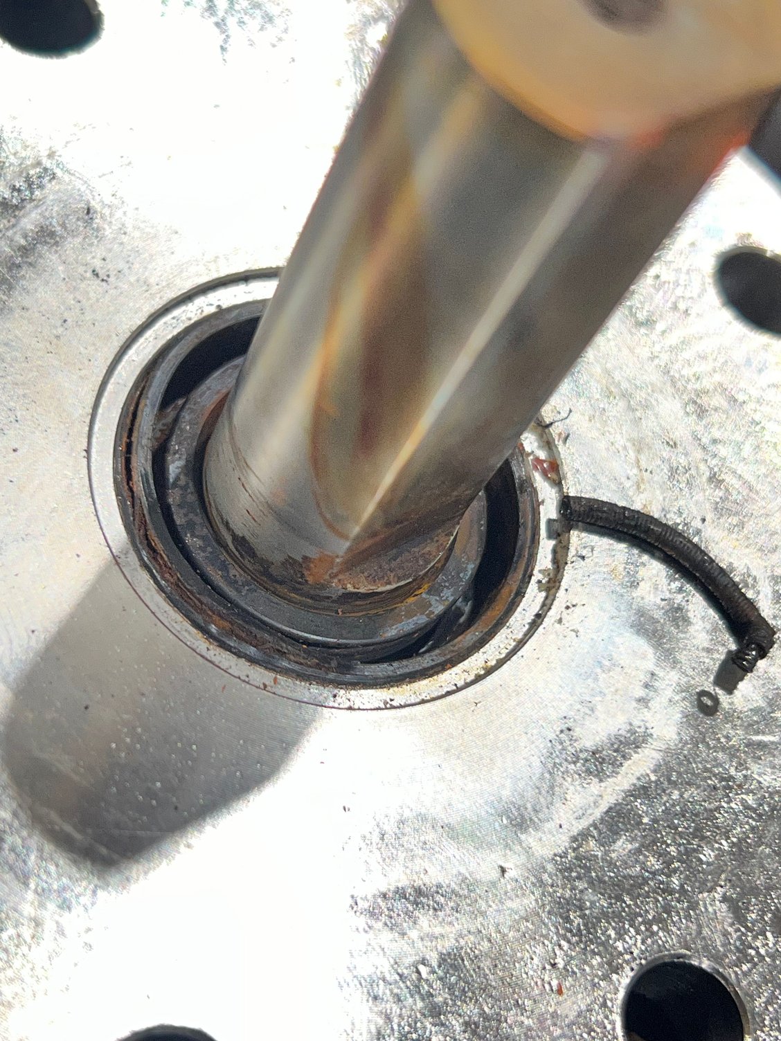

Somebody tell me about these seals and replacing them……..

Hardin sells a rebuild kit for these.

I have only found the internal seals from Hardin or Merc. The front seal is pretty common.

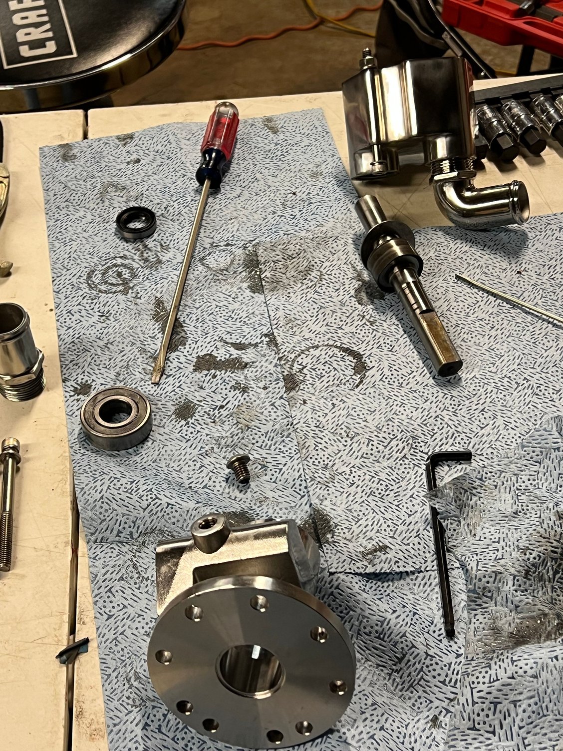

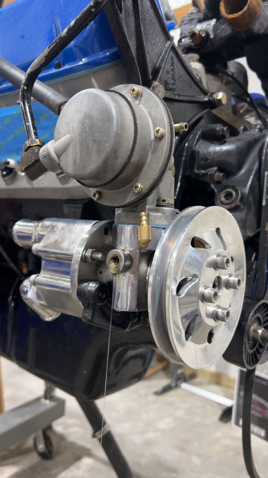

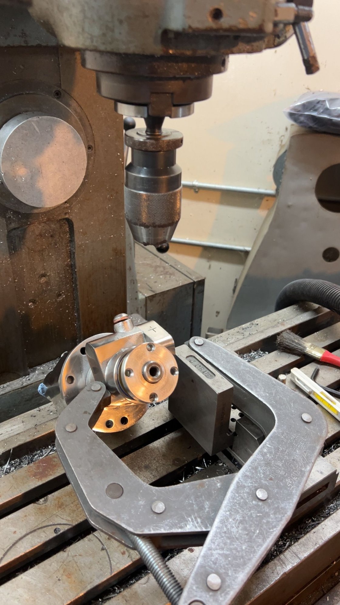

Default Full rebuild
Did an entire rebuild on these bearings , seals , plates you name it! Also drilled and tapped for the “ fix “
to vent the pressure issues that seem to be a normal cause of seals blowing out. Let’s see what happens now.
Water making that 90 is gtg...vs the std elbow fittings.
It will shunt flow a bit...but that's why we use larger diameter fittings/hose to begin with.
Nice find.

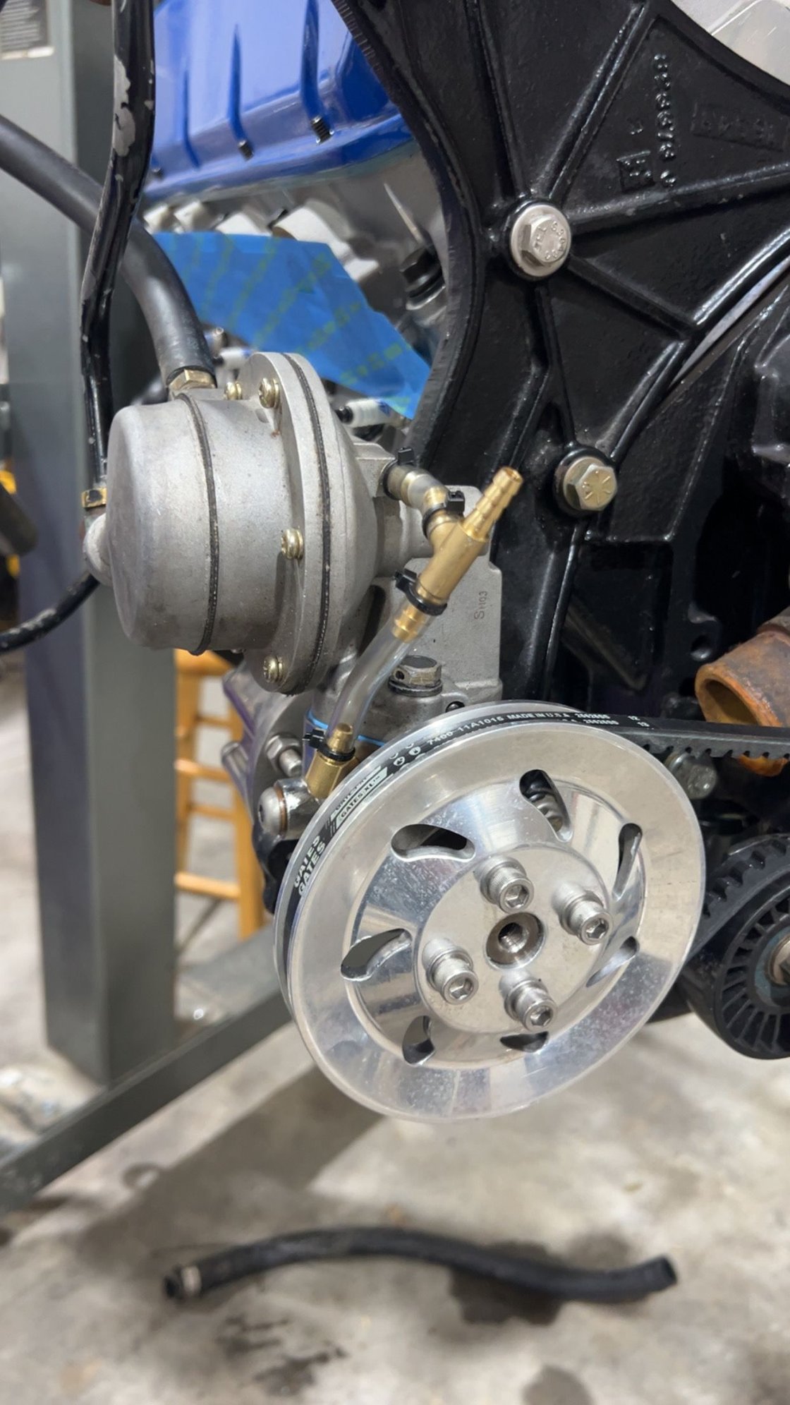

Default Full rebuilds
Fully rebuilt and added the vent system to them as well.
we will see what happens!

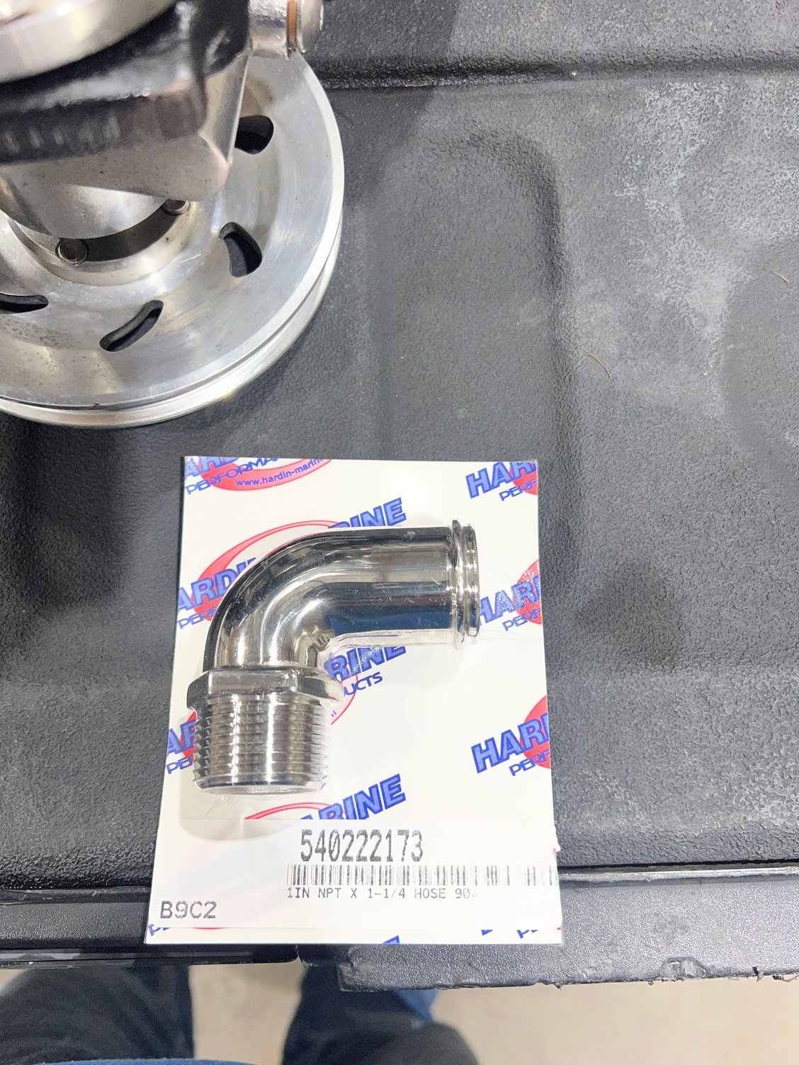

Nice find.
I was a little concerned with that as well. I ordered several different ones and found these to be the less “ restrictive “ so to speak that would still work for my plumbing.
that being said I compared them to the factory ones and these IMO seem better and not as sharp I guess I could say? I’ll post some pictures in comparison tomorrow!
