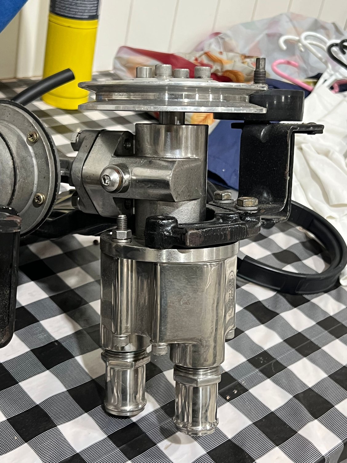

I picked these up this past weekend for my BBC ‘s I am curious to anyone’s thoughts on them? Seem to be quailty built. They have one season on them I picked both of them up for the price of a McDonald combo meal. Hoping I don’t mess up by removing the OEM bravo water pumps cause these sure seem like an upgrade ?
also on the backs of them they just say “ out “ on the water pump which one is in?

I use the standard Hardin pumps (not the ones with the integrated fuel pumps) and have had good luck with them.

I have 2 with one season on them. My new and 2 season old Merc fuel pump leaked and blew the seal on the Hardin pumps. I just rebuild the sea pumps last week. Those you have are a little older because they do not have the drain holes in the bottom to change the drive oil. The rotation on the housing should show 2 arrows, RH and LH. I don't know what you paid, but the pulleys and mandrels are 130.00 for the combo each from Hardin. I would like to find a couple of them for myself.

I do not have any personal experience with the Hardin sea pumps. I did do a lot of reading up on them when I found one for sale at a good price.
It seems some people have differing opinions. Might want to hang onto the OEM pumps just to be safe.
It's prob safe to assume most people have had good results with them.
One of the problems I had read about was the oil reservoir for the fuel pump lubrication builds up pressure and pushed oil past the front seal. Hardin does sell a kit that is supposed to bleed off excess pressure. https://www.hardin-marine.com/p-1044...equalizer.aspx
Another issue I had read about had to do with low or lower water pressure than the OEM pump. Someone was saying there were slight differences in the impeller cavity size that reduced output?
You can do a search on here by typing in Hardin sea pump in the "search" bar and you should see threads about them.

I've never run a Hardin Pump. Mine are the Gen VI sea pumps with no fuel pump. I did have one of mine rebuilt--twice. Blew out the inner seal both times. After the second rebuilt failure in less than a year, I bought a new OEM Merc one from Michigan Motorz. That was 5+ years ago and no issues since.
