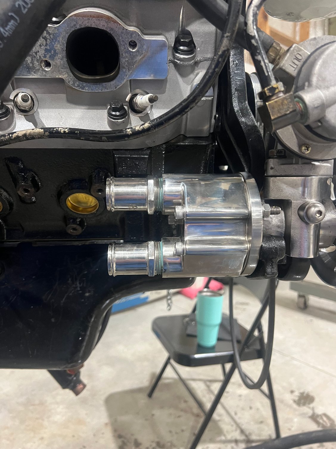

Will I hurt this pump if I put a two 90° fittings on the back of this instead of these inlet and outlets being vertical because my oil cooler is on the port side of the engine instead of the back and top of the bell housing of the engine….
I would bet that you would hurt flow. How much though im not sure. When I used to work automation I swapped out a bunch of 90 degree pneumatic fittings for straight ones and we gained significant cycle time on our machines just by doing that.
100% agree and makes sense! I need to find out how to plumb my oil cooler to the back of the Bellhousing’s.

Disregard needing two 90’s just need one.

How were your old pumps plumbed in? You had the stock Merc's right, they are straight???
no they are both plumbed 90° towards port side of engine off the back of the pump.
