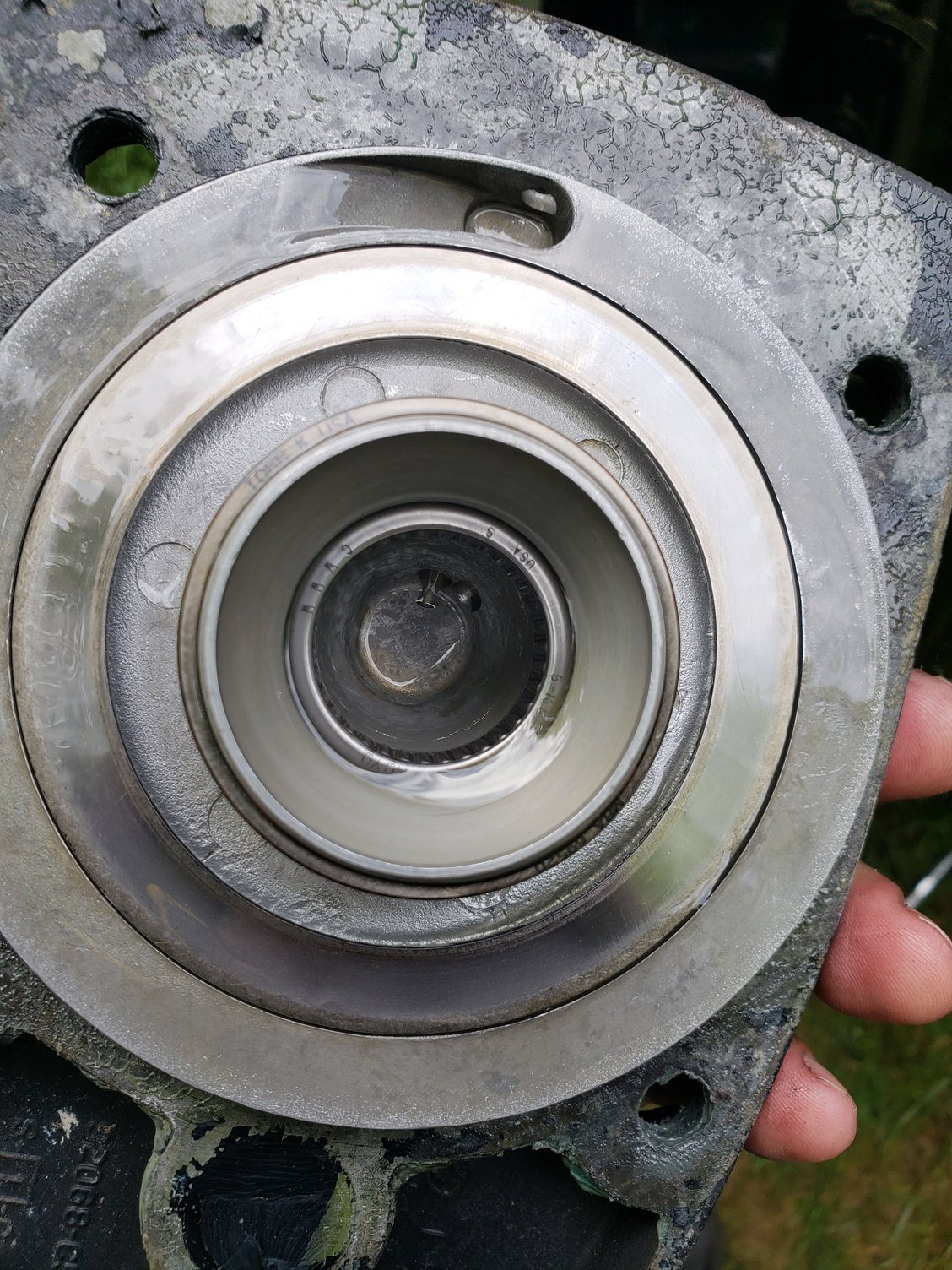

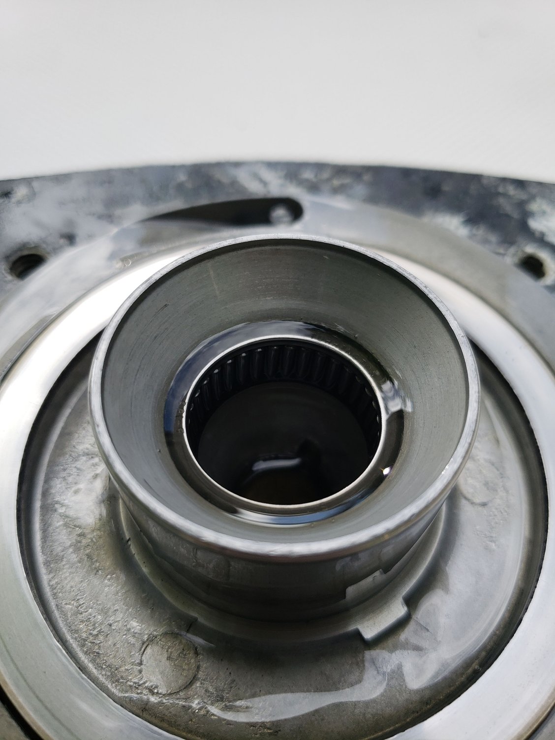

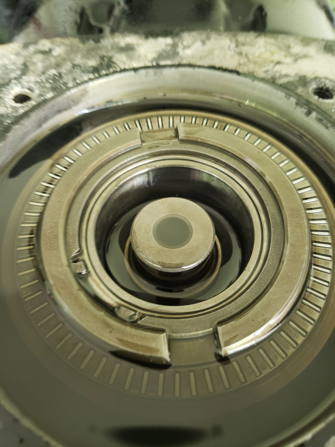

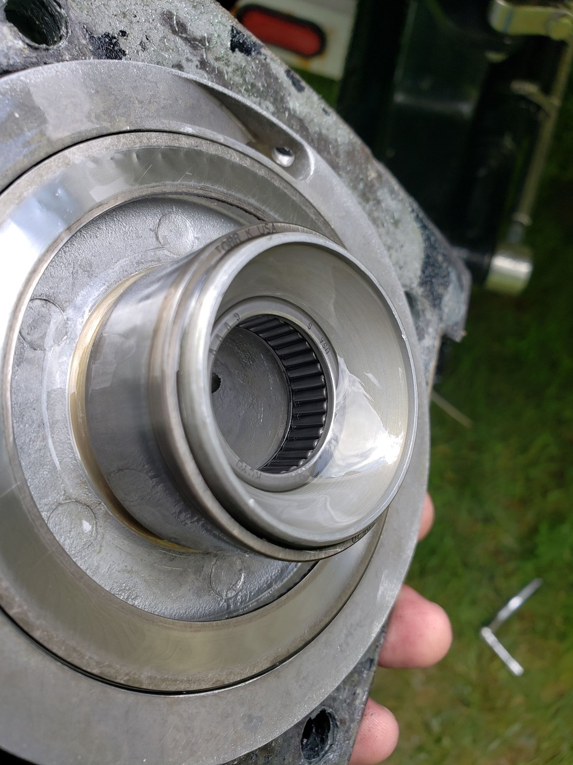

Another Update: Today I decided to swap top caps of the drives. I placed the flexible duct over my exhaust but it did not quiet it down much. When I removed the starboard drive cap (note this isn't the drive making the noise) i noticed that it was filled with oil and bottle was full. When i removed the top cap off the port drive (noisy drive) I noticed no oil well not as high as the other.and the bottle was full.
I opened the air bleed hole and that was covered with oil. So i tried to swap the caps and could not. They wouldn't fit. On the noisy drive cap it looks like there is an outer race around the bearing and on the other drive it looks like that race is inside the the gear bearing. I didn't want to mess with it so i put it back together any thoughts?

35fountain - You mentioned one cap has a race pressed on and one doesn't ?

race thats still in the gear set is cracked(about 12 oclock),that race is supposed to be pressed on to the top cap.

good eye

Looks like the race may have spun on the tower too after it cracked.... probably time for it to come apart at least to clean out the trash
