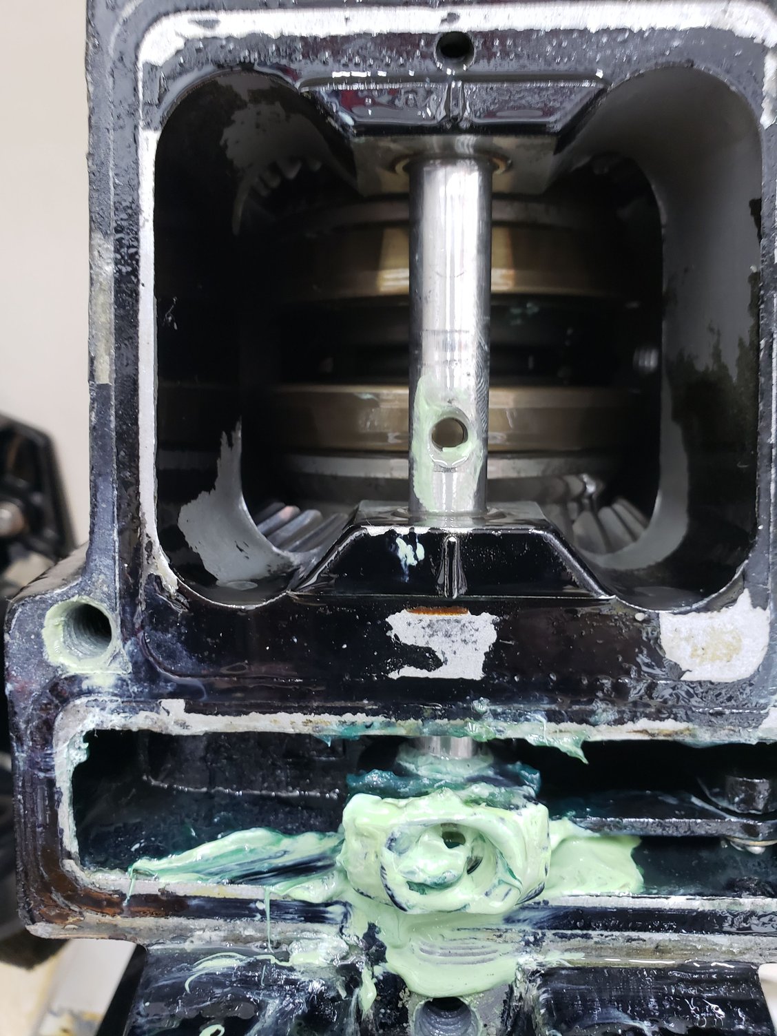

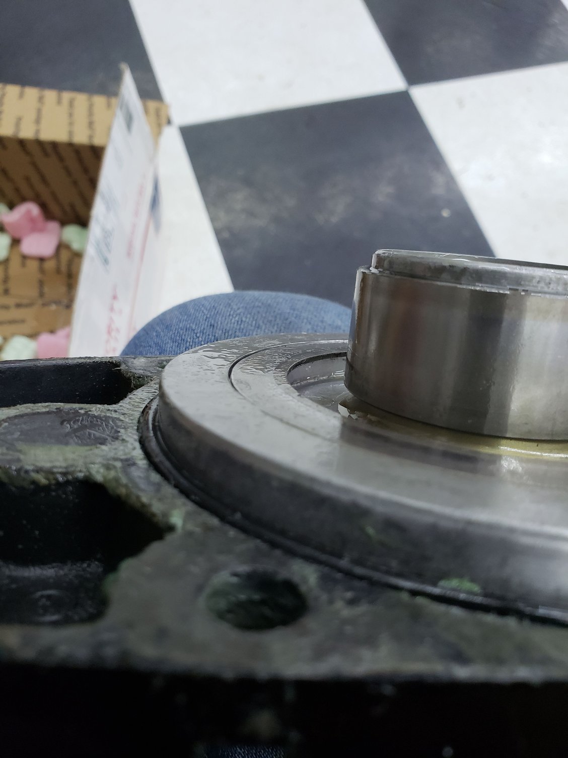

Today I took the noisy drive apart. I removed the shift fork for a test on the rattling noise. When i pulled the top cap off I noticed the race on the cap was different than the other drive. The race was wider and thinner and when it was on the cap it was lower than the casting. I was told that when you install these caps the race presses against another type of washer with needle bearings and it pushes down on the gear assembly setting also lash. So how could the race that was on the cap sitting below the casting push down on anything. I looked up these race's on Mercruiser parts and they make 3 different sizes. starting with .091, .094, .097 thicknesses. I got a new cap for the other drive that had the cracked tower race and the guy whom I bought it from sent me a bunch of extra stuff. He sent me the needle bearing washers and all these races brand new from Mercruiser No charge. So i started with the .091 race and placed it on the cap. Now it is slightly raised above the casting. Tomorrow will be the real test on startup. see pics + video

Originally Posted by JaayTeee
I’d still pull out the shift fork... you’re already half way there
took it out today...was easy but putting it back maybe an issue...please read my last post interesting what i found
thanks

Default Shims
FYI if your gears have ever been change to the newer style thick floored gears the 091,094,097 shim should now be .051,054 or .057.
Clustergear is offline

Is this a 1990's year model,,thin floor housing that has newer thick floor gears installed.

01_17.pdf This is the bulletin for the thick floor gear replacement, might measure the thickness of your thrust races, if you still have thin floor gears and you have the thin races for the new style gears, you might have a tad bit too much clearance
