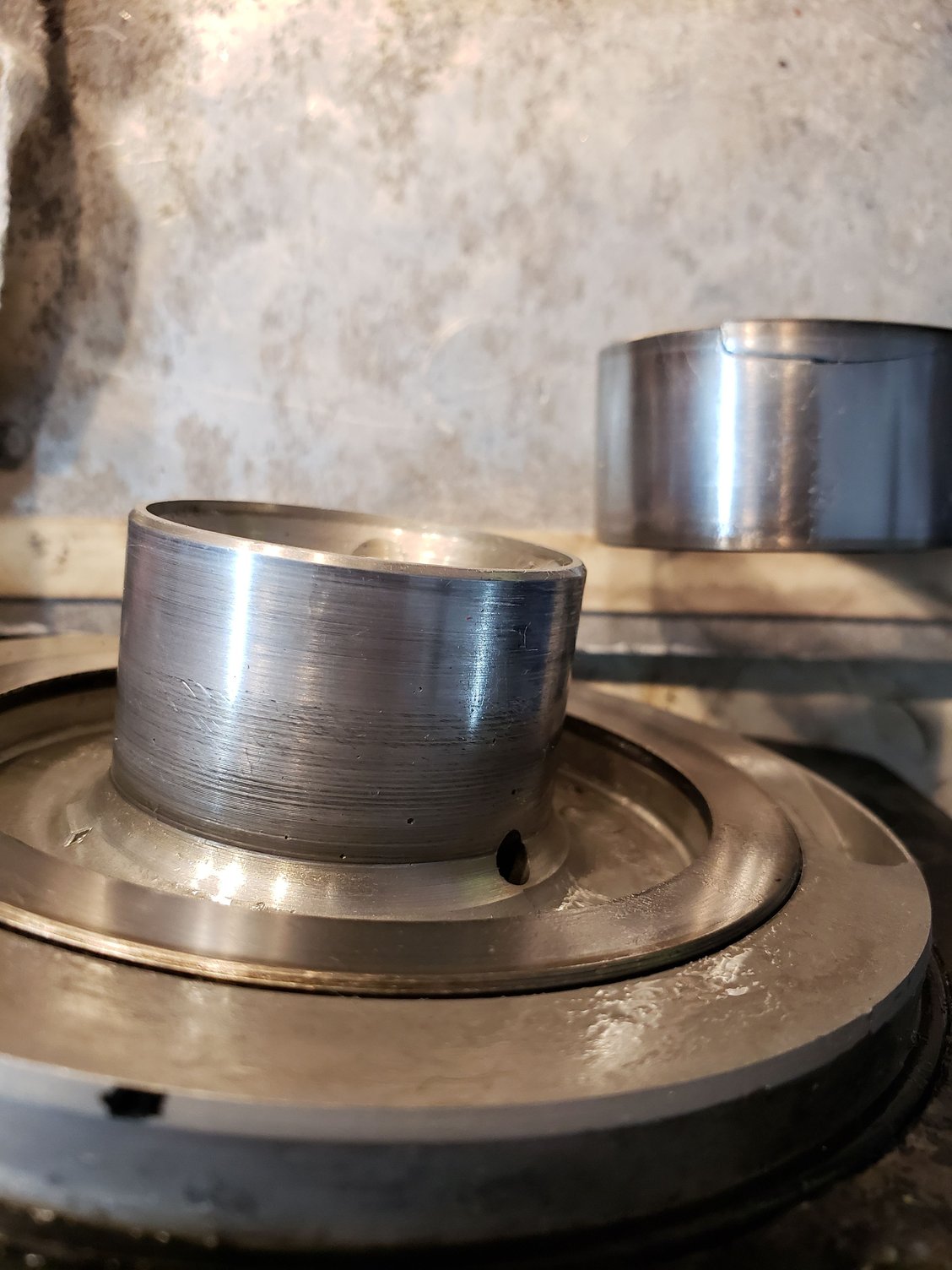

Originally Posted by sutphen 30
race thats still in the gear set is cracked(about 12 oclock),that race is supposed to be pressed on to the top cap.
that's the quiet drive no issues lol
I was looking for an answer on the noisy drive and now you found a problem with the quiet drive..lol Now i have 2 drive problems....lol Thanks for finding that

My mechanic said if the race is no longer pressed on the cap tower then that cap is NG. That means the race was spinning on the cap tower. Time for a new cap. Kind of glad i pulled the cap off at this point but the other drive still has an issue. Thinking of whats inside of the drive shaft assembly, top bottom gear, clutch, springs spacers .I can't imagine what can make that rattling noise that is so noticeable even with the loud exhaust. To me it sounds like something is hitting the inside of the housing. The shift fork hangs in the center of the clutch.and i can't picture the top or bottom gear rocking back and fourth at 750 rpm idle to cause that knock as shown in the video top cap off when the engine was off. BTW, A rep from mercury marine said this to me. Even thought the engine is idling it can cause the gears to rock back and fourth probably due to an engine adjustment or could be just your engine. I can't imagine that either. If the engine is turning lets say Left Hand, that means each gear is touching the interlocked gear it rides on, so at 750 rpm how in the world are you going to get a rocking, chatter from that? This drive shifts perfectly no slippage, Running at any rpm no unusual vibrations.I'm lost?

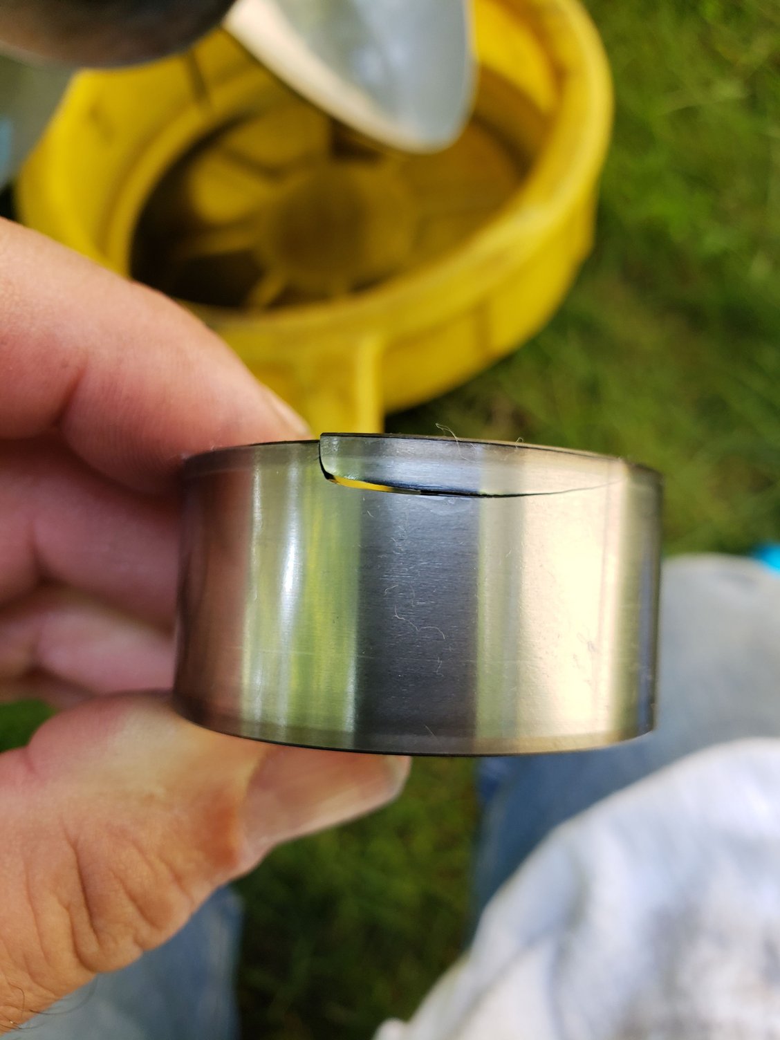

Default Not one crack but 2
Took the cap off the other no problem drive and removed the cracked race out of the top gear bearing. Bearing looks good and turns smoothly.. This is the drive that was filled with oil to the top, maybe that saved the bearing needles. The bearing in the cap does not feel right. It is rough turning and jumpy. Maybe it froze up at one point and caused the race to spin and crack
