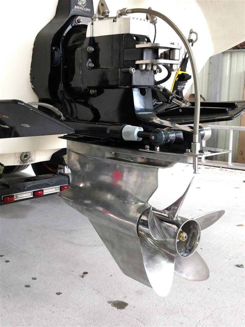

Single engine 30' with a #6
Boat always ran like it was on rails.
Personally worth the extra money, with the Hydraulic steering built in and so much drive in the water
it is a huge safety stand point for handling and as a bonus the internals your mechanically sound.
