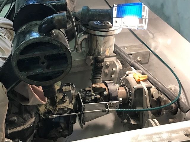

Where did you get your drive damper? (Between the trans and z drive?)

Default Isoflex IFC 4700 HT coupling
Mike
i went with Australia company as they had them on shelf as shipping from globe who offer similar product was not much different
4 bolt marine gearbox couplings and drive savers | IsoFlex
ICF 4700 HT
i went with stiffer material as wanted the highest torque rating
price was us$300

IFC 4700 coupling is rated at 1000 Nm
IFC 4700 HT coupling is rated at 2100 Nm

here is lightly different angle showing setup looking back at the ASD6
