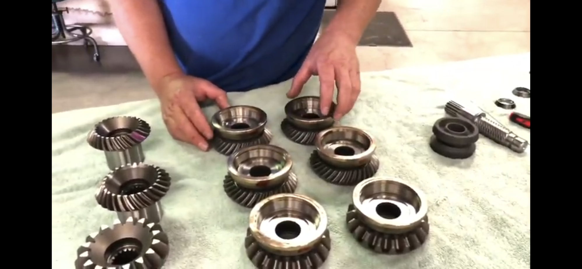

When rebuilding our drives I went back and forth on helical vs. xr...granted we don’t have huge power, because we are running a 11,000 lb top gun I went for the xr’s.
I dont have much much experience with the helical but from research they work better in small power small boat applications. It’s a matter of what you think you can get away with.
When I saw this picture, it re confirmed my decision.

Originally Posted by thirdchildhood
Hmmm. Interesting ... I blew two Bravo ones on my Donzi but the XR is on it's 5th season (or so). I would be hesitant to let someone swap in helical cut gears.
Like Articat said it sort of depends. On the OP that has 565HP I doubt he will break a gear tooth off but its not just the gear.
On yours did you have a standard Bravo drive? I ask because those don't have steel towers and are 1" shaft. If that upper flexes a little the non steel tower breaks and you are done. Case flex is a reason a lot of drives fail,,,,,, and why a IMCO SC has XR internals but a stronger case.
When you take a XR drive and put XZ gears in you get the strong steel tower, larger shaft etc but go back to the gear that doesn't pit.
George has said he was going to make XR gears, that would help a lot. If he ever gets around to it.
Or SCX for bigger power.
