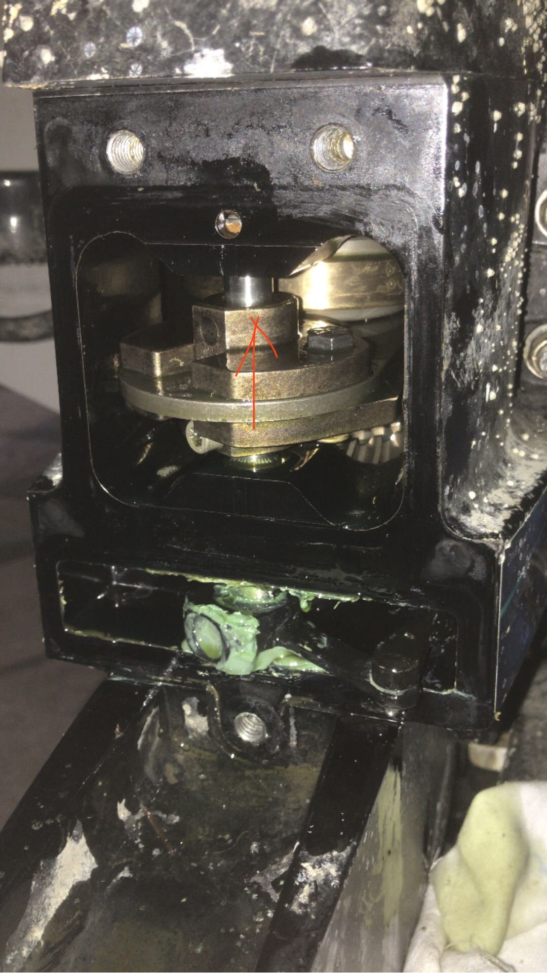

When I look into where the gears are, they look like the first (X) gears. Helical gears

From what I can see, these look like helical ( not XR)
The only way I’ve been able to get them apart is pressing the clutch shaft down through the gear, then check then the clutch shaft collar where it contacts the bottom side of the gear for galling, check the contact area of the gear too , if it’s galled up it will stick again
Yes it looks like helical gears when I look into where the gears are from the back cap.
Like griff said, I dont know exactly if it was a X or XR.
But now Ive been verified it is a X?
The previous owner said it can be an bravo diesel drive too. Bravo One x diesel?
Do I have to take the top cap off to press the clutch shaft down?
From what I see only from the back cap the gears looks fine. But I can take the top cap off to see more

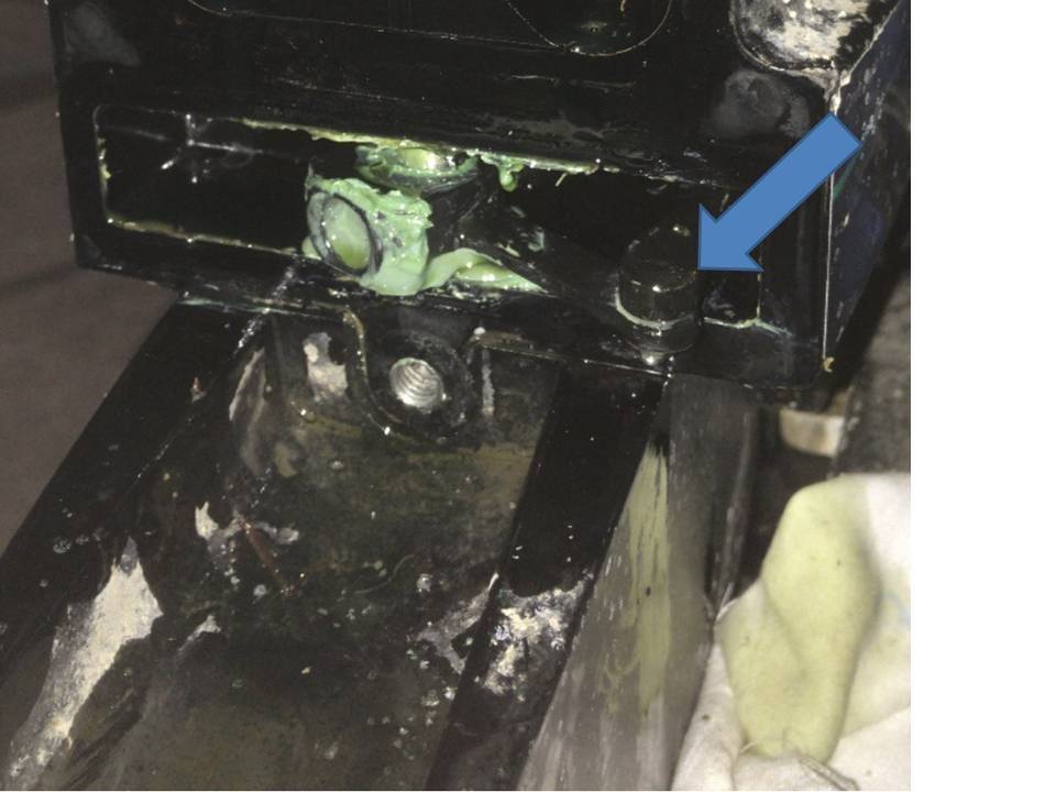

See if I can see any damage there on the shift cable, and if I disconnect at the pin if its possible to push it to neutral.
But probably not..
It looks like this when in forward (like I post before), and I can push it a little bit on the shift cable but not the whole way to neutral.. it feels like something is stopping it to move more. But maybe its in the gears/clutch and not the shift cable...
