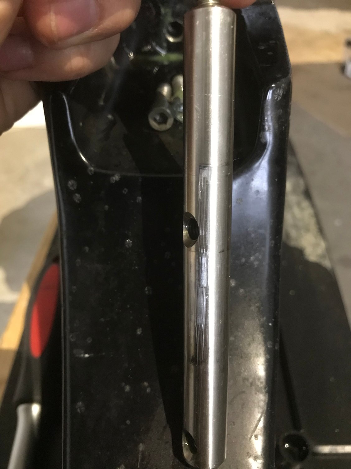

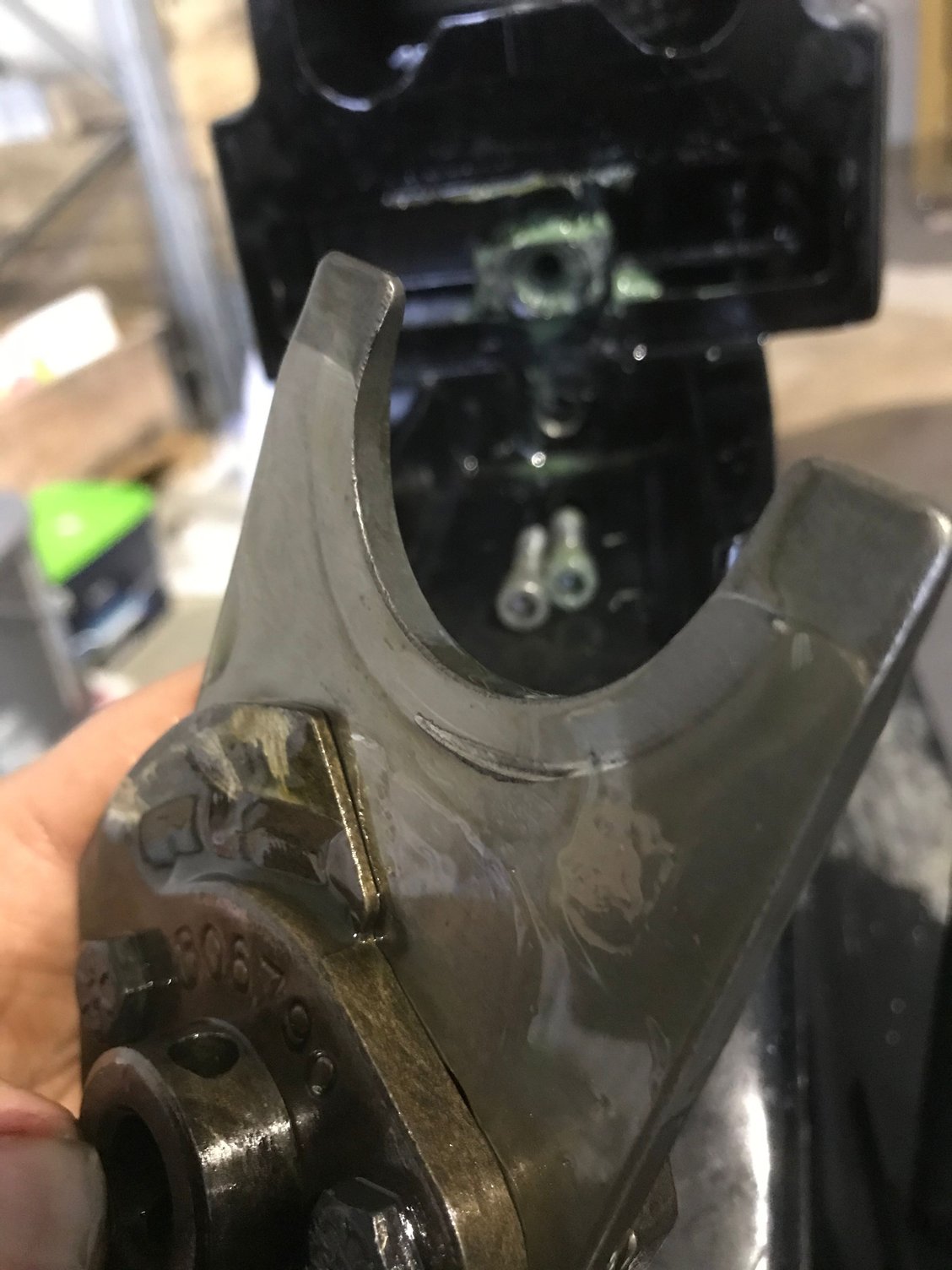

Do you think it is time to replace the shift yoke and the shifter shaft..?
It is a little notch on both the yoke and shaft.

The score is not an issue, it happened when pulling it out because it was in a bind. The places where the shaft needs to be smooth for sealing is ok, and the rest is screwed together.
As for the rest, take it apart, clean and reassemble to see if it goes back like it should
AllDodge is offline
Nice to hear!
I hope the clutch cone just got stuck by the high rpm and didnt damaged anything...
I have ordered the special tool to take the drive shaft pinion nut away, so im just waiting right now..
