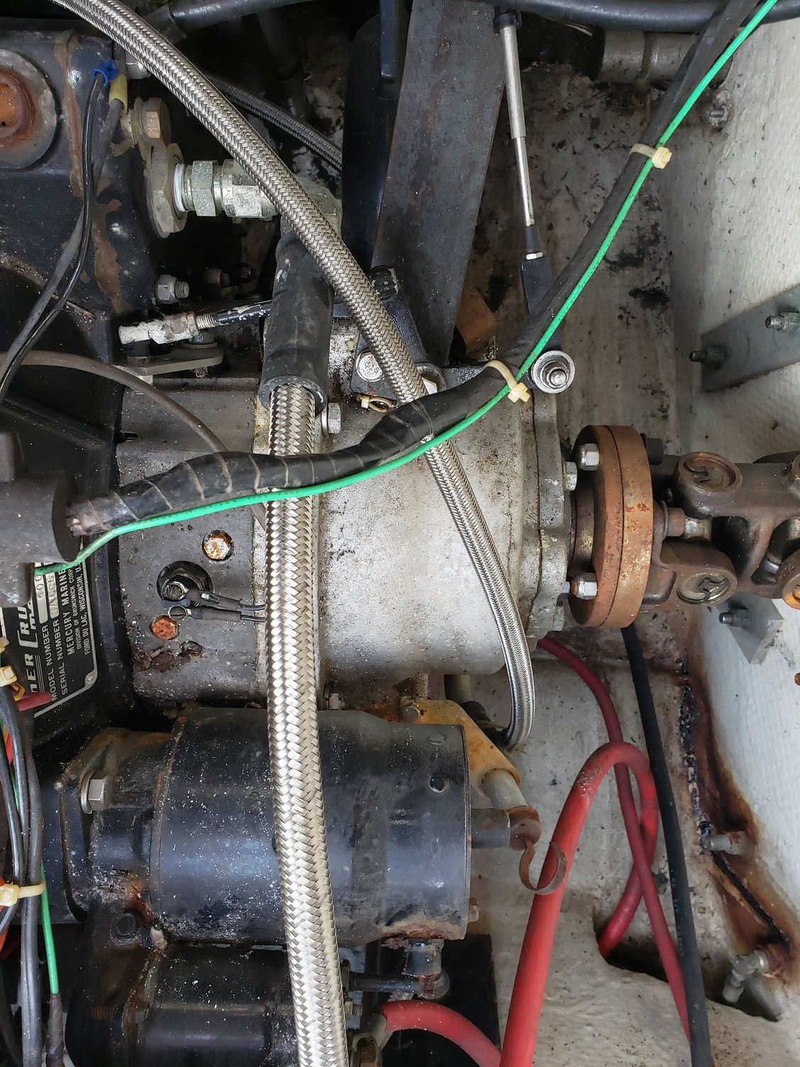

Anyone recognize the transmissions?
Tartilla is offline
Old 06-08-2023 | 11:34 PM
Joined: Aug 2019
Posts: 1,224
Likes: 415
From: BC
Looks like the TRS Merc 400 bellhousing was kept, and another trans bolted on.

Turns out trannys are Doug Nash Marine.
DNE2 is their Logo.
Hydrosmooth is their Marine trans nomenclature.
This one is Serial 0006. I don't think many were made.
Huber had some parts for these, if anyone is looking back into the OSO archives in the future.

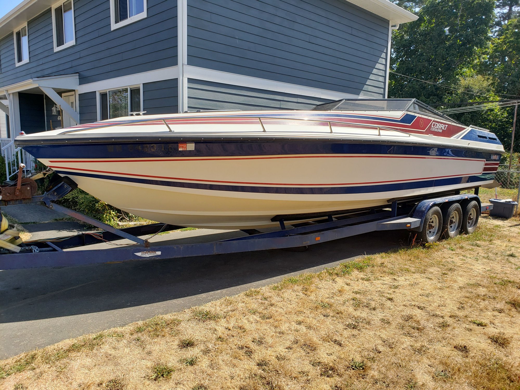

Cleaned her up. I may need to fabricate an Arneson ball socket nut wrench.
