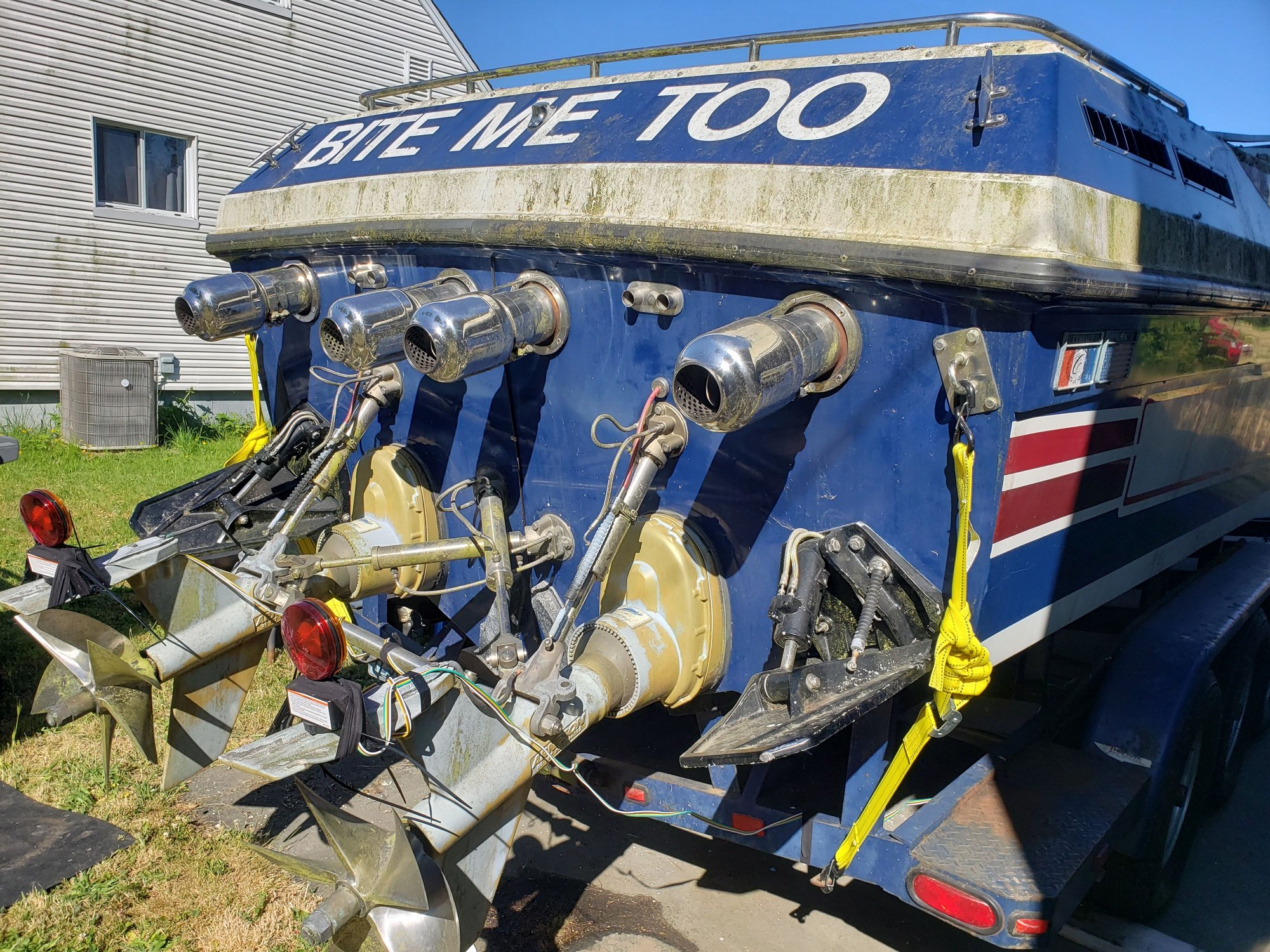

These pics are how it was when I received it. Some light soap and water has cleaned up 95%.
​​​​​Th
Fresh Water boat. The Arnesons and BBCs never saw salt.
Raw water cooled.
Will need to find a place for heat exchangers.
I need to figure that put before I pull anything out.

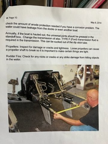

Old 06-08-2023 | 07:16 AM
Joined: Jan 2010
Posts: 617
Likes: 144
From: syracuse ny
bigger picture
green lightning is offline

The maintenance instructions are for the conversion kits and I don't know how your engines are attached to the drives

Do your steering rams touch , they almost look like from the picture like they are to long .
